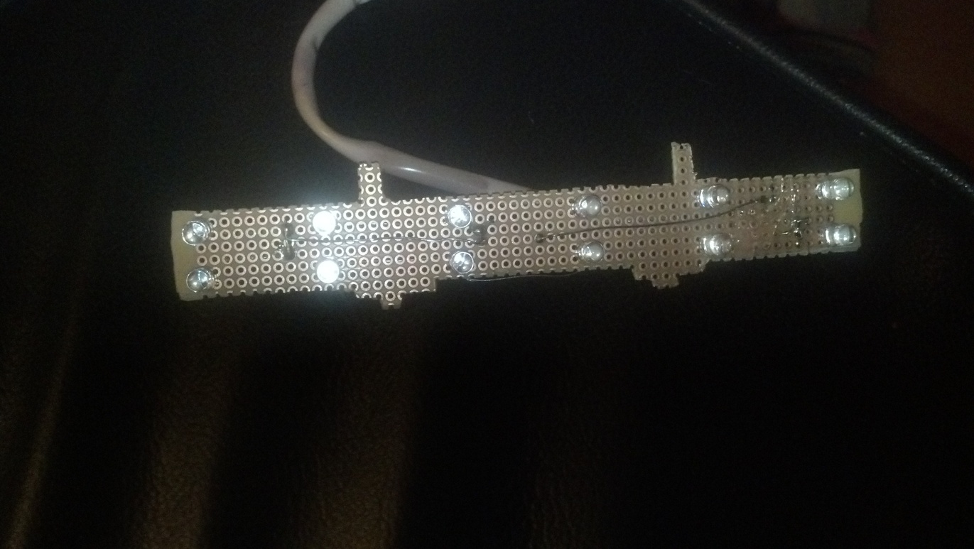

I got my car in November, and after just a couple weeks, I noticed the 3rd brake light was no longer coming on. It had some loose solder so I redid the joints, and everything was good for about a week. It went out again, this time the two center LEDs had burnt out, so I bridged the gap with a spare diode I had lying around.
I probably could have kept it like that for quite a while, but I wanted to have a better, more permanent fix. So I set out to make my own. Took most of the day today, but I did it. Replaced it with 12x 5mm LEDs, same wavelength as stock. Here are some pictures of the final product. If anyone wants something like this, I could be convinced to make more and sell them.
Attached Thumbnails High Mount or 3rd Brake Light-ledfront.jpg   High Mount or 3rd Brake Light-ledrear.jpg   High Mount or 3rd Brake Light-ledrear2.jpg

My middle two LEDs are out also. Can you explain where I need to bridge the gaps so that the outer two at least work? Thanks!
Old Feb 4, 2013 | 03:03 AM
Ben35's Avatar
Joined: Nov 2012
Posts: 45
Well if the middle two are out, you just need to bridge across that gap. Although if you don't drop the voltage as you do so, it will burn out the other 4 in short order.
The system is not very well designed.
Old Feb 4, 2013 | 09:56 AM
V35Guy's Avatar
Joined: Nov 2012
Posts: 12
I see..I have a pack of assorted diode's..any particular one you recommend? Thanks again!
Old Feb 5, 2013 | 06:34 AM
Ben35's Avatar
Joined: Nov 2012
Posts: 45
Test it on 12V before you solder it in for sure, but I'd go with the largest one you have if it illuminates. It's likely to be a temporary fix anyway.

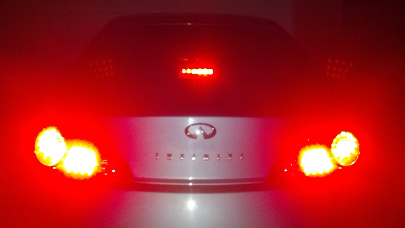

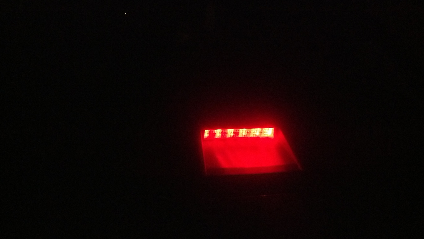

Ok, it took a while, but I made a new one, and I'm ready to make as many as people want.
6 LEDs instead of 12, 12 seemed like overkill
Ignore the extra wires, they're just there for testing.
I used the little board from the stock setup, changed the resistance to suit the new LEDs and removed the second resistor which was silly to have in the first place. I didn't replace the diode as it works fine, but I can replace it if requested.
Fits into the stock unit
It's a little skewed due to the testing wires, but a final one wouldn't have that problem
Night time
I can make these now in any configuration, just send me a PM or something. 6 LEDs, 12, more? Any color (although it might be illegal to drive with a color besides red) I could have it fade out when you let go of the brake, pretty much anything you'd want.
