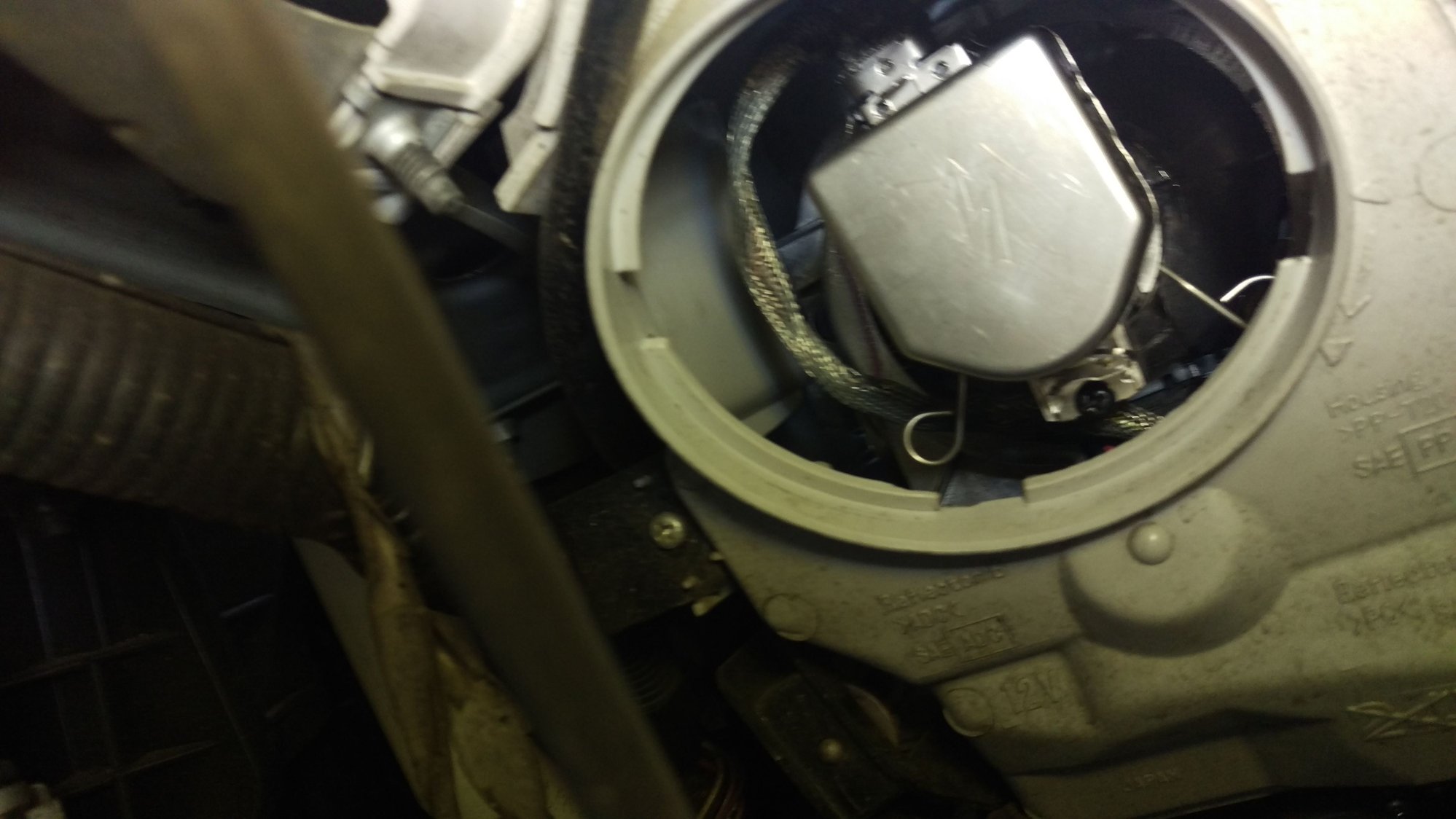

After the stock light bulbs were giving me trouble I replaced them with a set from theretrofitsource.com I purchased the morimoto hb 55k
https://www.theretrofitsource.com/co...l#.VyFDPUTn_qA
Jack up the car,you can either remove the wheel or leave it,i didnt need to remove it.
Pop the screws on the inside around the fender.dont
mind yhe zip ties on mine lol
Pull back the plastic fender insert or whatever its called so you can get into headlight
Turn the cap and remove it

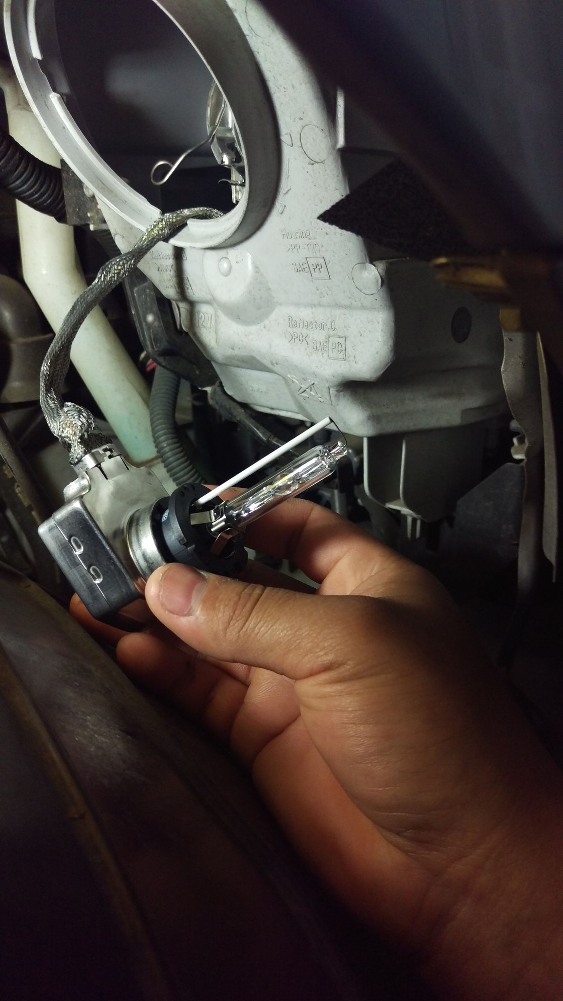

Now this is the tricky part,you have to squeeze thoes 2 clips and pull out (on the drivers side i had to remove the tire so i could remove the bulb)
Now carefully clean the new bulbs with the wipes provided
Carefully put the new bulb in and insert it back into the headlight put everything back and enjoy your new lights
