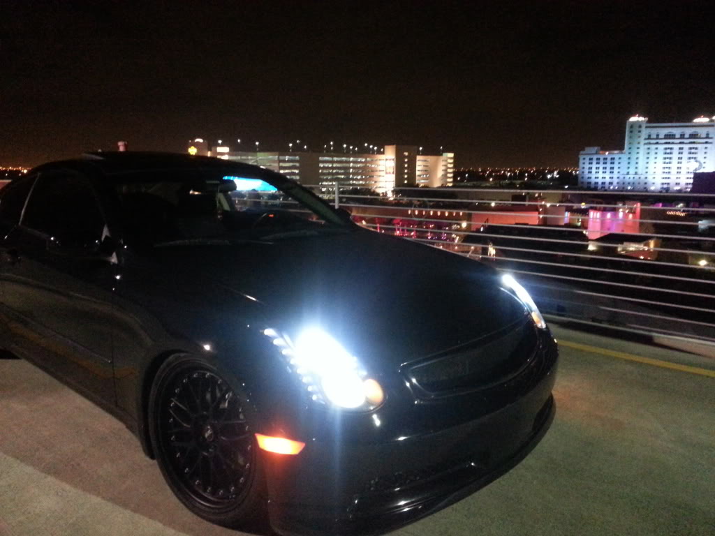

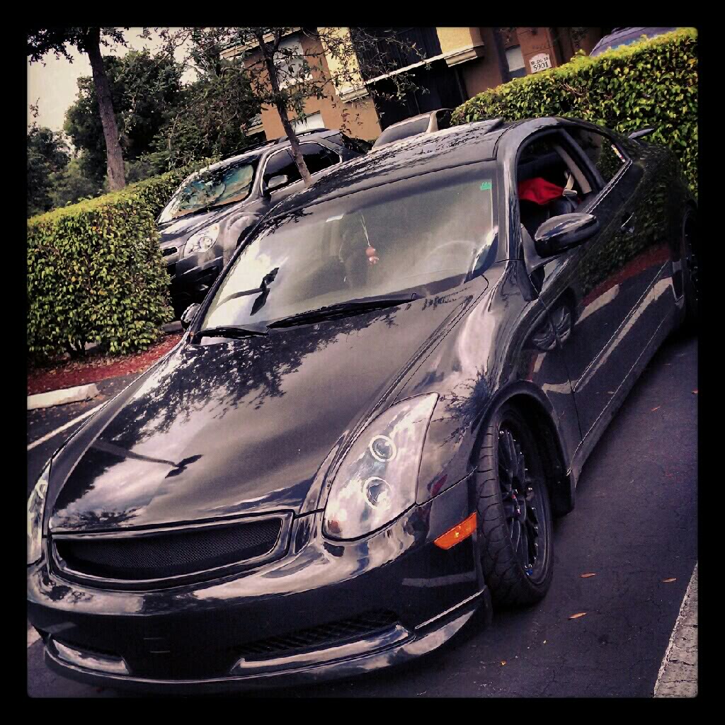

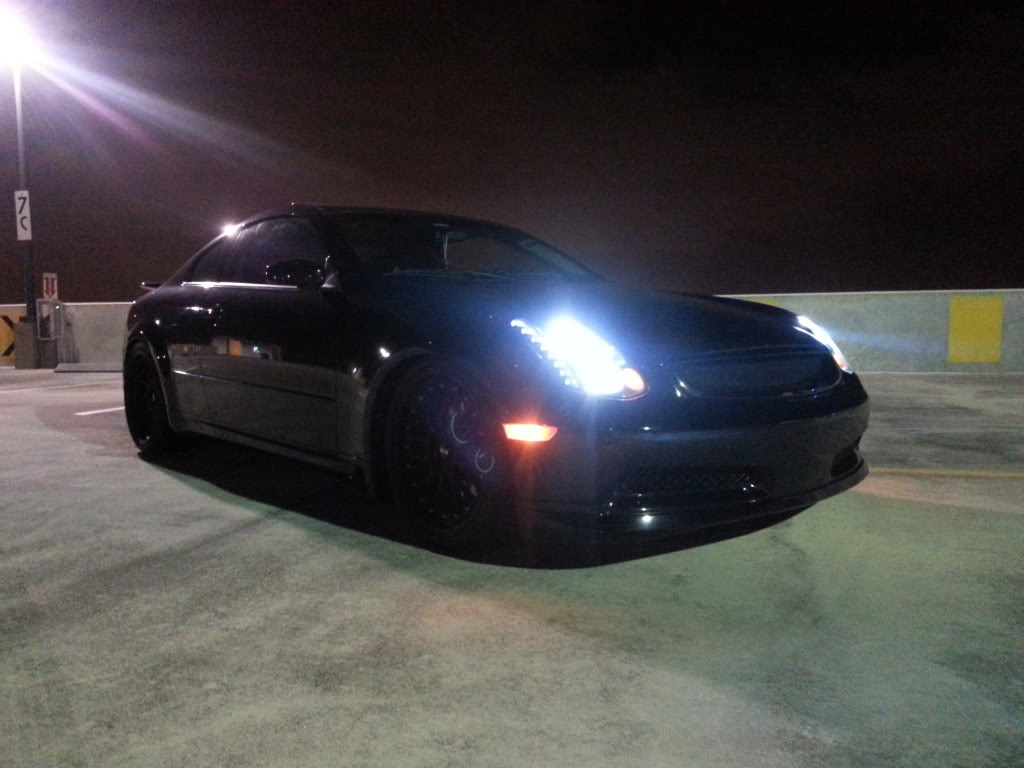

What size are those rims?
And could you tell me a price? Can't seem to find it on their site lol
Your car looks amazing...
Great job, and unique.
5% tint or limo?

urgg.. remove the door moldings PLEASE!

I actually like your set up. Usually not a fan of those headlights but they work with the sporty style you seem to be pushing for. Door molds aren't that bad to me, I think you just need some spacers for an all around flush look and maybe a degree of negative camber for a nice stanced look... Since you're already lowered it would pull everything together.

nice ride man, loving the theme all you need now are some wheel spacers.

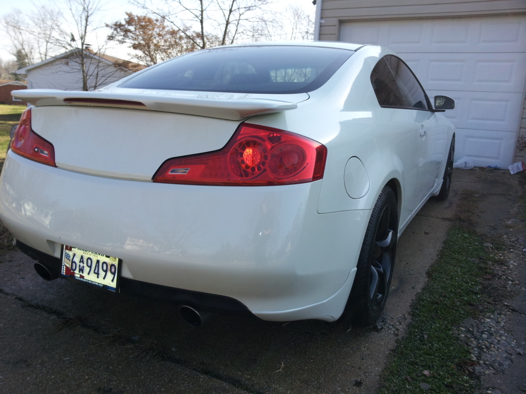

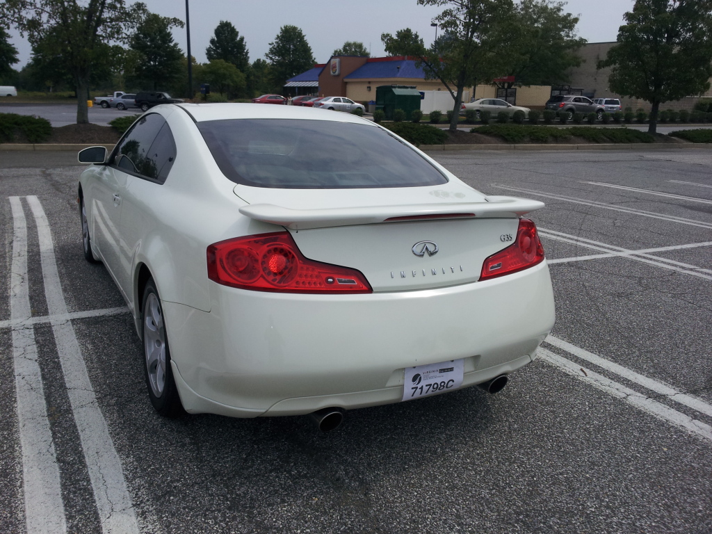

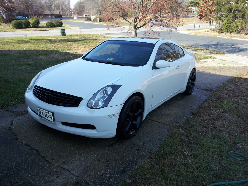

I measure from the furthest point out at the top of your tires.... Meaning from that point to the outside of the fender. Measure in millimeters because that's the way they are sold. Make sure you get our Hub size 66.1 and that they are HUBCENTRIC. With a slight lip to rest the inside of your wheels on. I'm running 25mm all around myself, wheels were regularly 30+ in front and 33+ in the rear. So now I'm at 5+F and 8+R. Most members would not recommend going beyond 25mm spacers as it tends to increase excess wear on the wheel bearings.
Without spacers

With spacers

Granted not the same wheels... But you get the point.

reason for removing the spoiler brake light is cosmetic or.......?

Its there.

Xxr 521 20x10.5 1100 with rims, tires and suspension
Thanks again

Thanks.. spacers are on the list but I am waiting for my fender flares before I purchase them. I want the rears to stick out just a lil.

Black wheels look better,but def spacers in front.
