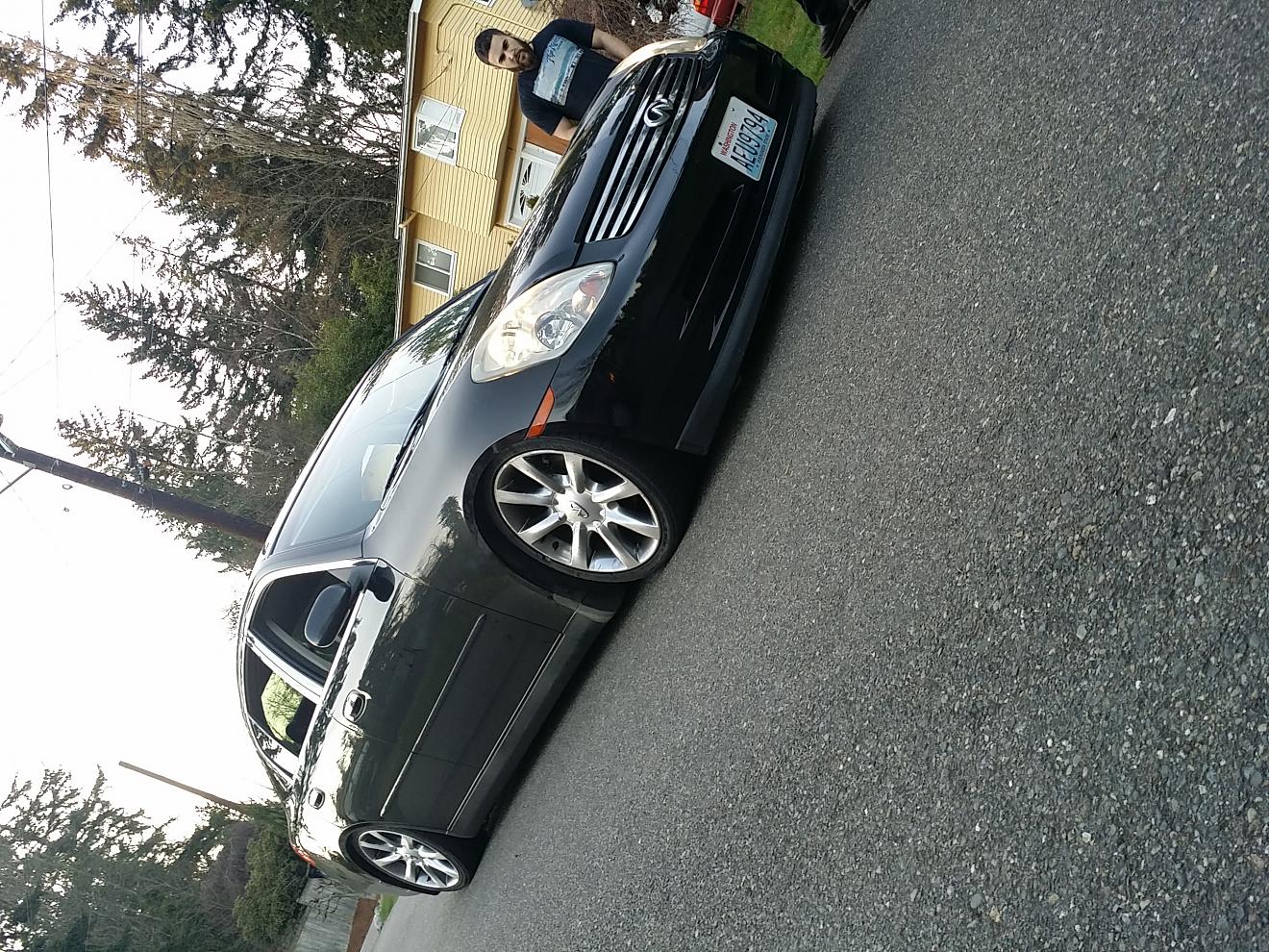

Slammed my sedan today!!... But ofcourse, working on cars never goes smoothly. So my rear bottom bolt on the struts are seized!!! Any idea how to get it off?? Plus I'm gonna raise this bad girl up because she's scraping cement eeeverrywherreee... Any suggestions how to keep slammed but still be a functional daily? I'm running Function and Form Type 2's Btw. And no ignorant comments, keep it to yourself!!! Good day y'all!
