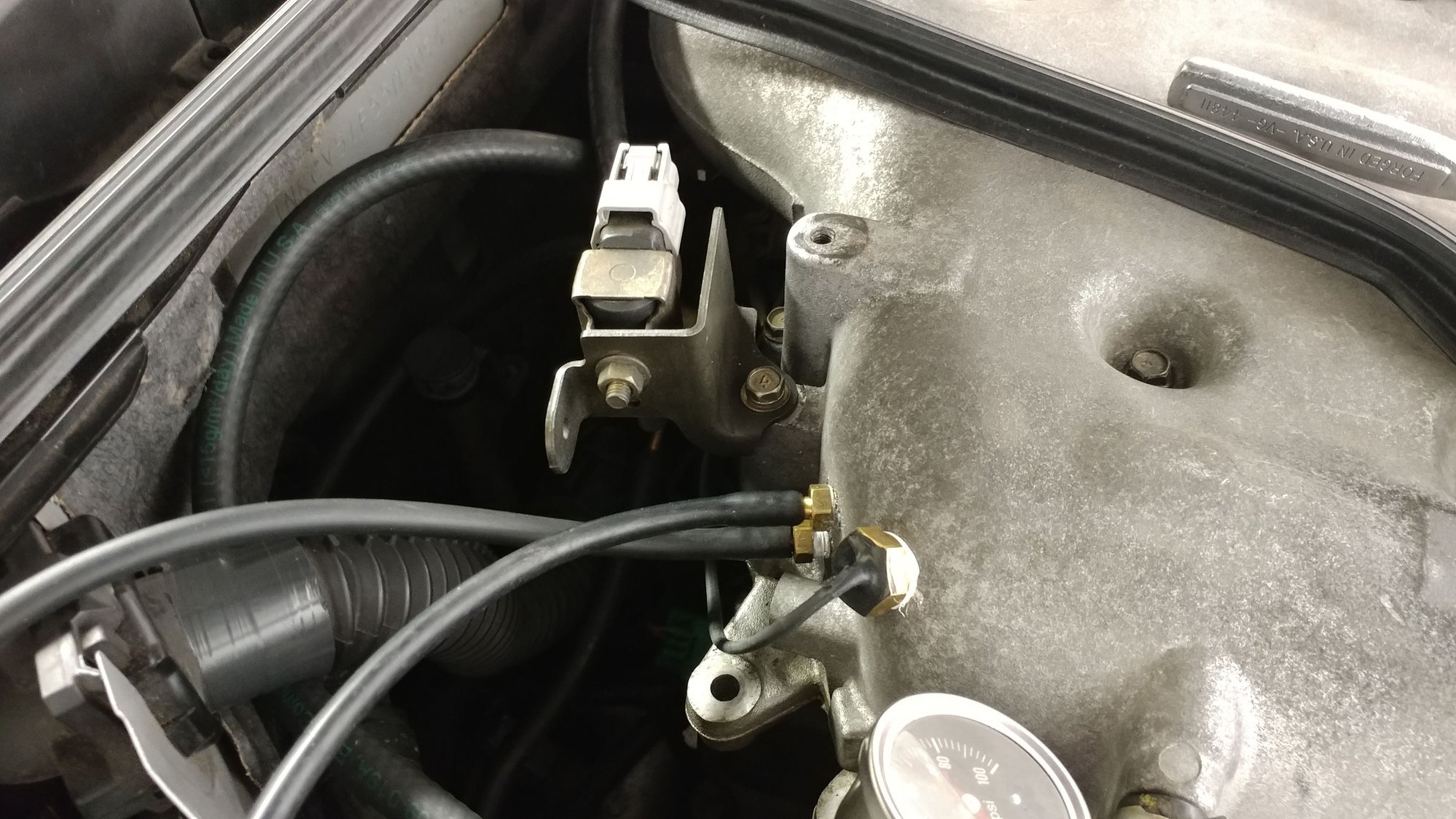

Got the water / meth system back in the car tonight. It is a AEM progressive setup that I set to turn on at 2-3psi and full pressure by 9psi. I strapped the pump right next to the windshield washer tank, tapped the washer tank bottom for a 1/8 npt quick fitting, then installed the jet right behind the MAF sensor. Pretty cool this way because the low washer fluid light tells me to fill up! I'm using straight distilled water right now. I'll add meth to it later on.
Did a second gear pull tonight with the water injection running all the way to 6600 RPM: Started at 133f degrees and was 115f degrees at the end of the pull. (crusing around temps were at 128-136f). Before the water injection I did a 3rd gear pull and saw a 29f degree rise. They say every 10 degrees you lower your intake temp adds 1% HP.
I still need to move the air filter to the trunk passenger corner, box it in and pull outside air through the bottom flap. It is sucking hot trunk air right now and would probably help me even more.
Another note: I was running the stock 08' G35x the same night fully heat soaked the intake temps coasting were 111f compared to the 05' turbo car running 136f. The HR might run a little cooler than the DE because of the plastic intake but I know sucking hot trunk air is also part of the temp difference.

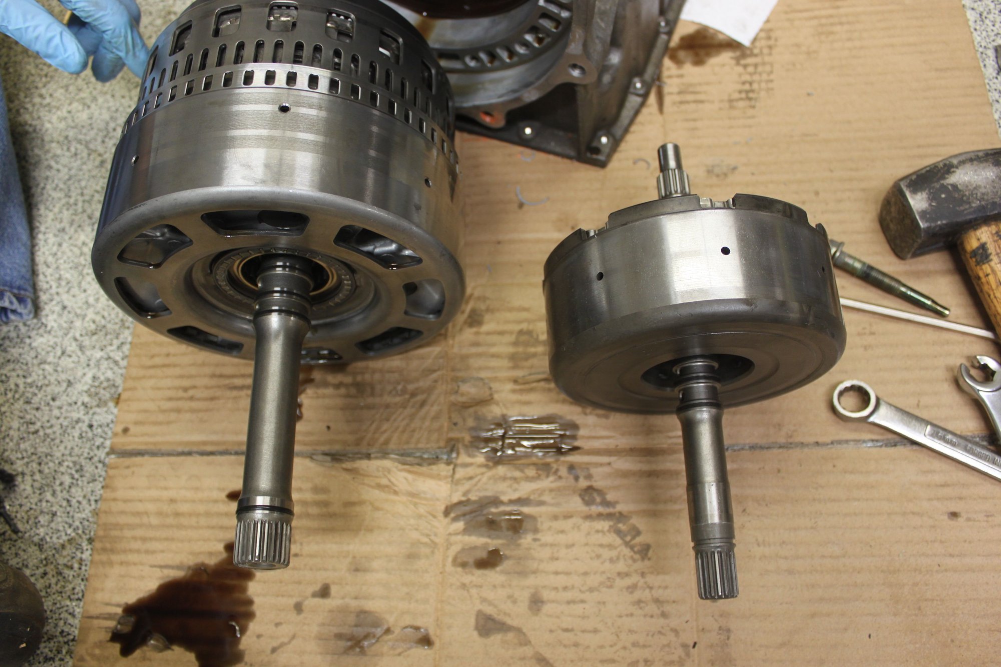

Aluminum High Drum
High Drum steels hot spots and blackened clutches
RE5R05A vs RE4F03B "G35 vs G20"
That last picture is the brake drum from my G20 that we have put 300whp to the ground. The G35 drum next to it is wayyyy bigger haha

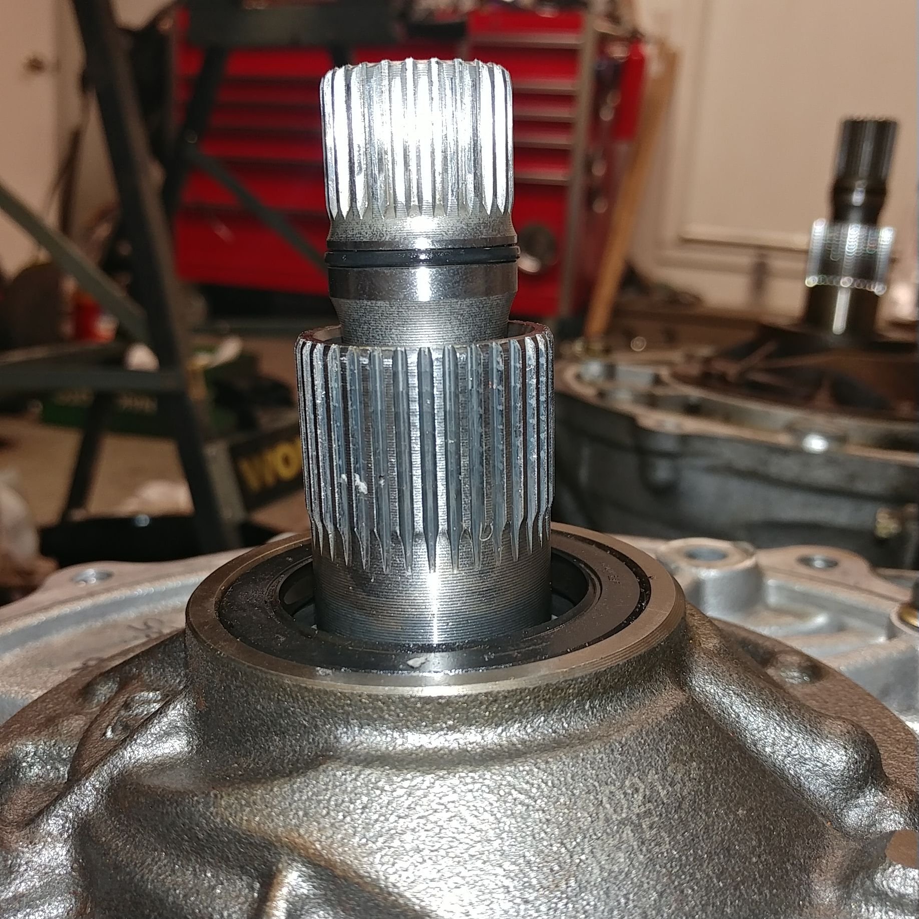

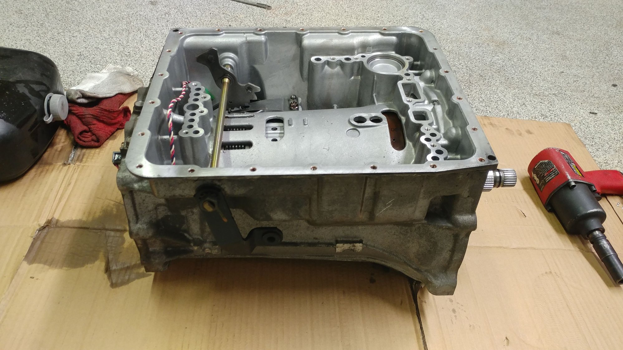

The track was rained out Friday so we spent the weekend wrenching. Went to my local pick n pull since it was 1/2 off weekend and got some great stuff. I managed to spot a set of rebuilt SE-R brembo 4 pot calipers and got them for $7.50 each haha. I also got a 07' armada RE5R05A 4wd tranny for $90 to dissect and see what parts are different V8 VS V6 passenger car transmissions.
So the V8 stuff in the RE5 transmissions not only has taller baskets for more frictions and steels, the planetary gear set has 5 gears vs the 4 gears thats in the V6 transmissions and it's a machined steel housing vs cast aluminum. That explains the torque capacity ratings between them. Another thing is the bearings and journals through the V8 transmissions are larger. Even though they use the exact same outer case and front pump there are differences that keep the V8 transmission from just dropping into our cars. The Input shaft is longer, the pump stationary shaft is longer and the 4wd models would need a AWD long basket output shaft to convert to AWD length. I'm still debating on modifying my V6 passenger car transmission baskets for 20% more frictions or just getting deeper into the V8 transmission parts to build a bulletproof one... I'm just not sure where and what the limit is going to be on the stock V6 stuff and really don't want the transmission being my weak link. I'm pretty sure I can get a V8 transmission converted with the correct input and output shafts and it wouldn't cost too much more to get it built. It's just going to take a lot more time and parts research to get it right.
The mess we made this weekend
V8 vs V6 bearings
Input drum V8 is the taller one
5 gear steel planetary vs cast aluminum 4 gear
V6 input
V8 input
V8 torque converter is larger, probably has more lockup material and also has deeper spline engagement.
