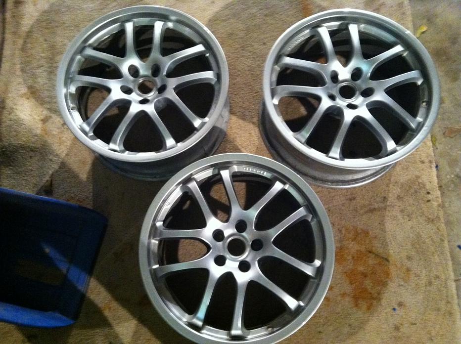

Just finished touching up the repaired wheels. Since my wife will be driving this primarily, I didn't want to put too much emotional effort in them to just get my heart broken when they come home all scratched up.

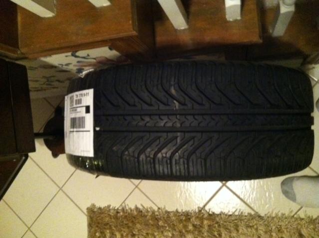

My Tire arrived today and My lower control arm arrrived yesterday.
