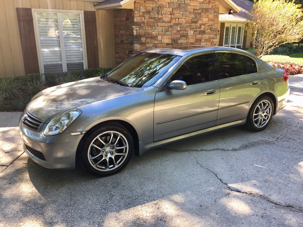

Well, I brought the G35 home this Saturday. Got an good deal and the car is in real great shape for the age/miles. Found out the PO installed the 350Z Y pipe, gives it a nice tone.
So this coming weekend I got a list of fluids to change. I did hear a groan from the rear end. I even coasted with the engine off on a side road to confirm that the rear wheel bearings need replacing. I already have seen some great write-ups on here on the process and will get that done.

lol those aren't Rays, they're the sedan 18's. Even though they look a lot alike the Rays are forged and the sedan wheels are not.

Not sure if the car had a crash like accident but its very clean. Got a good deal and knew what I was getting.
Yesterday I got the maintenance done. Spark plugs, belts, oil and some fun time replacing both rear bearings. That was not too bad but both were shot. The car has the 350z Y pipe and the Z tube. I did rip a rubber boot connecting the pvc into the airbox, but found a Dorman boot at advance. While one side is smaller, with some swearing, got it on and back in. Changed the rear diff fluid also. Next is to clean the headlights and do a fluid change on the tranny.
