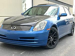

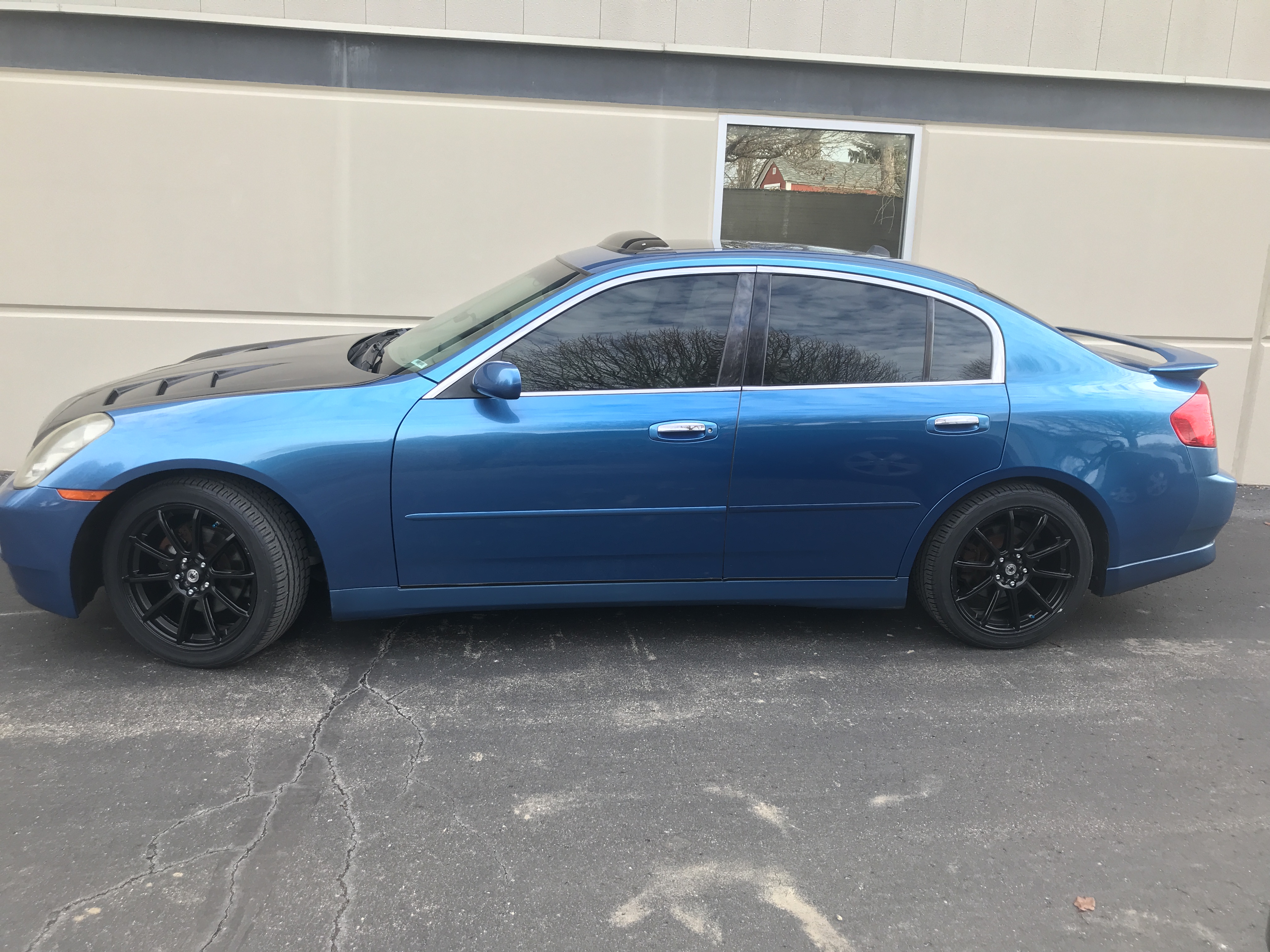

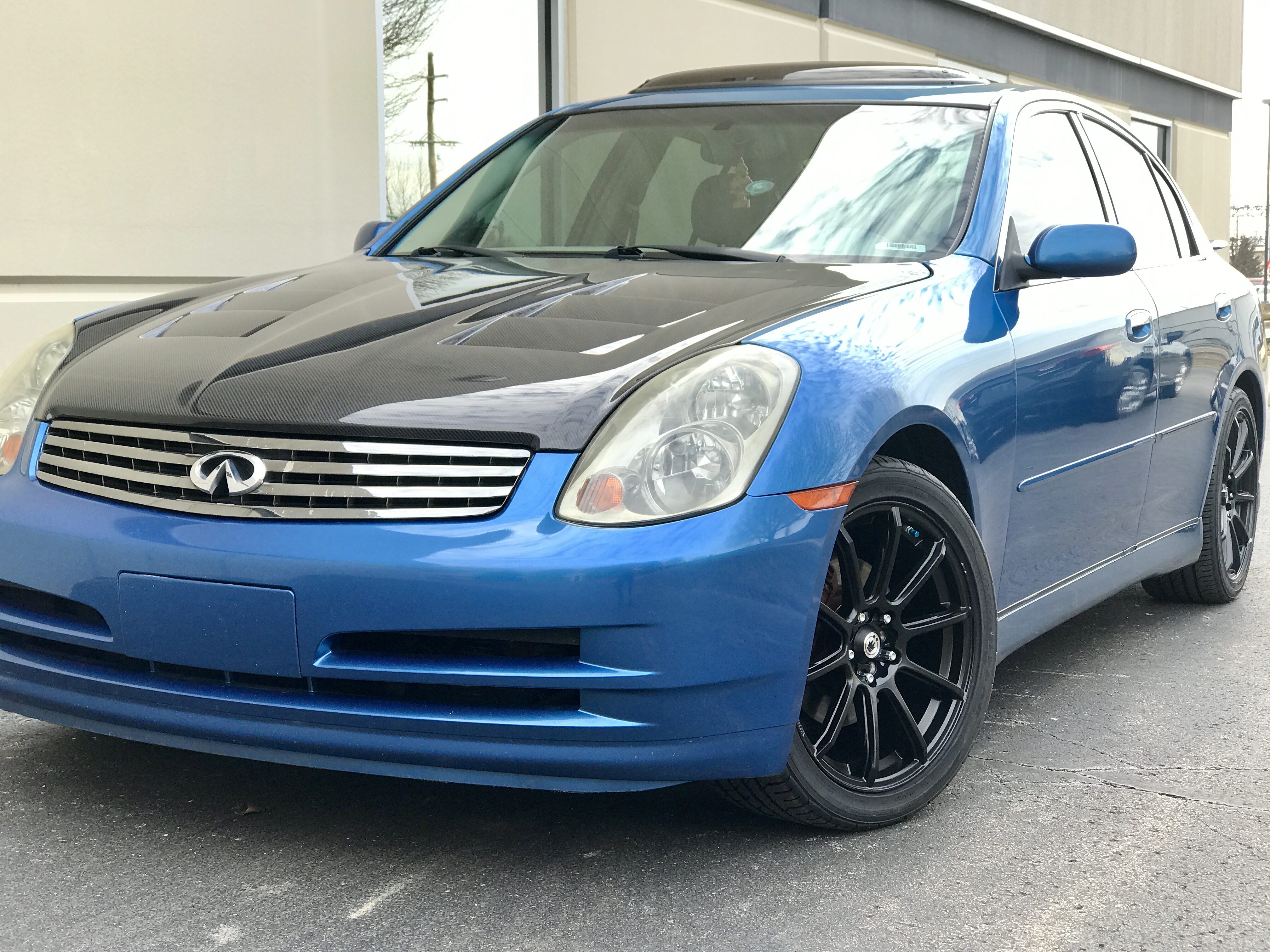

Hey friends,
It’s great to be here on the forum. Here’s my 2004 G35 Sedan Sport.
No engine mods (wanting this car to last forever).
Car was a demo vehicle for the Infiniti dealership so it has every option possible (rear spoiler, factory body kit, DVD/Nav, etc)
Seibon Carbon Fiber hood
Konig Controls with Goodyear Eagle F1’s (245/40/18)
Wanting to get the car lowered. Any advice you guys have on the look of the car or things I could do to it? Wanting to lower it an inch and have been hearing about revised 350z suspension/springs doing the trick. Any advice?Thanks,Bigwig
