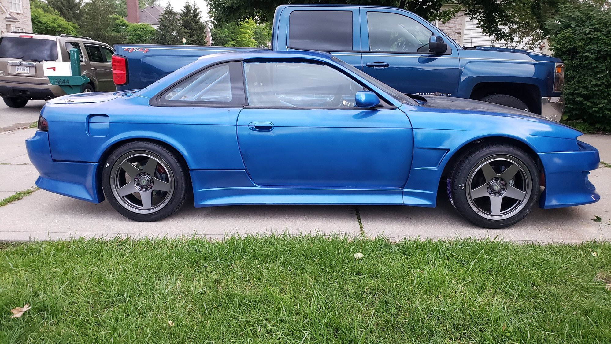

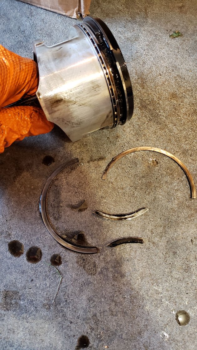

I picked up my first G35 in June 2019 after blowing up the engine in my S14 drift car. Too much boost and oiling issues.

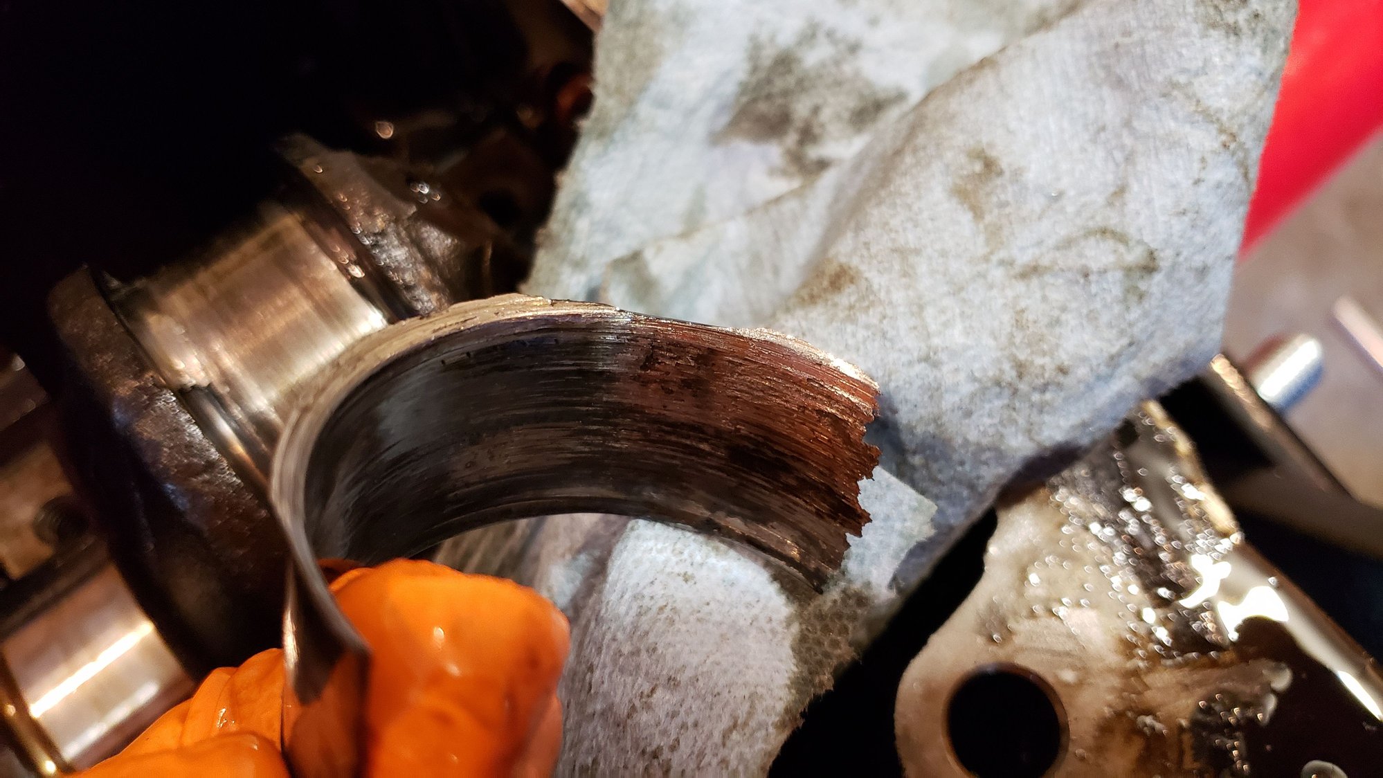

Finally put together, only to blow the engine on my first run.
Toast bearing
bye bye ring lands.

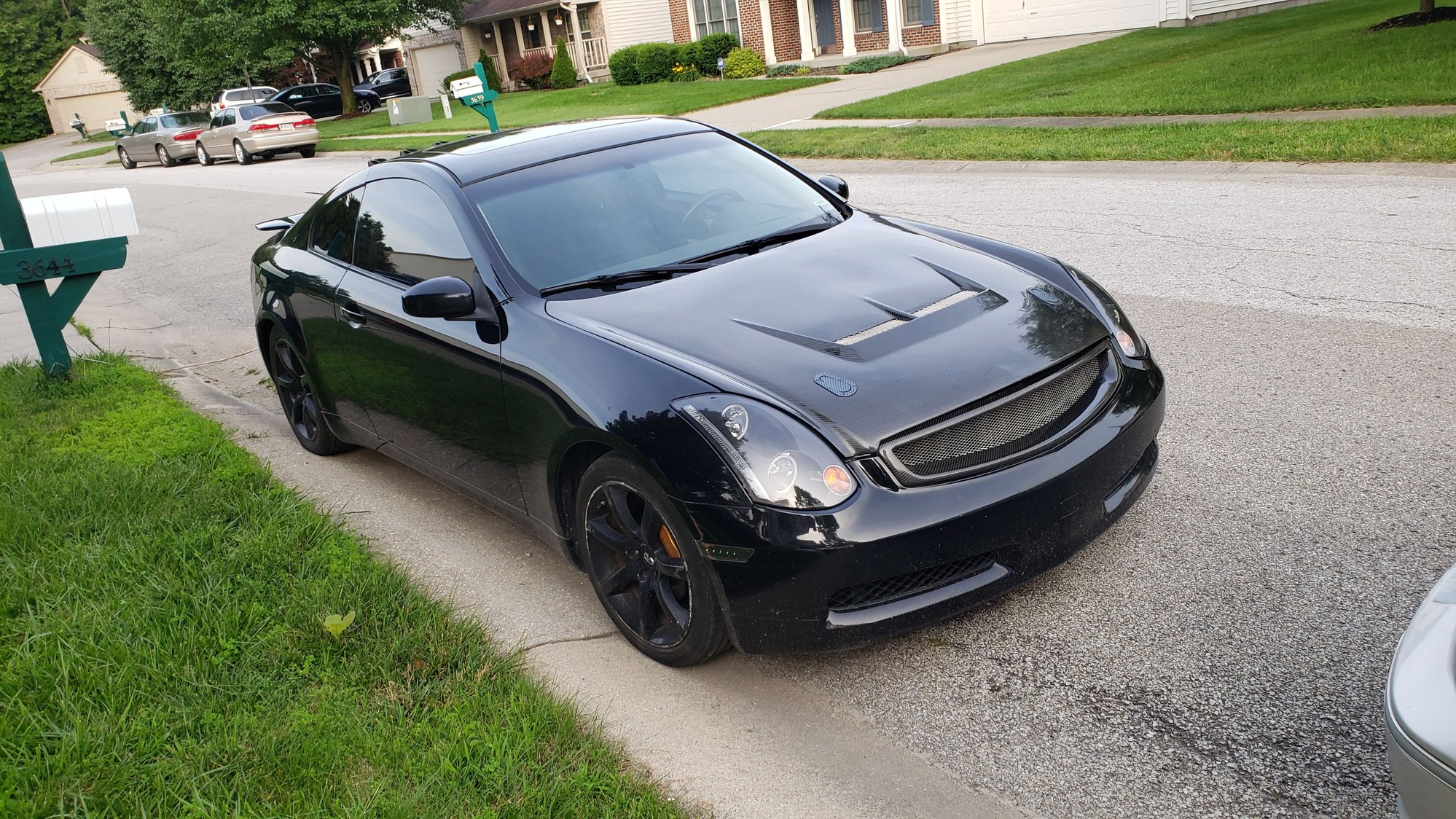

The day I drove it home. Far from perfect but looked pretty decent.

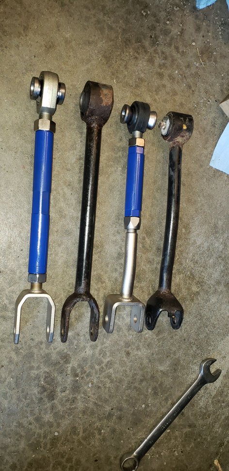

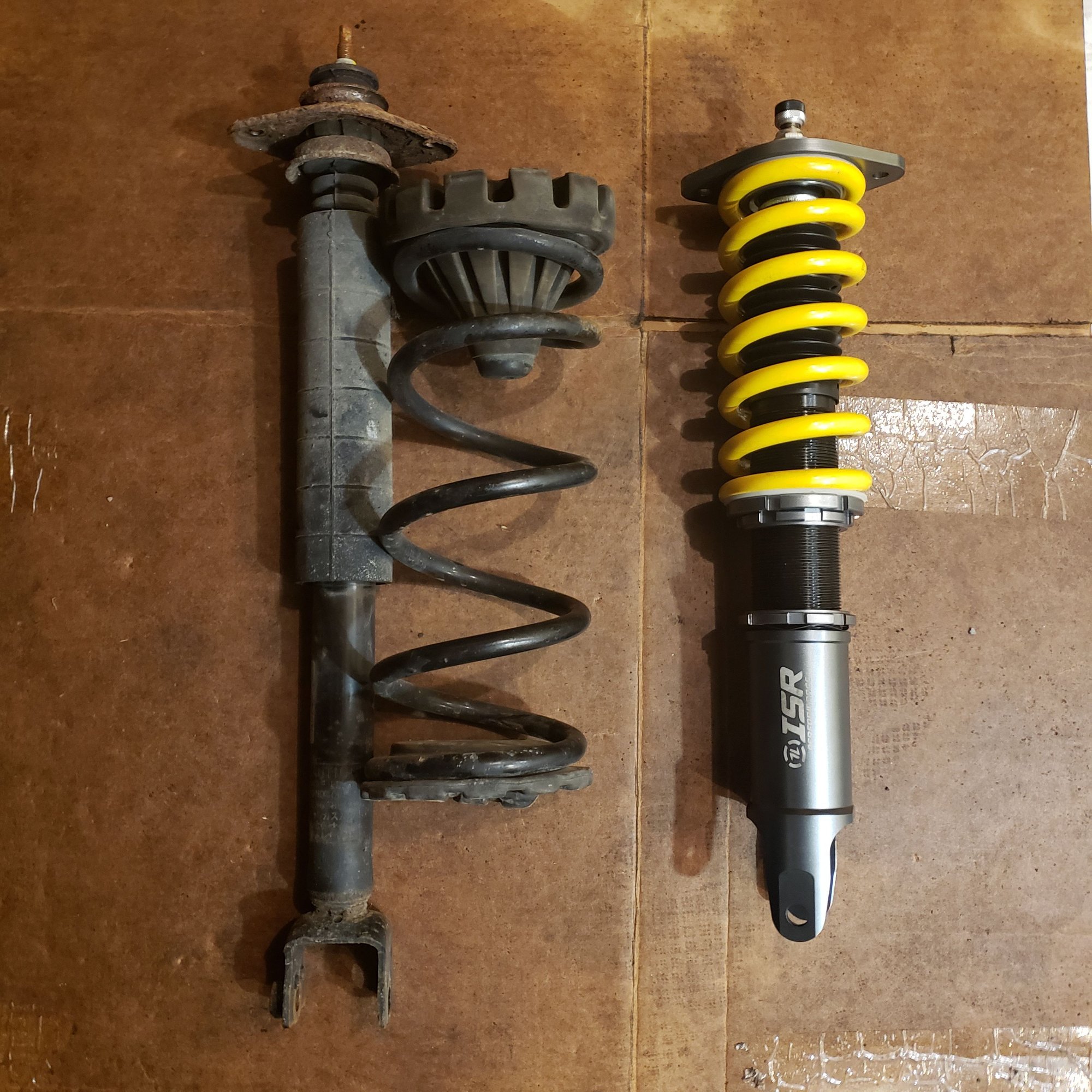

After every event, I picked a part that needed upgraded. Right away, I replaced the compression arms/LCAs because the bushings were DONE. The clutch was also toasted when I bought this car. After the first 2 events on stock suspension I upgraded to coilovers and added some arms to the rear.

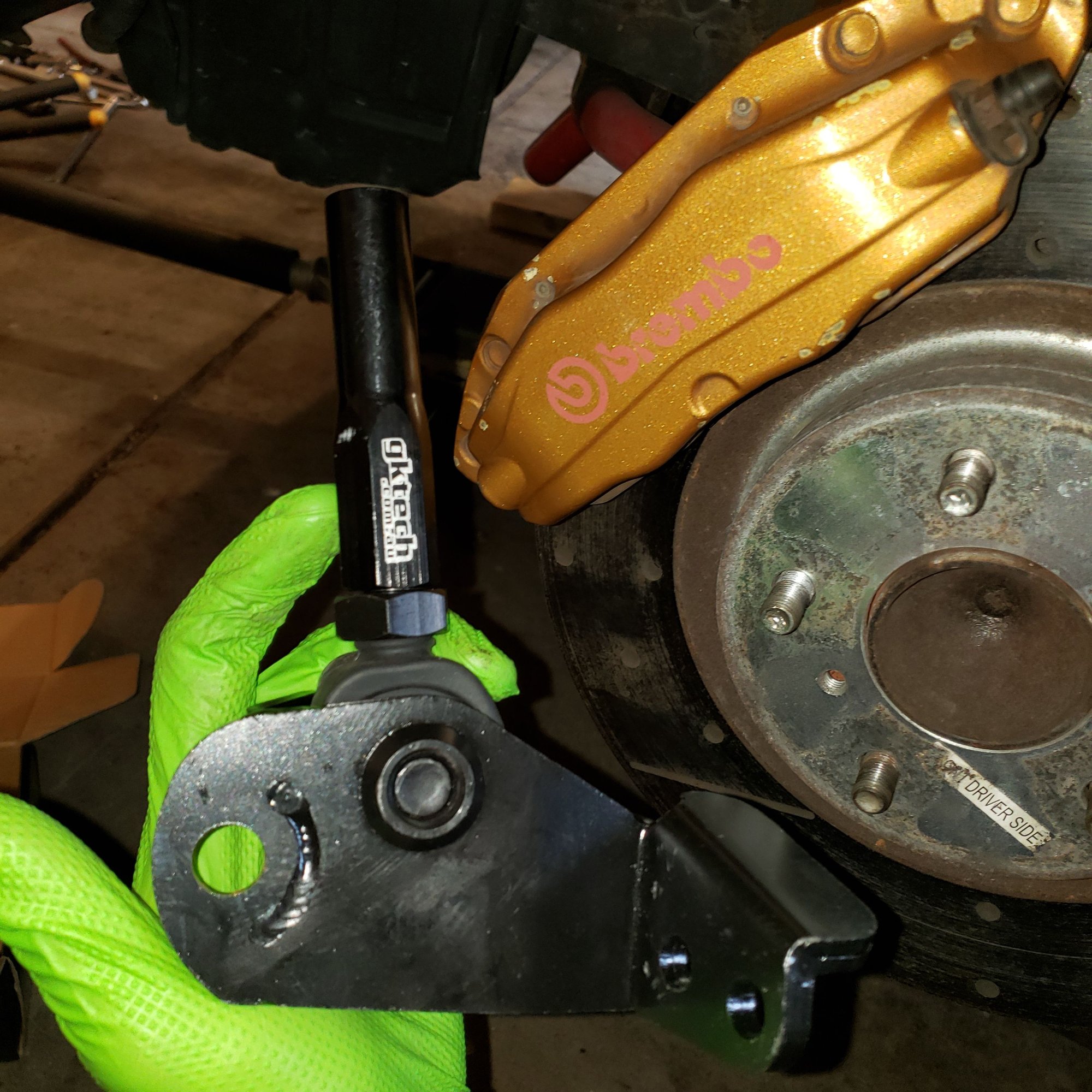

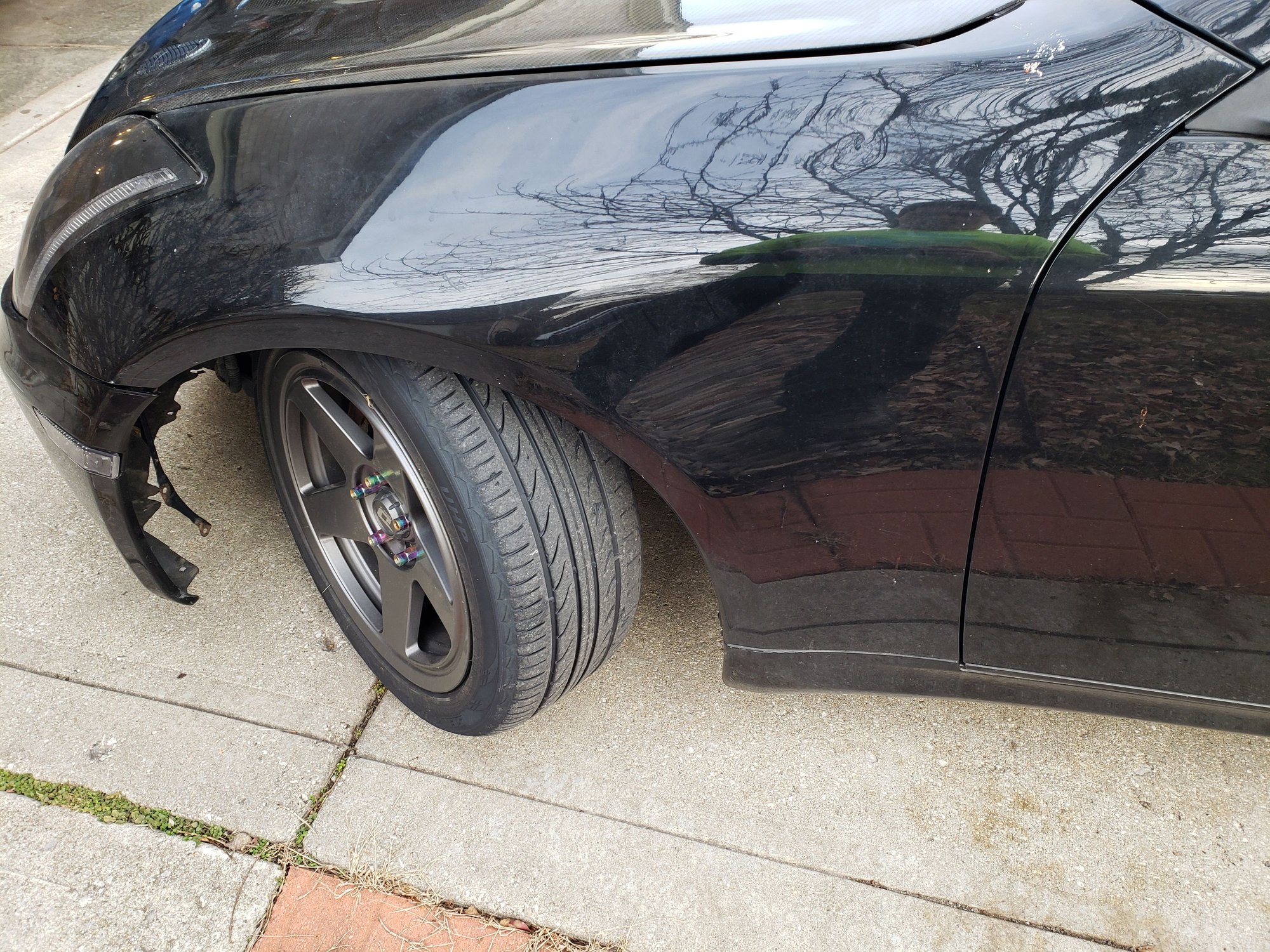

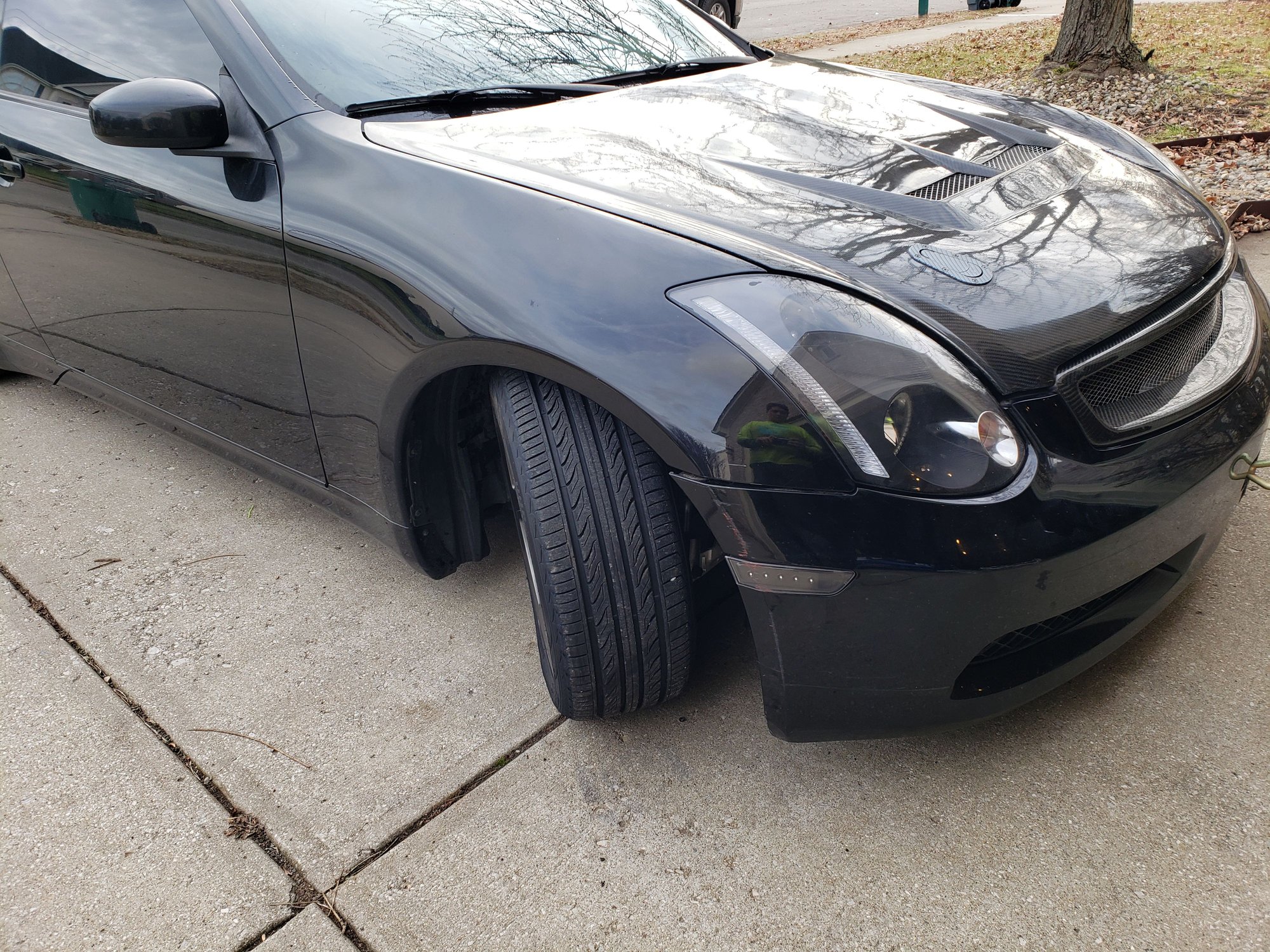

Easiest decision when it came to adding angle. Only $180 for up to 60 degrees of lock!
Decided to go with ISR Pro coils, since this car was only supposed to last the year. I'm liking them!

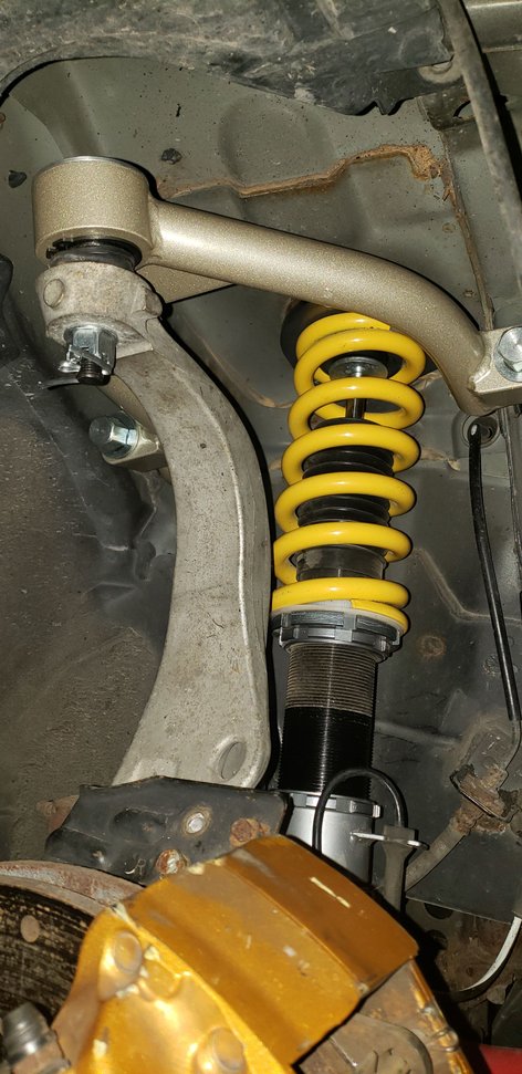

Since I went lower, I needed the ability to adjust my caster, camber, & toe. I still need to get the bucket delete arm.
ISR Upper A-arm to adjust caster & camber.
Reasonable amount of angle for now.
Near 0 ackerman

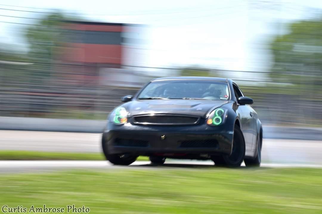

Anyway, here's some dope drift shots and I hope to be posting more often in this community.

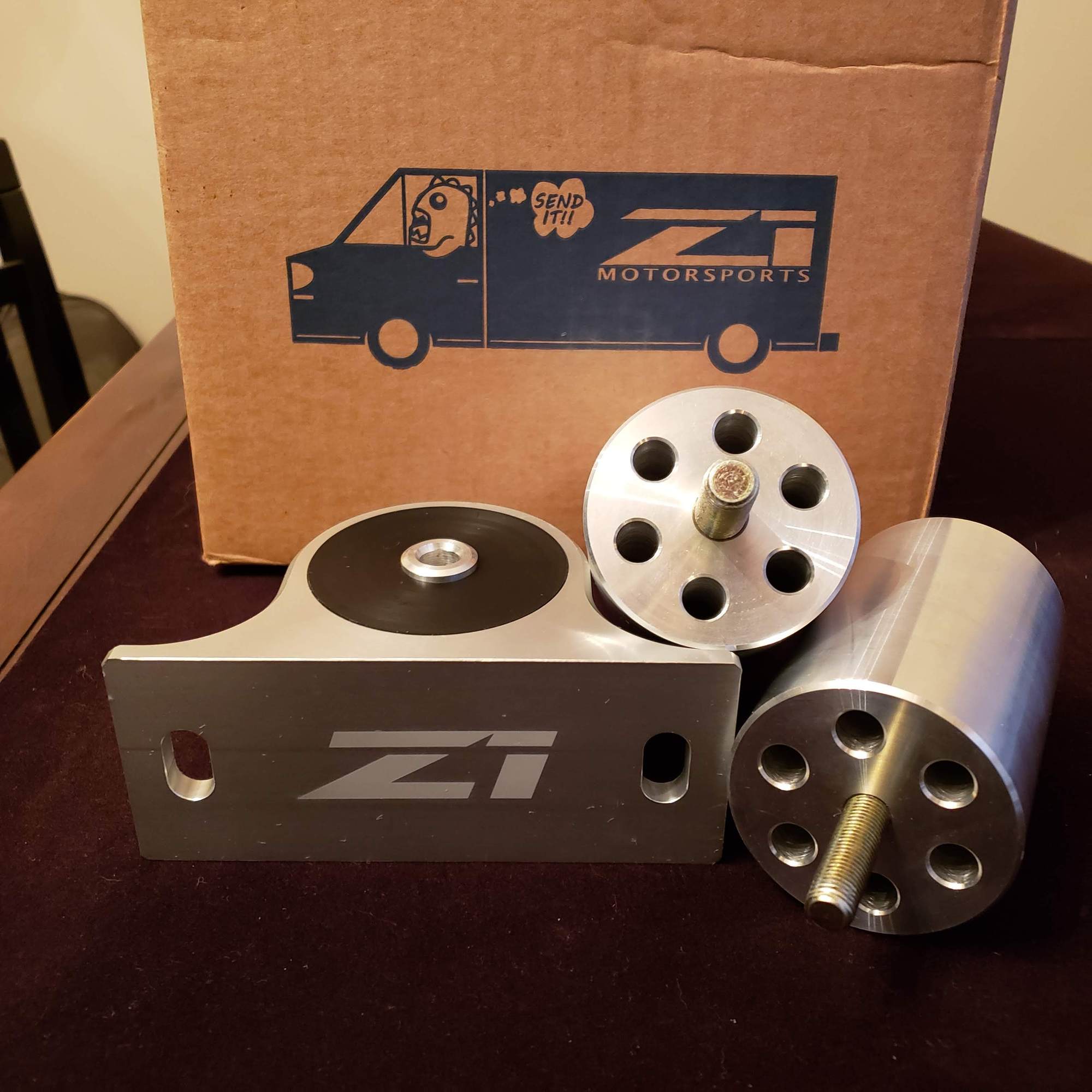

Should take a look at your engine and transmission mount, shifter out of alignment means something probably broke. I'd start with the engine mount inspection since they're the more notorious ones to fail.

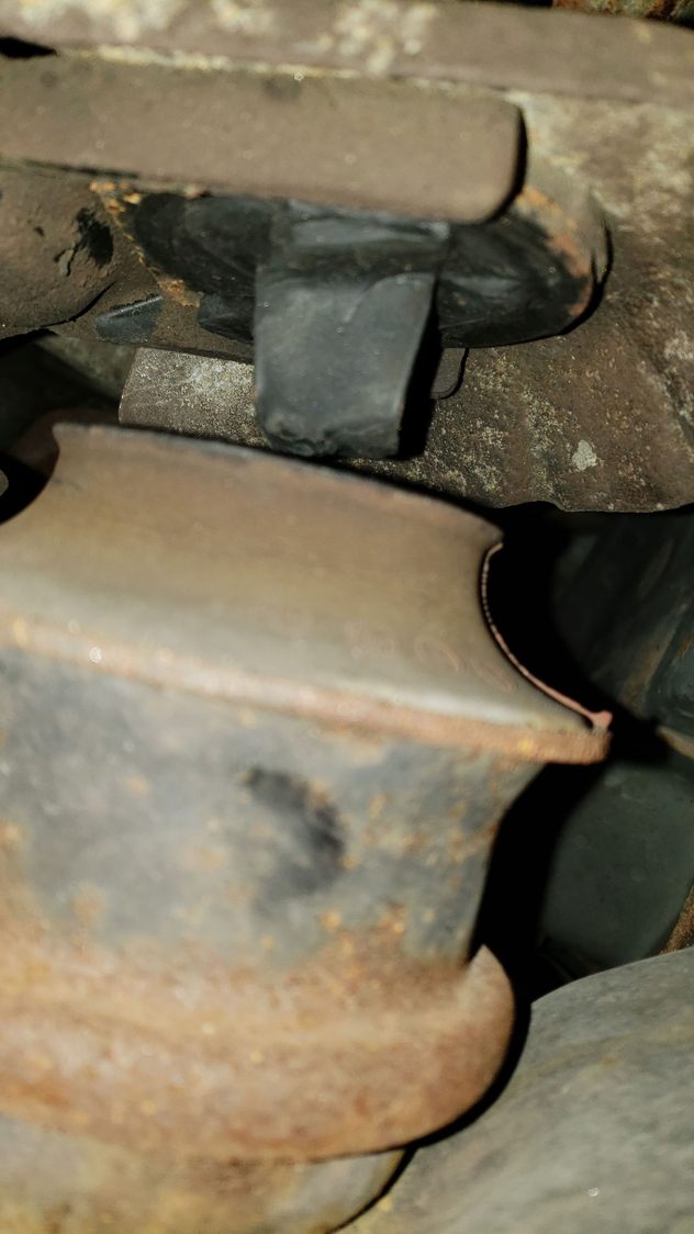

Sure enough, it was the engine mount that was torn.
Passenger side is under full compression and the driver side is decapitated.
I ordered these Z1 Engine Mounts a few weeks ago because I figured my suspicions were correct.
Now I need to figure out a good way to get to the top nut of the mounts
