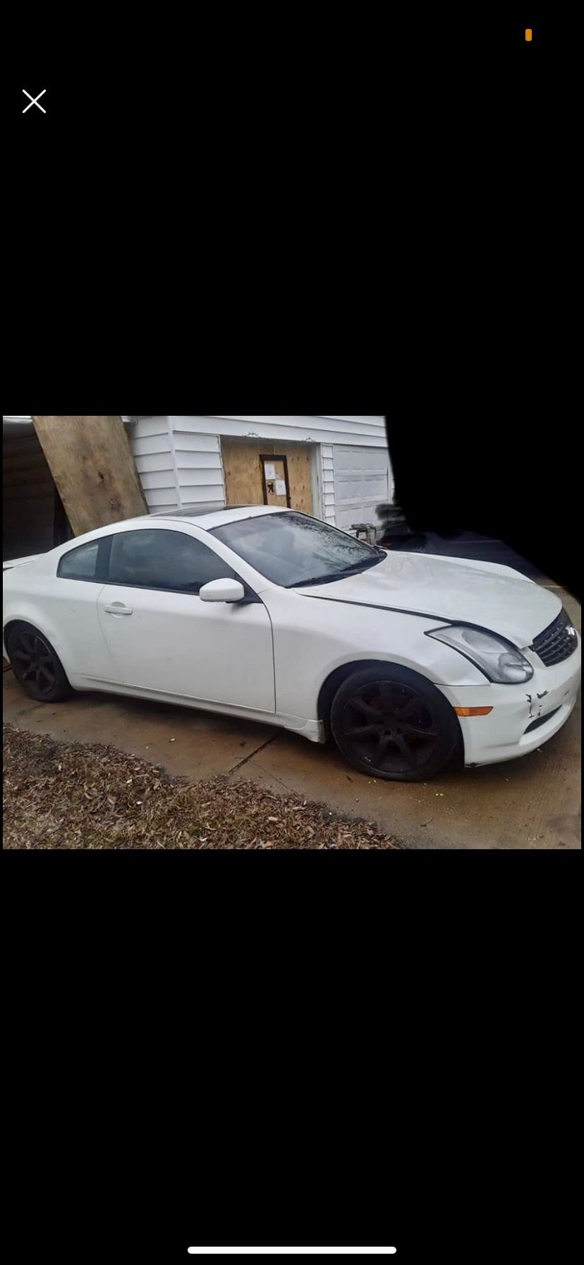

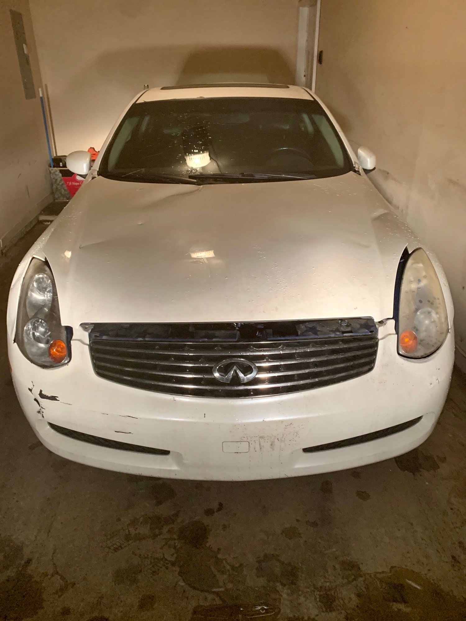

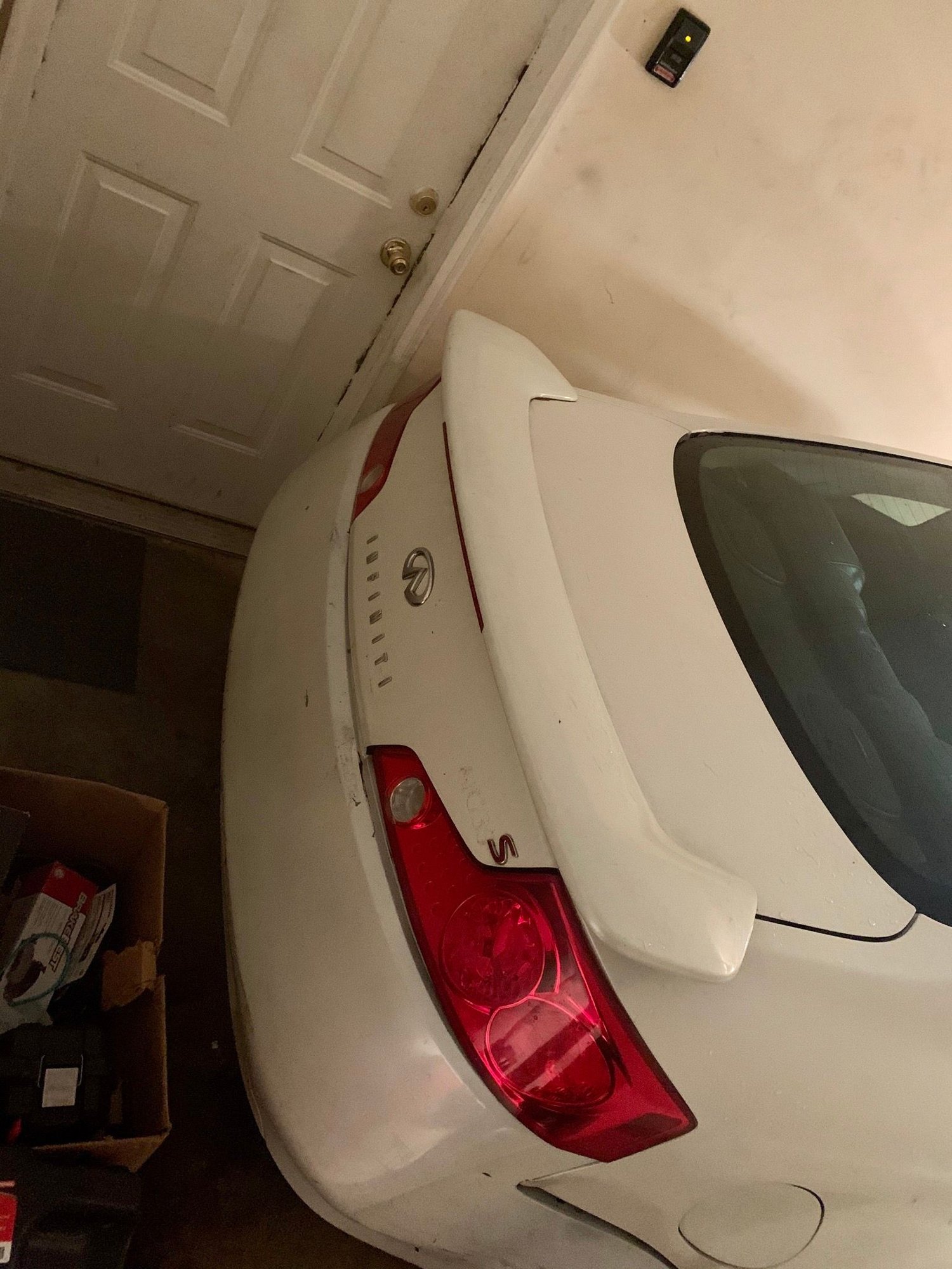

2004 G35 Coupe
In search of working engine, current one blew out last night.
It came with the “S” on it.

Man, that car is beat to śhit!

Yeah I know BUT its a $450 project car
I plan to do the body work & paint after I get an engine.
