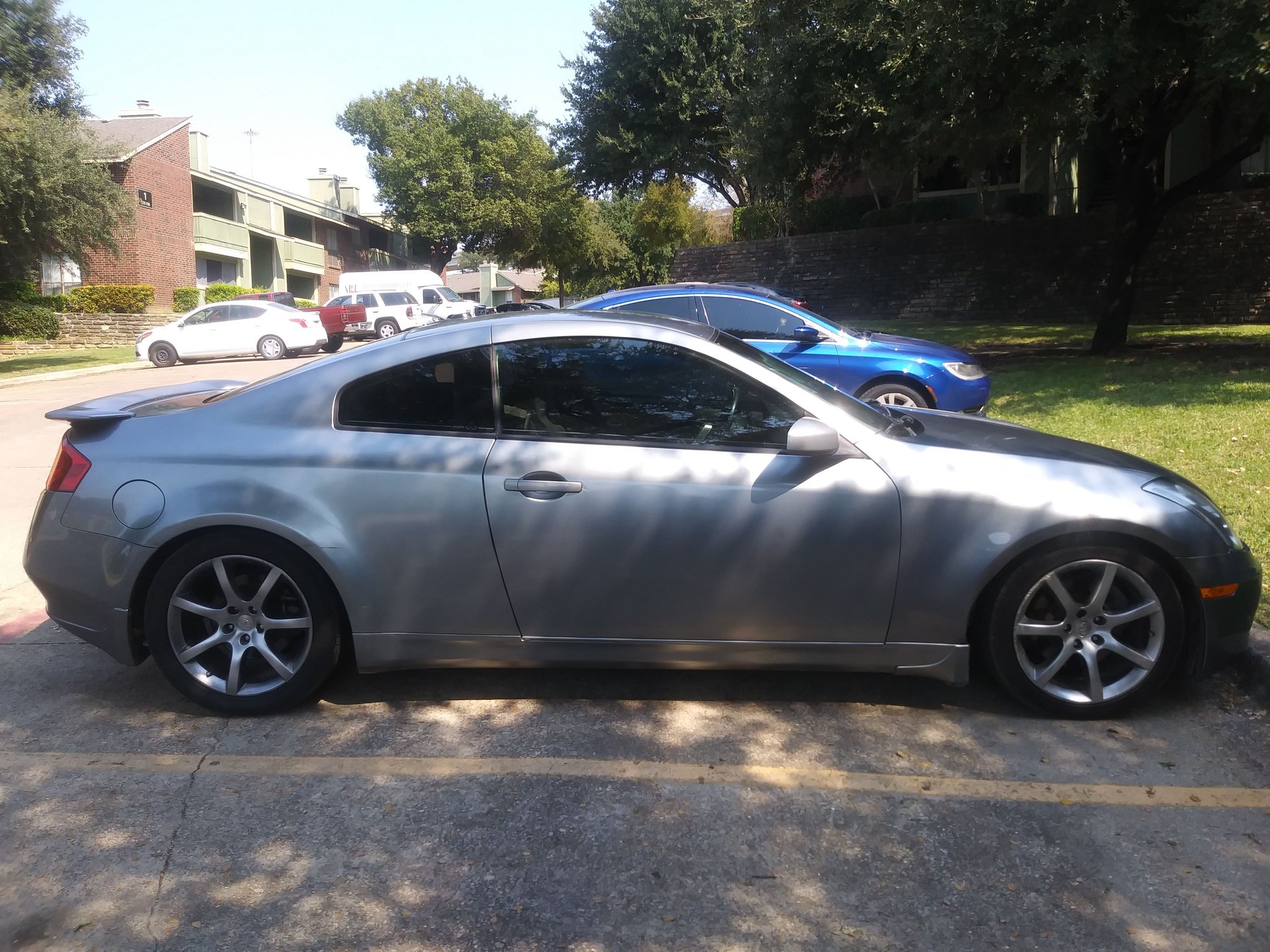

Just got the G today!!!
Whats up! Just got her today, but she needs some work like tune up and fuel gauge fix. I'll be scowering the website for info on those 2 issues, but if you wanna give me a jump start...its much appreciated!

Nice headlight! Car looks like it has potential to be a real looker. Fuel gauge was fixed for me by cleaning the contacts on the fuel sending unit with some sandpaper. Constantly running with an empty tank seems to cause them to varnish up again over time. I need to do it again 4 years later.
