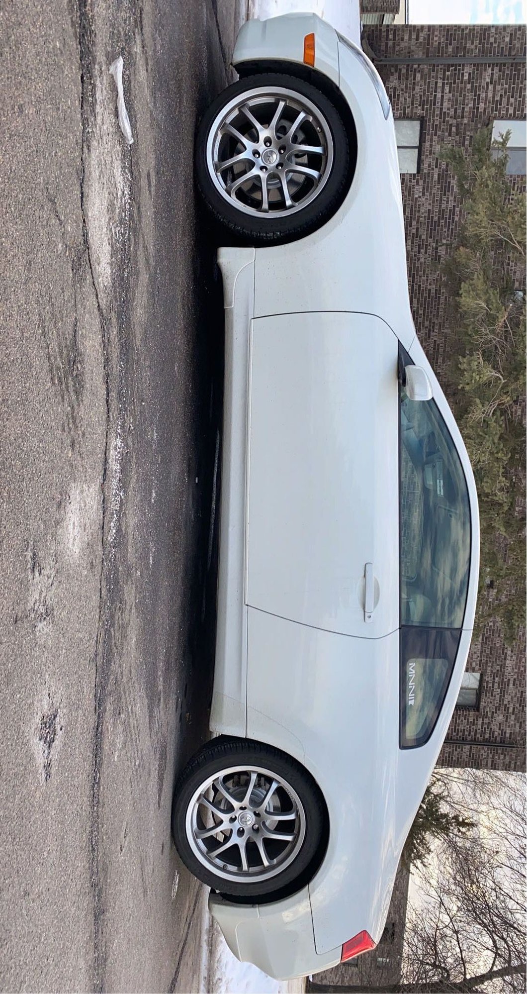

Recently picked up this 05 g coupe with 95k miles that will be used as a drift car. Ordered up a clutch and it’s on stands already 😁
