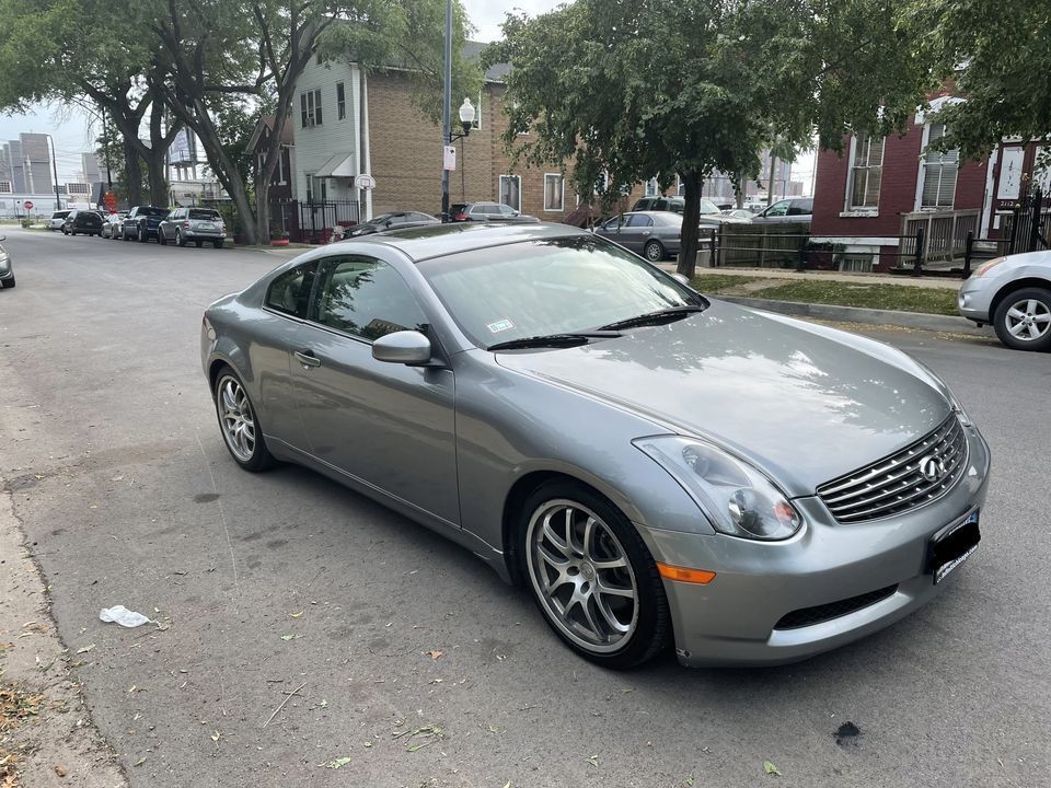

Hi everyone, I just picked up a 2005 G35 Coupe with Automatic for my son. One owner family (actually 2 owners, a grandfather, then grandson). Car has 27,338 original miles! Very solid car, but does have its' share of curb rash on wheels, body dings and scuffs. My son and I are looking forward to having fun with this car. I have original window sticker that shows following options: Painted Splash Guards, Premium Package, Sport-Tuned Suspension Package, Trunk Mat
