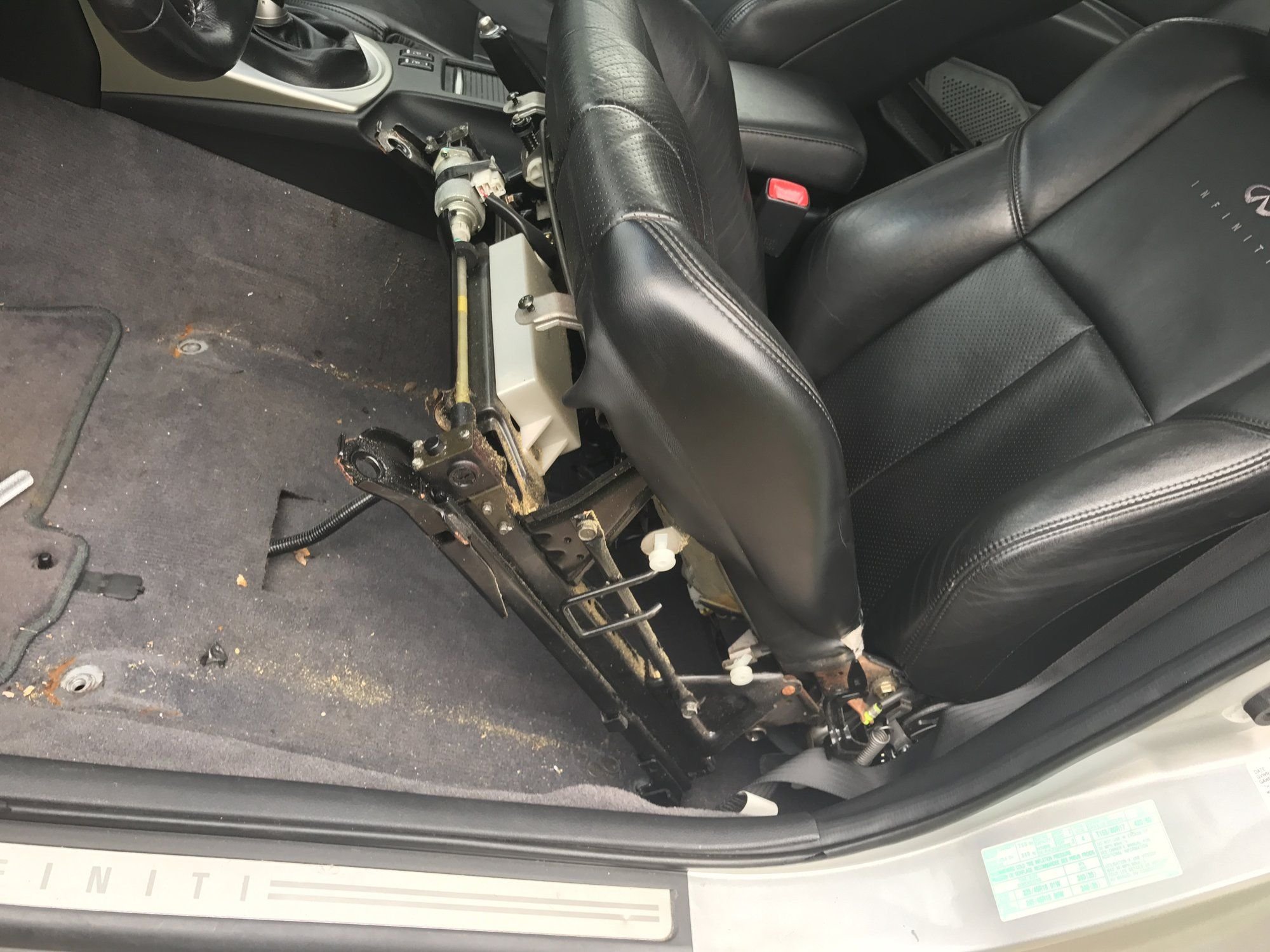

Originally Posted by Kris4655
Cool, wheres the seat motor more or less? Appreciate the help
You can see it in this pic.
Old Apr 2, 2022 | 11:01 PM
Kris4655's Avatar
Joined: Mar 2021
Posts: 48
G35 coupe
Got it out, thank you so much!
