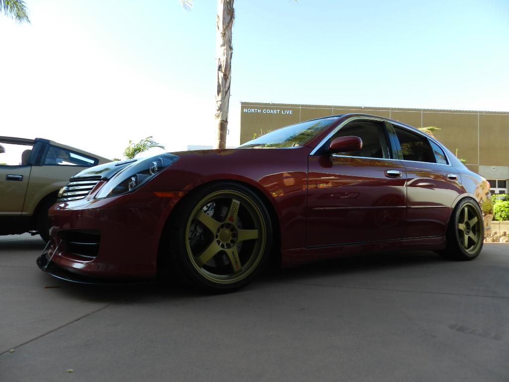

dat rear tire!

Drool... That's what I want!!!
I'm looking to run VMR 710s 19x8.5 fronts with 245/40 and 19x11 rears with 275/40 on my coupe. Will this tire set up give me the fat tire look or shld I go wider/taller?

^40 is kind of tall IMO, are you lowered?

Gonna be dropped on coilovers to reach no tire well gap, rolled fenders, whatever spacers get me flush, a little bit of camber. I'm aiming for the same look that SD has. I initially wanted to do 35 profiles but really liking the MEATY look. Or shld I go with wider tires instead of taller ones. 255F 285/295R?

I'm a little biased towards wide tires. I can't see a 40 profile working well when dropped on coilovers and trying to be flush. I'm lowered on Tanabe Pro-5's, which don't drop that low, and have no tire gap with a 265/275x35 setup.

So 35 profiles it is. New to this whole aggressive and fat thing.

i'm running
255/35/19 on 19x8.5
275/35/19 0n 19x9.5

for a similar setup on 19x11, you could run a 285/35 out back w/the 255/35's up front
