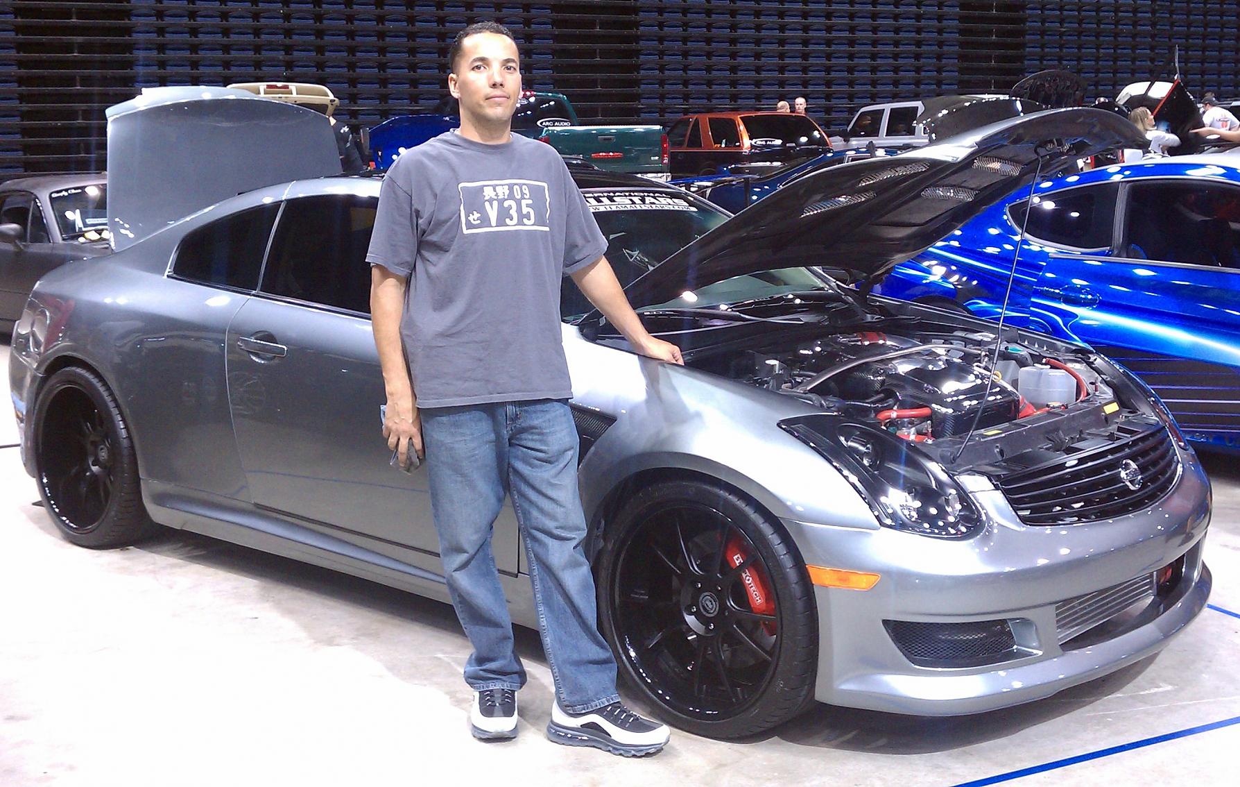

Phase 2 and 3: complete!
This weekend at Spring Break Nationals Daytona Beach.

Thanks fellas, I appreciate the kind words. You know I didn't build it for show, just wanted a really fun car to drive that could be ran hard or just cruised down the road with the sunroof back listening to some tunes. It still drives great (idle needs a little work yet) and maintains stock practicality with trunk space, etc.
Originally Posted by Kenny_Cox
the lip on the rear is just AWESOME. doesn't look like your stretched at all either. mind me asking what the specs are on it? I love it.
The wheels are 20x9.5 +6, 20x12 +0, tires 275/30 325/25. I initially wanted to go with 20x10 up front, but Mike (of DPE) and I did the math on the wheels with the brakes and were concerned a 10 would hit the shock tower on the inside.

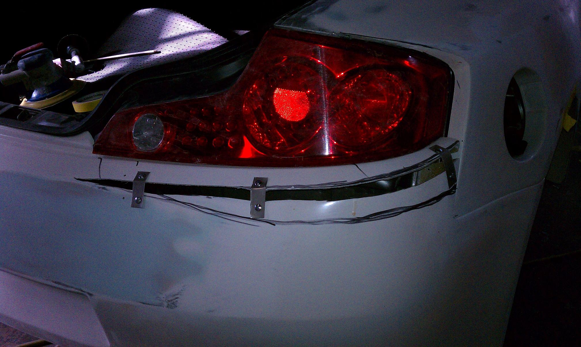

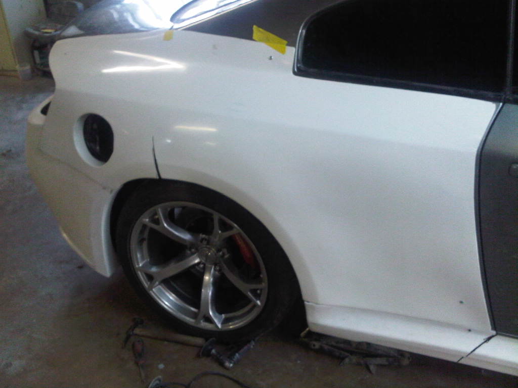

The rear fender is 50mm wider, those along with the rear bumper are from the APR replica kit. The side skirts are the Kenstyle and I'm sure you recognize the front bumper. The front fenders are Seibon CF and are 10mm wider. The whole kit is piece milled together and of course required a good bit of modification and customization to make all the pieces fit together. There are still some lines at the doors and such that need a little more work, but considering where we started from I think it came out pretty well.
I didn't want the full APR widebody, just wanted to be a little different. The widebody pieces were wavy and the rear bumper was at least an inch gapped from the rear tail lights, thus needed A LOT of fiberglass work.
Attached Thumbnails The Trifecta-rear-bumper-fix.jpg   The Trifecta-imagejpeg_3.jpg   The Trifecta-imagejpeg_2.jpg   The Trifecta-img00632-20101231-1413.jpg
