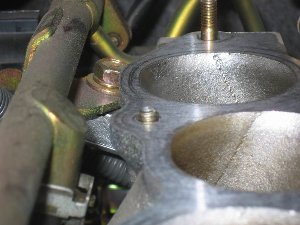

im going to get a vise clamp and see if i could get this sucker out
Attached Thumbnails help please - stripped bolt during mrev install-img_1667.jpg

Okay, I got the broken piece out with some pliers....
I tried to hand tread a bolt down that hole and its a little tough to get it down. I didn't try with a wrench yet, but does anyone know if snapping a bolt like that could have damage the threads?

you may have just snapped it, but make sure you don't cross thread it as that would make it a lot more complicated. a broken stud can just be replaced, and cross threaded one can mean a lot of problems
Old Jun 26, 2006 | 01:01 PM
johnjayb's Avatar
Joined: Jan 2006
Posts: 1,873
From: Bay Area / SoCal
yeah its definately possible u took the threads out of it. I did that with three of the holes. had to get the holes rethreaded.
