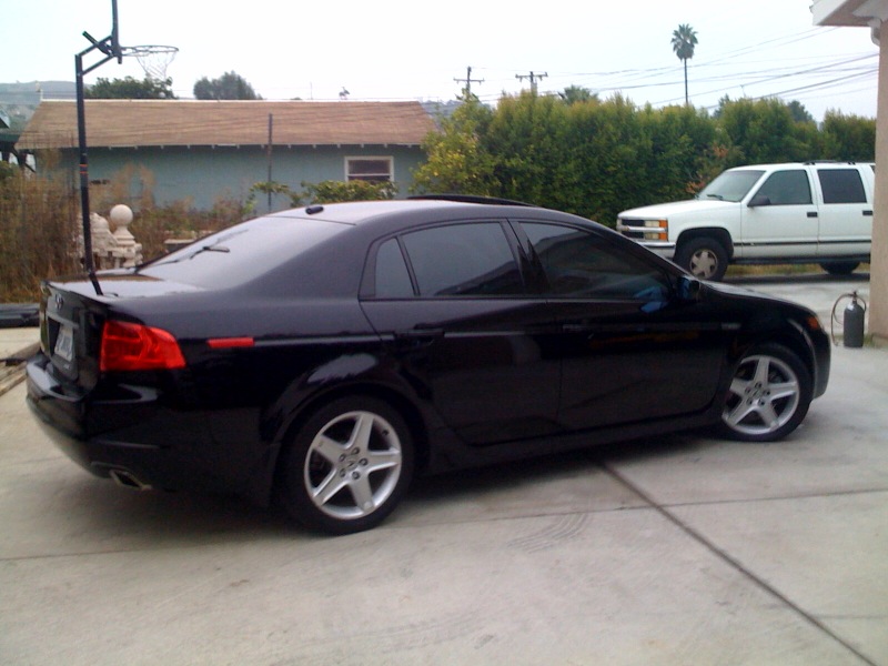

Ex-GF's 2005 Acura TL.. anyones thats seen this reck in person KNOWS it was in beyond terrible condition! Car is NOT garaged and was last kinda half washed in April before that iono then it was IMPOUNDED for 30 days back in May and was never washed since then
over 6 months of no wash parked outside abused by sprinklers and dirt.. This car was brown with stains everywhere and waterspots (Sorry no pix I have an Iphone and the night pix didnt come out at all
Steps:
Wash with Meguires NXT Wash.. (Originally I was just going to was it with her cause I couldnt stand it anymore
Washed AGAIN with dish washing soap after I saw how horrible it looked after the wash
Clay with ClayMagic Medium.. 1st time I had to use a WHOLE bar for the car
and a full bottle of quick detail
PorterCable @ 3,000rpm - 4,500rpm with hard pad to clean paint - stains, blemmishes, scuffs, rubber streaks?
Swirl Remover/Compound @ 3,000-4,000rpm slow buff for all the scratches and swirls.. >.<
Glaze apply with porter cable at 3,000rpm
Polish at 4,000rpm
Seal.. then I had some time so seal x2.. figure its not going to get detailed anytime soon again..
Windows were fcking OWNED.. Stains had to be removed with the hard pad at 6,000rpm with polishing compound.. so GG on the pad
Plastic trims were faded beyond belief.. but I didnt have the supplies to wash (gave it to a forum member that came by for an install)
Tires needed to be scrubbed then shined with EagleONE =D
Did the Exterior:
Outside
Door Jams
Windows (insideout)

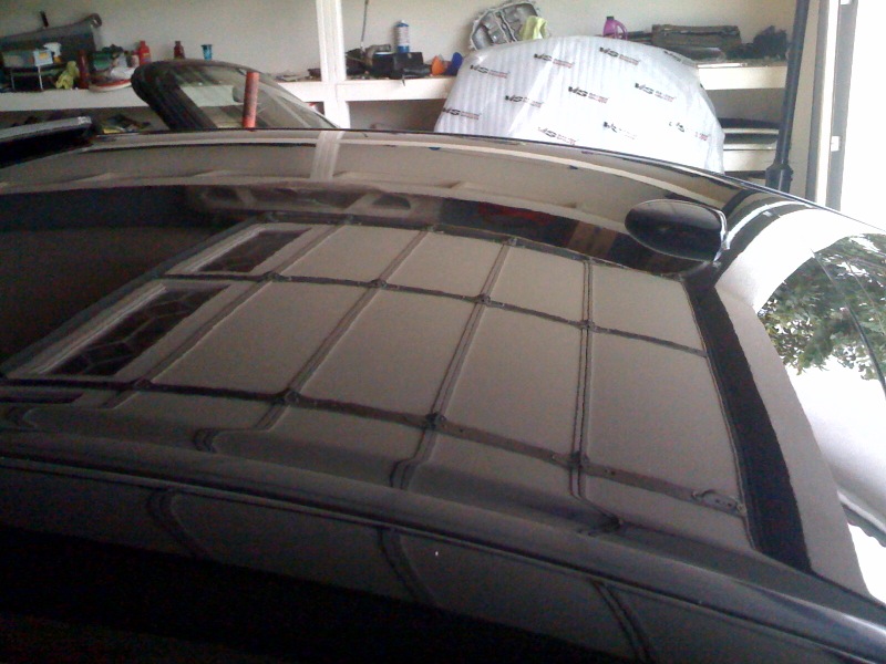

Sunroof (Tray & Rails)
Trunk Bay
Exhaust Tips
Polish Headlights and Tails
Fuel Door Area
Mud Guards & Wheel Wells
Didnt have time to do
Interior
Pull the Wheels
Engine Bay

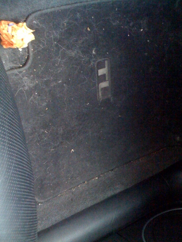

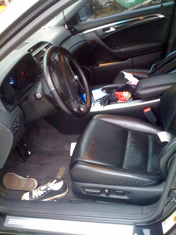

I wanted to do more work on the paint.. Probably spent around 30min-45min per panel fixing them (stains and swirls) =\ the cleanest panel was the rear bumper *sigh.. Started 12am-1am.. Finished 8AM.. to give you an idea how bad it was heres some pix of the INTERIOR

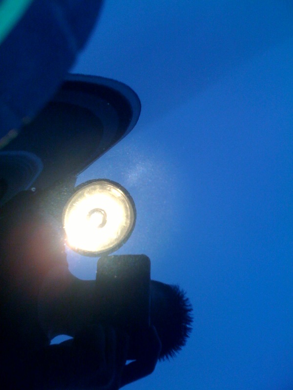

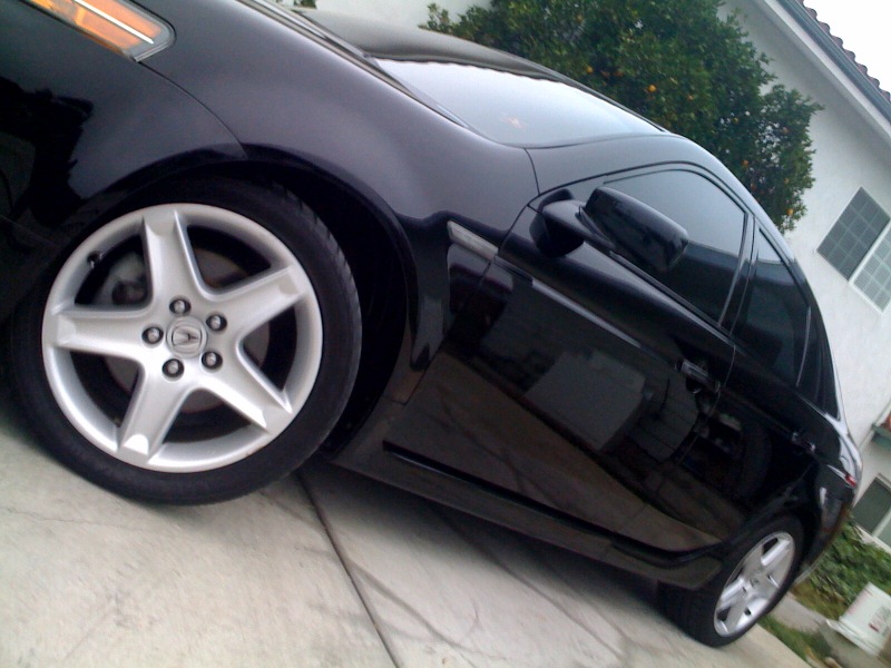

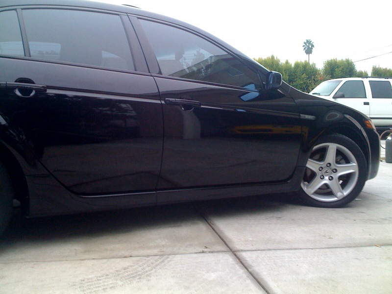

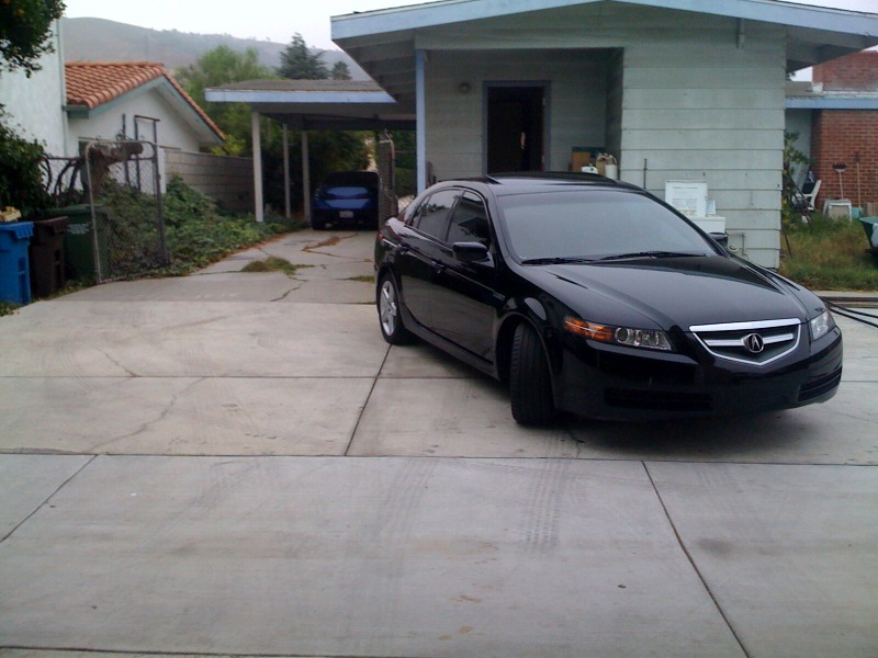

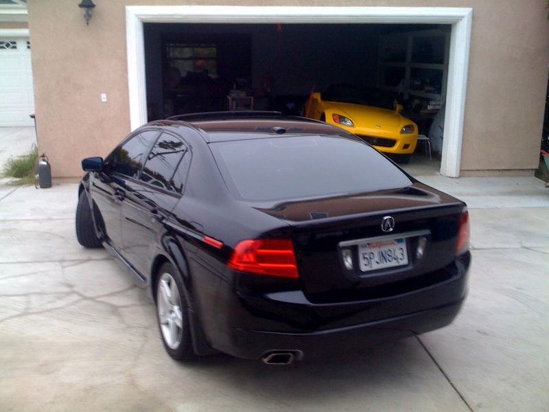

Wished I had more supplies ready.. I didnt have what I wanted to do with this car.. Acura Black is like the SI Black.. its a Black with Blue pearls.. The polish and glaze I use is more for silver and DG cars.. very wet look but doesnt do the pearls justice..
lastly sorry iphone pix they fail horribly and this was taken around 7:30am haha -__- I dont have a camera.. bought one for the ex.. well she's my ex now so no more camera
again sorry for the fail pix hahah i had to leave for work so couldnt wait for the sun to come up
