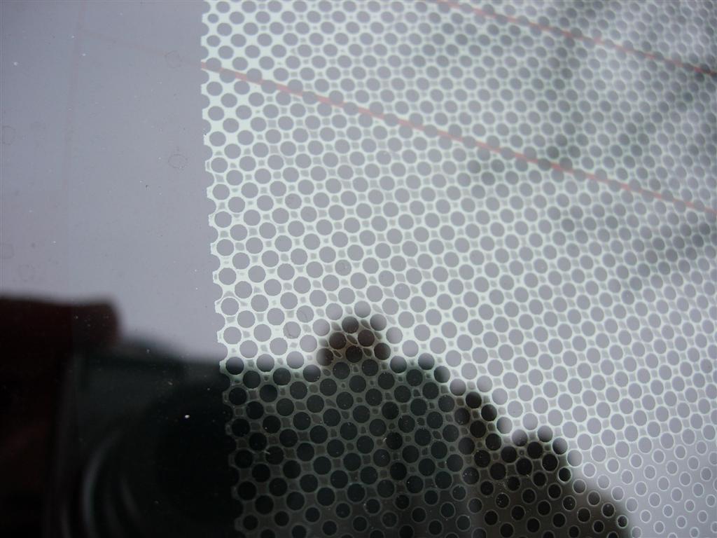

I brought my car in yesterday to get tinted and everything looks great. I got limo all around, and aside from the obvious things that should clear up, i had a question about the dot matrix on the rear window and rear quarter panels. It seems as if some of the tint didn't fully adhere to it. (whitish, clear color rather than the tinted color). I was wondering if this would clear up as well, or if it's something i need to bring it back for. I know a lot of people recommended tintzone so i was wondering how it went for you guys. Thanks!

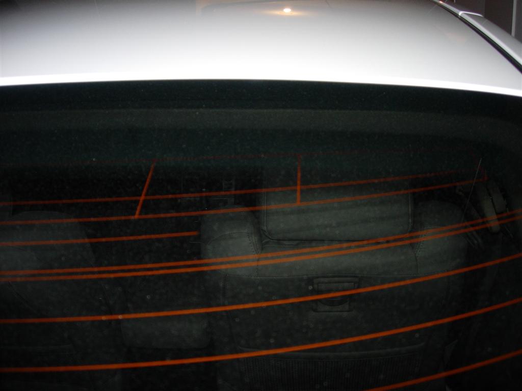

Mine is pretty good, at first i had patches of dark and light areas on the matrix but i evened it out so it looks great.
All you gotta do it take a SOFT COTTON cloth and wet it. Then put it on top of a credit card, use the clothed credit card as a “squeegee” to even everything out. I went from side to side using the short end of the card and it worked great. I think i did this on the 4th day before the tint was fully dry, once it dries i dont think this would work.
Here are some pics of what the whole strip looks like.
Attached Thumbnails Tintzone question-dscn3814-large-.jpg   Tintzone question-dscn3788-large-.jpg
