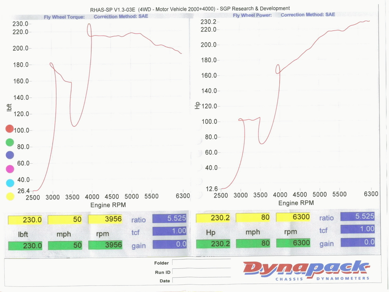

those are decent numbers, i guess thats what im looking at more or less when i do a dyno... btw check your pm's

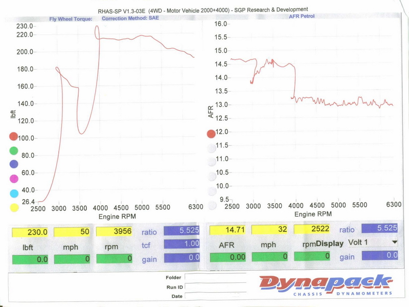

...except this was before the e-fan - yes DaveB, I intend to get another one
Sweet!
The numbers look good for a Dynapack. I've never seen that little loop on a dyno

You a/f's look to be in good shape. You're right at 13:1 later on, and according to people more knowledgable than myself, these engines make most power at 12:8 to 1.
You seem to be lean at the bottom. It's not a big deal, that's common, and expected. Do you get any pinging on the road below 4k rpms under load?
The high A/F below 4000rpms is pretty common for most cars. It's quite normal to 15:1 A/Fs under initial tip-in and sub 4000rpms.

Wow that is one strange looking dyno.
Don't worry about the "flywheel" most dyno's say that for some reason...

Originally Posted by andycon
'scuse my ignorance..but is that "high A/F" - as in running lean? (more air to fuel ratio)?
My suspicion is that this is making a biiig difference to my bottom-end torque. I know when it is cold, it runs much stronger until the engine warms up.
Is there a way to confirm the A/F is affecting my bottom-end (below 4,000)? And what are the ways to alter the A/F ratio?
higher A/F number means leaner (the ratio of Air to Fuel, i.e. 15 part of Air to 1 part of fuel). You can fine tune your A/F by using one of the piggy backs or reflash by TS.

Yes per that graph you were running way way too lean. But then again you also didn't have really any correct data at that part of the dyno test either so I would ignore those readings till you get a good run. Your after 4k looks normal with the rest of the dynos I have seen.

IMO, his A/F is completely fine. It totally fine to have A/Fs in the 14:1-15:1 in the lower range (sub 4,000rpms) because cylinder pressure and heat isn't that high. As the rpms build, cylinder pressure and heat builds up in the combustion chamber hence the reason more fuel is added (ie to cool the combustion chamber) to reduce the chances of detontation.
