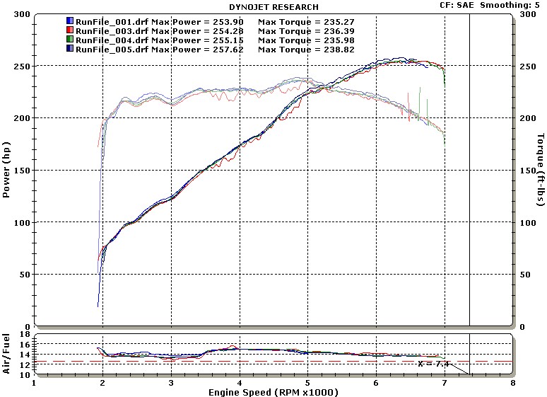

Hey all. I just finished 450 miles of a hard break in on my new v2 engine so I decided to go dyno it, lol. Anyways, I never dyno'd the car before the exhaust, and the tuner said that once the engine is fully settled it could squeeze out another 5-10 hp.
Car: 2005 G35 Coupe 6MT
Mods: K&N filter, HKS Hi-Power Exhaust.
Runs in 5th to 7k (apparently my red line doesn't kick in until after 7200... I haven't attempted to see what RPM it will try to stop the engine).
I prepped by doing WOT runs outside and not really giving it a chance to cool down, I think the fan actually helped me out after that run... what didn't help me was I forgot to turn off the A/C on all the runs! =(
Run 1 is w/filter and fan 62.51 °F 29.49 in-Hg Humidity: 37 % SAE: 0.98 Average Gear Ratio: 46.57
Run 2 is w/o filter w/o fan 61.62 °F 29.49 in-Hg Humidity: 38 % SAE: 0.98 Average Gear Ratio: 46.34
Run 3 is w/filter w/o fan 61.33 °F 29.50 in-Hg Humidity: 39 % SAE: 0.98 Average Gear Ratio: 46.39
Run 4 is w/filter and fan 62.17 °F 29.50 in-Hg Humidity: 38 % SAE: 0.98 Average Gear Ratio: 46.57

I just put a machined intake manifold, non-revup lower, and motodyne 5/16" spacer in, and I'll try to hit the dyno again tomorrow! More dyno runs after I get HFCs too, hopefully they all add up to goodness!

You're changing too many variables!!!!
