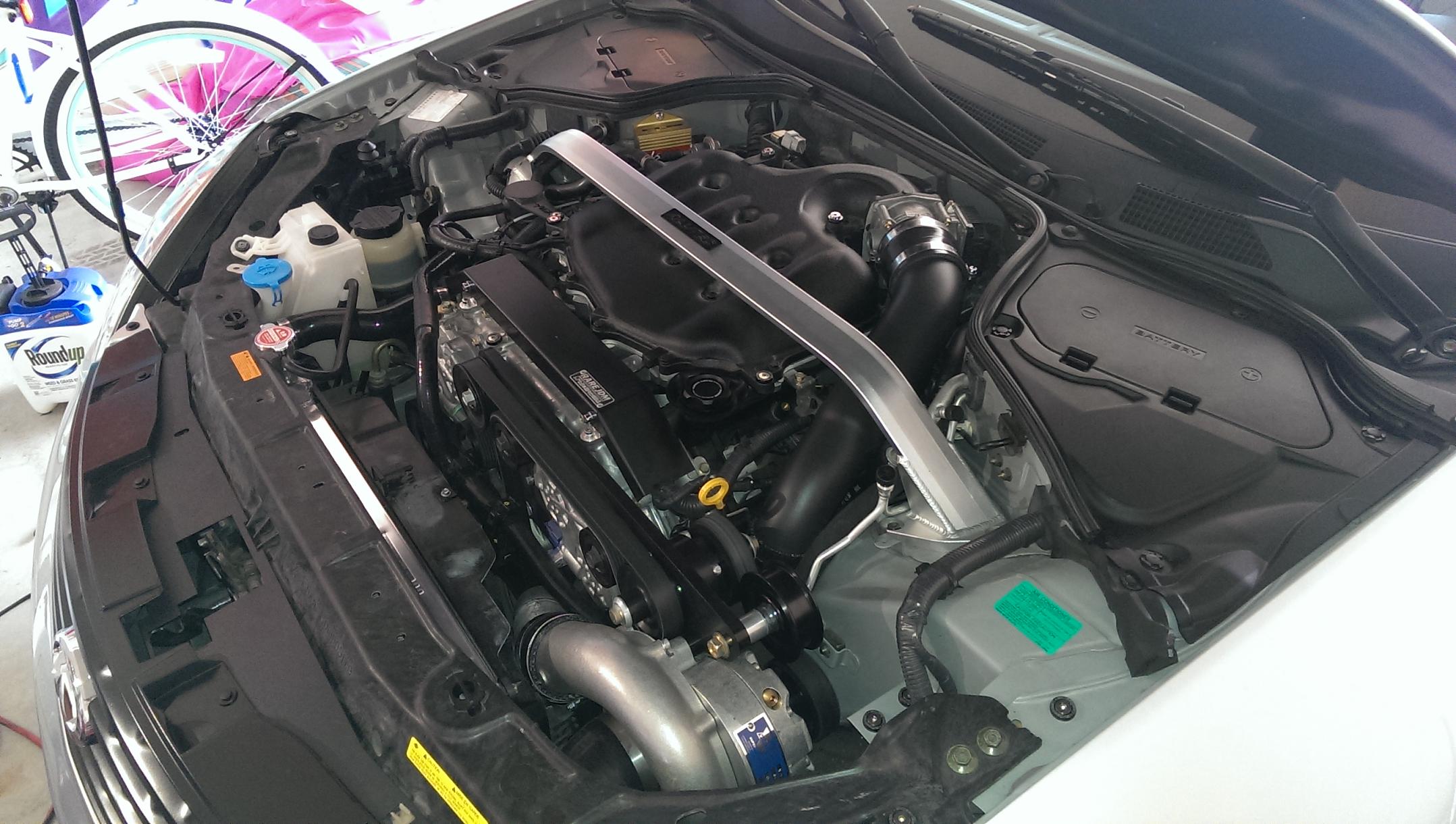

It's been a long road, but my "build" if you will is finally finished and with help from Seb over at Specialty Z, I now have safe and solid base map to get me to a tuner.
I am stationed in Oklahoma City, OK and 2 tuners have my attention. As the title suggest it is between Kenny over at Jotech and Tony with T1. I have been speaking with both throughout my build. Tony hooked me up with some ID725's and clips and I've been taking sound advice from Kenny.
I know Jotech charges premium, but I hear good things. I also spoke with a guy at cars and coffee with a T1 built and tuned GTR who swears by them. Both are about 3-1/2 hours away and are actually some of the closest.
I am looking for a true tune/calibration. A safe, reliable, effecient and well rounded tune taking all factors into considerstion. Not just a cookie cutter tune or extreme timing tune etc...I am by no means a number chaser, but feel 350-375whp to me is the sweet spot on a stock block with proper supporting mods for reliabilty. Any input or recommendations? I've read a lot of both basic and advanced ecm and efi tuning books and the more I read the more it throws me. From what I gather there are tuners and then there are true calibrators...
Vehicle is a sound 2006 coupe 6mt (revup) w/ 56k. Vortech tuner kit, ID725's, walbro, UpRev's GT MAF, full UpRev tuning software, MREV2 w/ spacer, stillen headers, berk hfc's, borla cat-back, stillen oil pan, custom 19 row oil cooler, JWT clutch and fly, HKS ignition amp (not really needed I know) koyo rad, boost gauge, dual wideband gauges and other little stuff...
