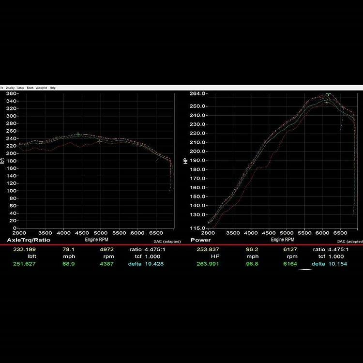

I've had my G for almost 2 years now, I took my time to slowly gather the parts I want, spent many hours googling and reading the forums about advice, opinions from the elderly here and gain enough knowledge to put it all together. I was going to cheap out on mods but I decided not to since this is my pride and joy (weekend car). I did not started a thread asking 'what is the best exhaust?' blah blah since everyone is unique with their own preference. I took my time to read, watching youtube, going to meets and googling and this is the setup I've come up with (NO REGRETS!)
I am hoping that new members will do the same, it is your car, do as you please and gain knowledge by reading and searching. As a thank you to g35driver, here's my dyno sheet.
Tuner: @Saul_nismo_knights using uprev osiris
Bolt-ons:
Invidia Gemini CBE
Berk HFC
Mrev2
MD 5/16 Iso Thermal
Stillen Z-tube, K&N filter
Stock Rev-up air box
Drivetrain:
JWT Clutch and LW FW
I did not expect much with just all bolt-ons but there is one area that I was really impressed with result, can you see what it is?
Yellow - mods with no tune (pretty good w/o a tune)
Green - final tune
Redline @ 7200 rpm
They tried installing a generic brand CAI and it lost 10whp haha, I am glad I did not waste $$ on those, thank you G35driver.
Overall, I am happy. Car is more responsive now and don't hesitate past 5k and still keeps pulling.

Sorry, the photo gets blurry when I try to enlarge on my phone. What are the before and after hp/tq numbers?
Isn't it nice after the tune how the car loves to play past 5k? Feels like a different class of car after the tune. Pure butter.

Before tune = 253whp, 232tq
After tune = 263whp, 251tq
Ah, very nice TQ increase. That's the most important part!

Exactly torque is what surprised me the most! It definitely put a smile. Before at 5k I feel like the car is just making noise and not moving anymore lol, now it's all smooth with throttle response n can pull more up to 7k. I think I'm done with bolt ons, just maintenance and monitoring oil lol

I'm curious what's up with stock tune. Mine had that exact same dip around 4500 rpms before the tune. It was almost like the car was like "oh, you really do want to go fast, VTEC yo!"
Nice gains, tunes really bring all the things together.

I think the stock tune was done in order to have an idea of where the car currently is making w/o a tune. I'll need to verify that with my tuner.
