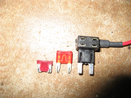

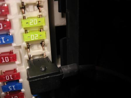

I had an extra one lying around from my Mom's civic so I test fit it. They do fit the fuse location but they are a little loose compared to the OEM fuse because they are much longer. I think it will work but you may have to check over time to see if they work their way out of the "socket". Maybe you could trim the legs a little to stabilize the part? You can see the marks left by the fuse socket on the standard mini fuse and the add-a-circuit legs. Electrically it works but the shear size of the mini fuse may make it fall out over time. Good luck.

the looseness could simply just be due to the thickness of the metal teeth/blades, which i would attribute to manufacturing tolerances but i'll have to take a look for myself.
i'm going to be installing a dimming mirror and would prefer to use the add a fuse instead of tapping wires. thanks again man.
