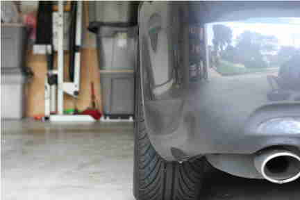

I have 245-40-19 front and 255-40-19 rear on coupe forged rays rims. The gap up front sucks, but I like the look of the rims. The back looks good. The offset of the coupe rims pushs the tires right to the edge of fender well.
Old Jul 6, 2008 | 06:06 PM
mbonus's Avatar
Joined: Nov 2006
Posts: 265
rough photos
Attached Thumbnails 255/40/19 Fronts - 285/35/19 Rears-front-245-40-19.jpg   255/40/19 Fronts - 285/35/19 Rears-255-40-19-rear.jpg   255/40/19 Fronts - 285/35/19 Rears-rear-view.jpg
