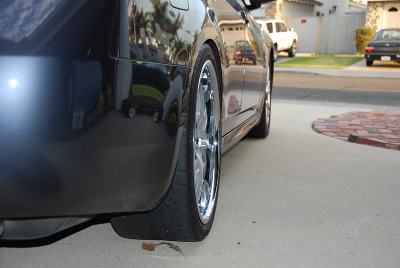

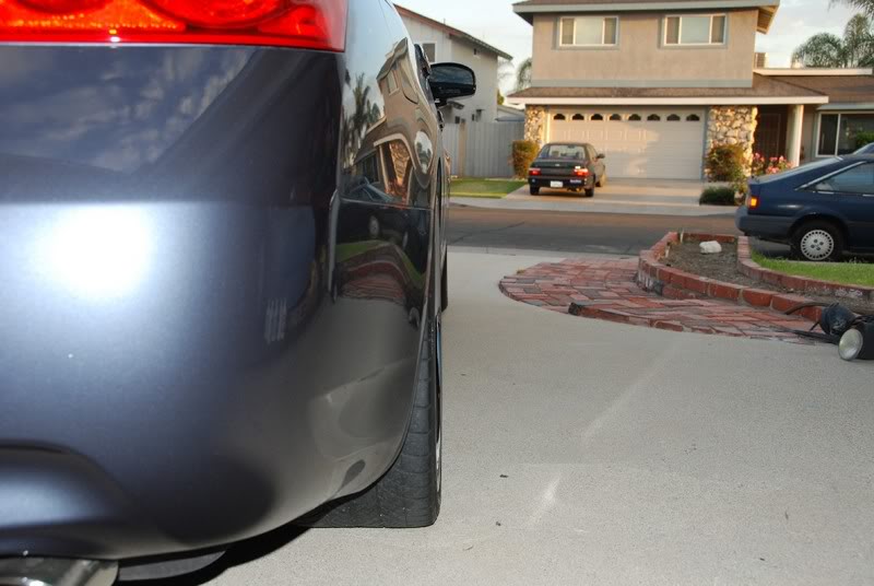

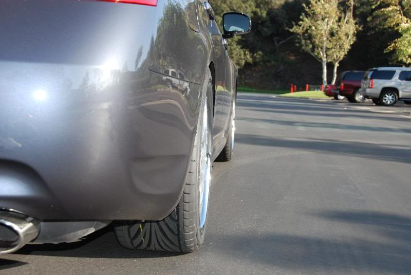

Yes, tread width varies. Some pic from another thread:
Michellin PS2:
Toyo T1R:
PS2 tread width > T1R tread width

I don't think you can determine treadwith by looking at the manufacturer specs.
The pics that Terry posted are of a 285/30/20 tire. According to Toyo's fitment guide, the T1R's "overall width" in that size is 11.4" wide. However, according to Tirerack, the PS2's "section width" in that same size is 11.0" wide. Both tires are mounted on 10.0" rims for reference. I think "overall width" and "section width" mean the same thing here (i.e. the distance from sidewall to sidewall when inflated). Difference in treadwidth can be definitely be accounted to how much of a rounded shoulder the tire has. The "width" specs that the manufacturers post are something different.
So Terry, do your T1R's really bulge out 0.4" more than the PS2's when measured at the sidewalls?

I didn't take actual measurements. I just knew from previous posts that PS2's have one of the widest tread patterns which is why I tested my wheel offsets with them to check for rubbing. From the pictures above, one can see the side wall "bulges" are about the same, but the tread patterns are noticeably wider on the PS2's.
