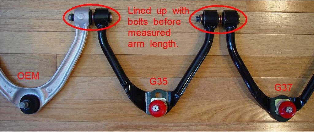

The problems were related to the G37 arms. These are the same arms that anyone with an 07-08 sedan would be using. The current solution is to add spacers (urethane washers) to increase the bump stop (not ideal in my opinion), or go with the G35 arms (these would be for 07-08 sedan).
The problem is the upper part of the arms extend too far out on the G37. This is done to increase the adjustment range on the camber setting, but it also means on the newer sedans and coupes it interferes with the inside of the fender. This only happens at full compression of the front suspension, but seems to happen on most cars. I can tell you now, the part that is currently out will not be the final release of this part. One of three things will happen: 1) they will re-design it altogether, 2) they will make the washers/bump stop kits part of the release, or 3) they will make the G35 arms the official arms to use.
With the above said, it sounds like they are going to go the G35 arm route. These have the shorter top part of the arm where the "knuckle" mounts to the A-arm. Now let me ask this.... If the G35 arm is really the right arm to use, then why did they spend the time designing the A-arm in the first place? I have to say, I think the people that are buying this now are asking for issues (this goes for the G37 arms). SPC does this a lot, and the same thing happened on the first release of the G35 A-arms. They are going to need some time to work things out, but the current arm is not an ideal solution unless you like the banging and clunking sound of the A-arm hitting your fender.

Here is a link to the thread that discusses these issues:
http://myg37.com/forums/brakes-and-s...it-rattle.html
Here are some pics of the 3 arms compared to each other....
Just to explain the pictures.... The red "knuckle" is moved up and down to adjust camber. You can see the G37 arm has the most positive camber adjustment (in the down direction), and you loose a lot of that with the G35 arm. According to one of the posts in the thread, they maxed out at -0.9 degrees in the positive direction.

The G37 coupe arms are NOT the same ones that are for the G35 07+ sedan. The kit numbers are different. As far as I know, none of us with G35 07+ sedans have had any problems with our kits. The G37 coupe guys then used our arms but there is still a problem if more positive camber is needed.
