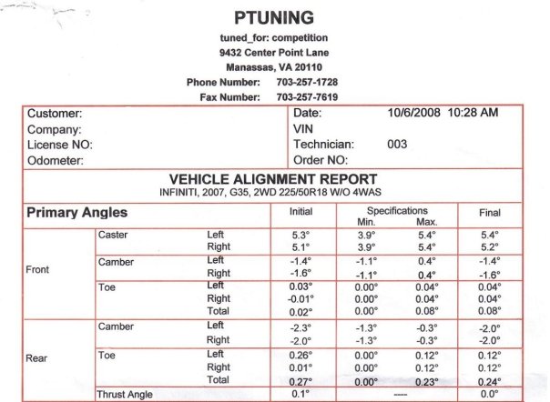

hey, thanks for replying!
i know a lot of guys focus on camber because it can really have a stong effect on cornering. an on toe because it's easy for the shop to adjust the tie rod ends.
but, i've read a few posts from owners saying their car felt squirrely or unstable under different highway conditions. being a noob, i'm not sure what caster adjustments are possible on our cars, but the alignment sheet below seems to show that some adjustment is possible. (it is for a g35 w/ 4was, i couldn't find one without)
caster is essentially an adjustment for straightline steering stability. it uses the weight of the front of the car to force the front wheels into a straight ahead position. more caster equals slightly more force needed to turn the steering wheel but more tendency for the vehicles front wheels to return to center.
caster can be tricky to set up correctly and some shops who don't know how to do it will try to convince you to leave it alone. they "set the toe and let it go" essentially stealing from you by not doing a complete alignment. or they try to achieve the same thing by dialing in more toe which wears tires more quickly. i do know the hunter machines contain complex software that helps a tech adjust caster (and resulting change in camber) more easily if they are trained and know how to use it. i don't know about other types of machines.
anyway, i do feel that getting the most out your car means trying to use all the adjustments available to tune it to your driving style. hopefully we can get a good thread on alignment options going here.
amp

here's another alignment sheet i found from a differnt user.
djwishuwur, if you see this, would you post up your results in driving after they did the alignment? were you happy? tire wear? performance? etc....
thanks!
amp

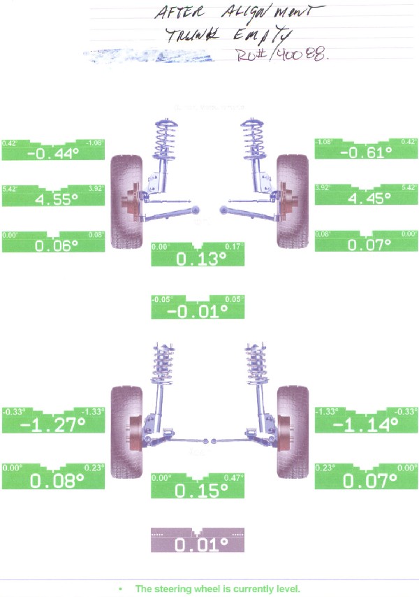

ok, finally got into the dealer for an alignment yesterday. posted up the scans. they did three different readouts for us.
first, car before anything done with trunk full.
second, car before anything done with trunk empty. yes, it actually made that much difference. how much crap did i have in the trunk? well, not all that much, actually. my wife and 21 month old had driven to missouri from kansas so we had a couple of suitcases, laptop, stroller, etc. i'm guessing no more than 100 lbs. just that much weight changed the rear camber setting more negative by about 27%! enough to make the difference between being in spec and being out of spec.
third printout is after alignment trunk still empty.
i was getting some outside tire wear with cupping on the inside of the passenger tire. this is most likely because the toe was actually negative on the passenger side. corrected, it is now positive on both sides and roughly equal. this is the lack of tension i mentioned i felt in previous post. the car was squirrely and would get tossed around a bit on uneven pavement on secondary roads. this is mostly gone now.
the service writer guy told me some interesting things. said almost every G he has ever had in has some cupping. also said the bridgestones are the worst about doing it and the loudest when cupped. i definitely have this. said the michelins (at a mere $280 a pop) were the best about being quiet with a little cupping and that most customers were happiest with the michelin tires. take that for what it is worth.
i was getting some inside tire wear on the rears. they asked me what i wanted them to do. i said do what you would do if it was your car. they left it alone. i'm not real thrilled that they didn't even up the negative camber on the rear, but i didn't really have a leg to stand on. the guy with 15 years experience did what he thought was best, so the guy with one month experience (me) shut up and sat on his hands. after i figure out what i want to do with the rims and get new tires, i'll probably go back and get it set a little better.
right now, just fixing the toe improved the car's driveability a vast amount. it tracks down the interstate and feels solid. i didn't get a chance to drive it fast on the curves as it was raining the whole time i was there and the tires are mostly shot. next time i'll have more fun!
for now, next step is to get rims figured out and get new rubber.
hope that helps!
amp
