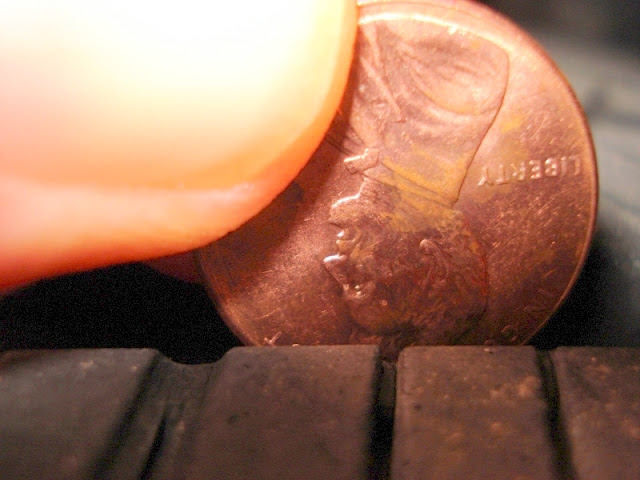

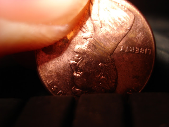

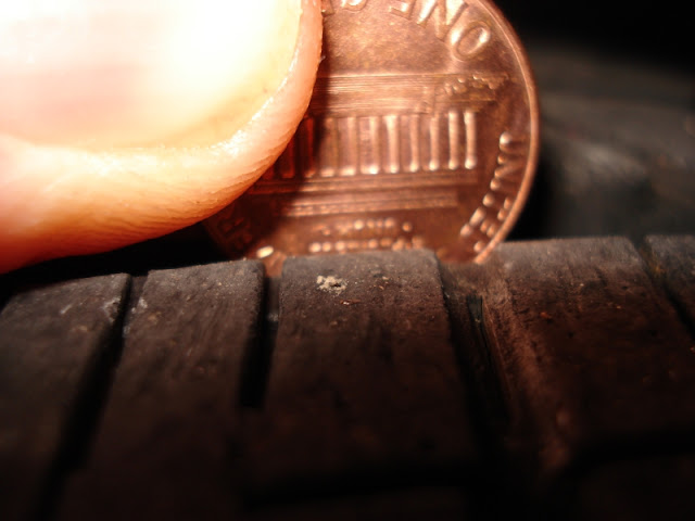

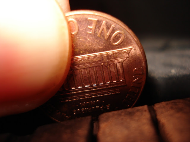

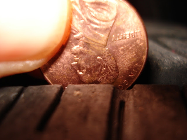

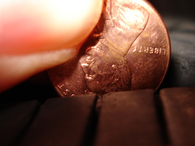

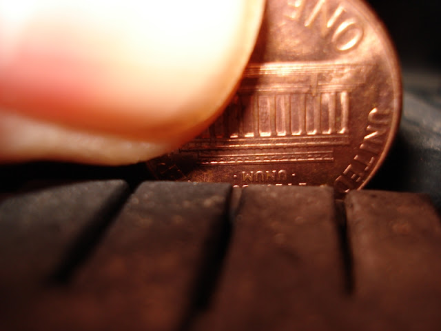

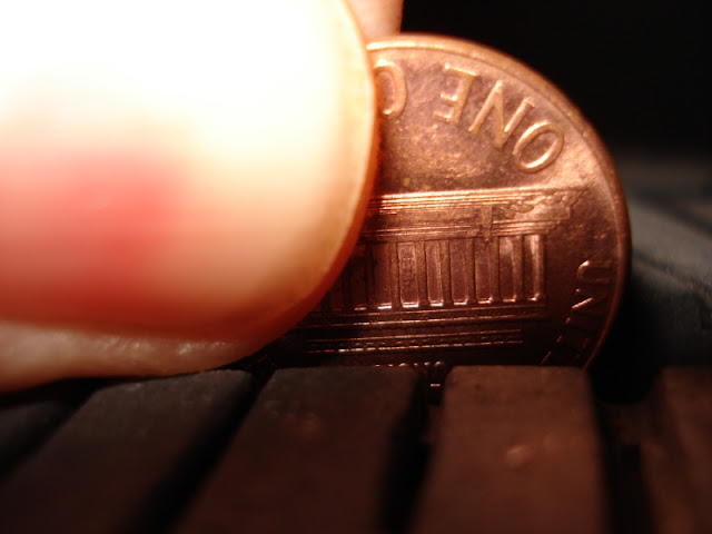

Can someone help interpret my tread pics?
Apologies if I messed up these pics, but I am out of my league here and cant really intrepret these...are these pics good enough to determine if my tires are 'worn'?
LEFT FRONT PIC 1
LEFT FRONT PIC 2
LEFT REAR PIC 1
LEFT REAR PIC 2
RIGHT FRONT PIC 1
RIGHT FRONT PIC 2
RIGHT REAR PIC 1
RIGHT REAR PIC 2

Imo... i would run those a LONG time yet....

Hey what's with the American Penny? You're Canadian eh?
I have the same crappy tires on my car...and I have 33,000 km on it and the tires have less tread then your tires...no way I can go through winter with those...so I picked up a set of winter rim and tires of someone here on Kijiji....and I can run my tires for one more summer before they're toast.

Ya, I used the american penny as a reference point for the guide posted on http://www.tirerack.com/tires/tirete....jsp?techid=51
I would have concluded from my pics all the tires were indeed worn (except right rear which got replaced a year ago) , but perhaps there is still plenty of tread to go.
Point is of course that its a long crappy way to go!

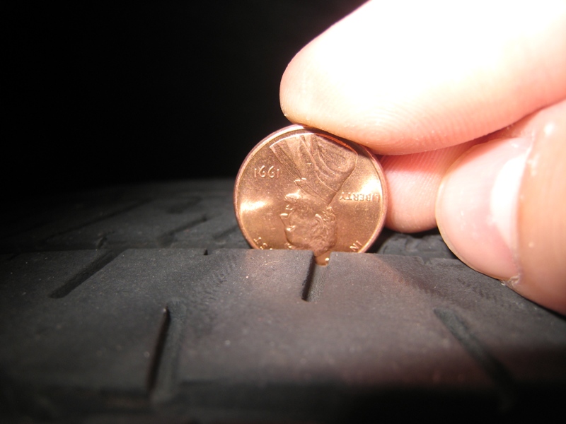

These are EAGLE RSA tires as well, Front Right tire,According to my Tread Gauge this is about 4.75/32nd tread. Once it reaches 2 thats the minimum for insurance, so once it hits 3 you should start looking for replacements, your pics show you got a bit more tread then I do, so you could be at 5-6/32nds

Ugg, I just read through that, and heck yea, I am in that hard rubber part of the tire lol, it sux. In the wet it breaks loose so easy.
