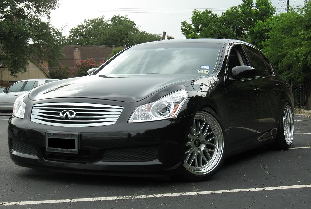

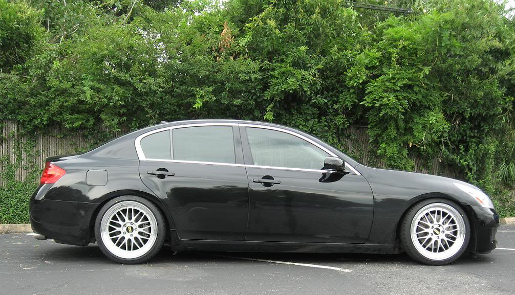

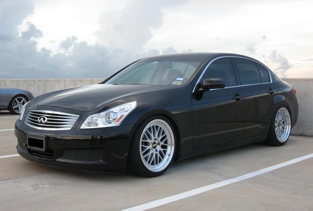

My G is black also, and I was planning on getting these wheels. Now I know what they'll look like on my ride..
QUESTION..
does your VDC kick in for having a tire that is over 3%, since 245/35 is smaller than oem?
when I first read your offsets, I was thinking.. Humm he has replicas. I scroll down and see that you do have BBS replicas.
QUESTION..
QUESTION..
Aww..you caught me
yeah they are Chikara LS1 wheels very nice btw. Using the G35/37 coupe offsets on our sedan gives that aggressive fitment. I get a lot of compliments and head turners on the road.VDC works fine no issues. TPMS were simply swapped on the new wheels and did not require re-programming either.
