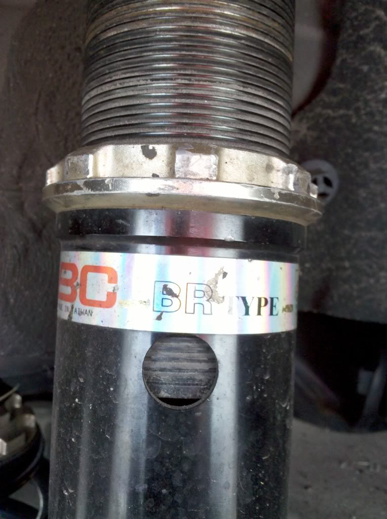

As you can see here: there is a little gap near the hole where you can see threading of the strut. Right underneath the BR logo on the strut.

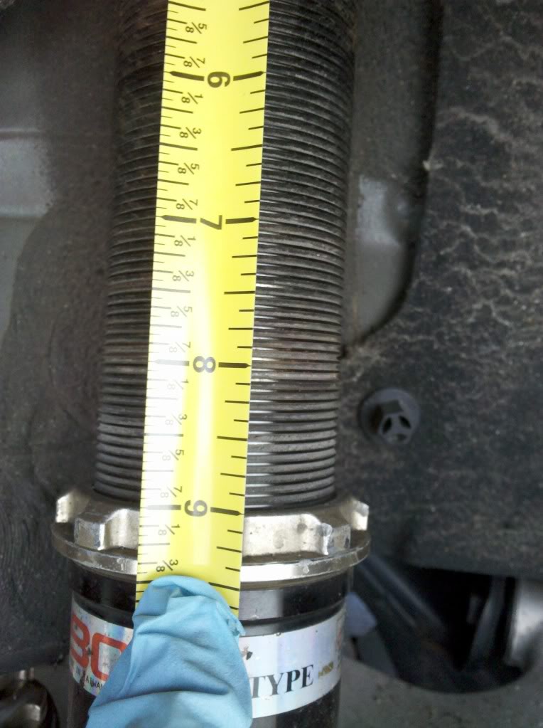

Here are the measurements of the rear:
Top of threading taken from the top of the metal piece right above the threading all the way down to the top of the lock ring of the strut. 9 inches:

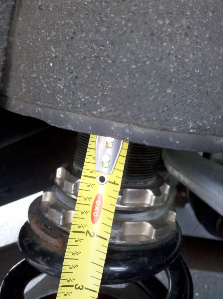

Spring perch measurements: taken from the top of the inside of the spring perch (black plastic piece) down to the lowest part of the lower adjustment ring. - 2 1/8" inches
Does this look right? I'm still not sure if I have to redo the pre-loading aspect of the rear spring?

Here's what i understand and can recall about the rears, based on what Pete from BC told me before.
You use the spring perch to adjust the height, then follow-up with the strut by either:
a) With minimal load on the spring bucket (i.e. jack it up just enough to keep the spring taut), match the holes up between the bucket and the bottom strut mount holes - this is zero pre-load
b) If you want to pre-load the springs, jack the bucket further (mine is by 5mm, or roughly half the hole is now covered up by nature of the bucket being higher than the strut). Then, shorten the strut assembly by the same amount until you match the holes up again.
It's been a while, but i think that's the gist of it.
