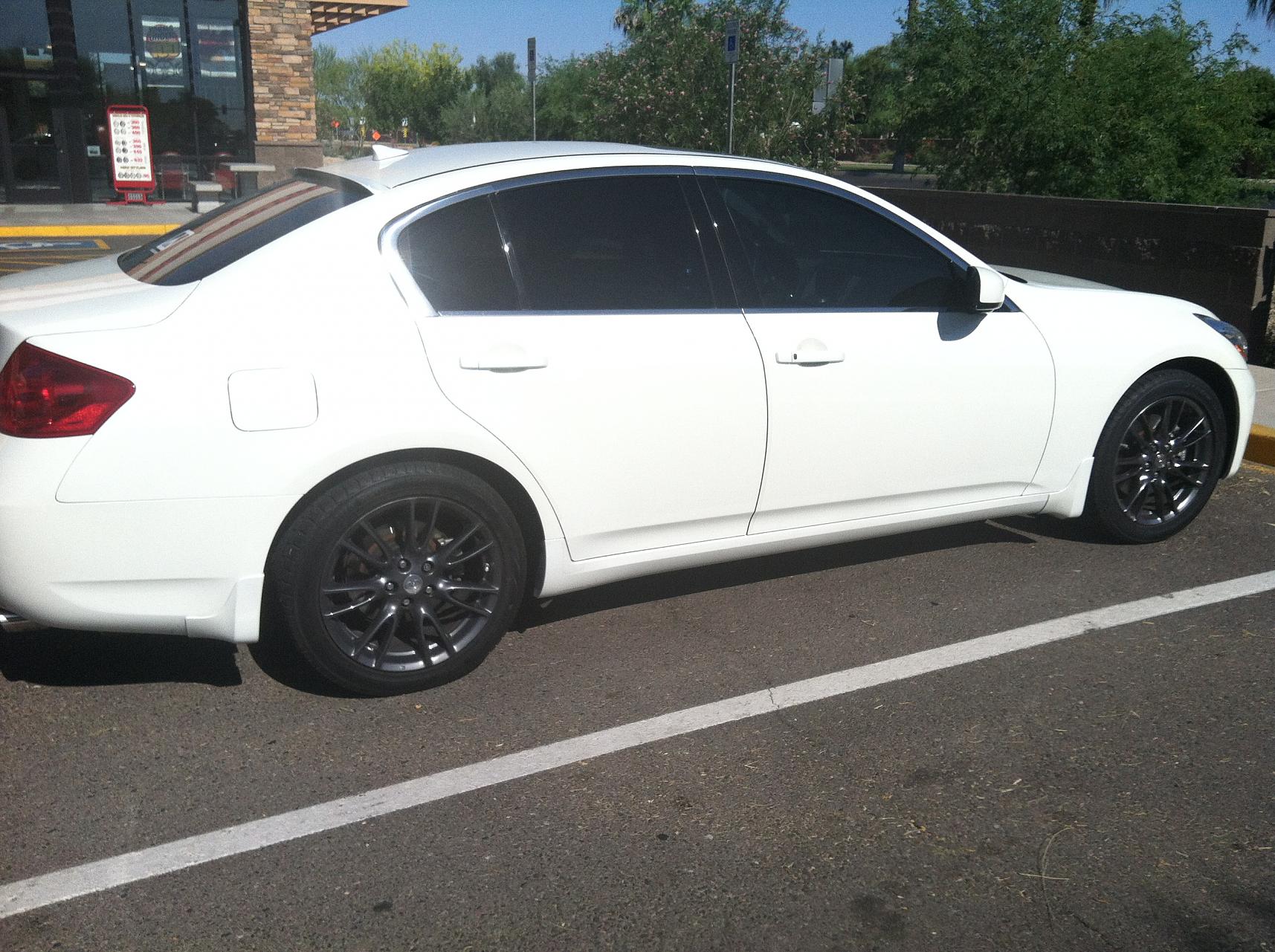

I have OEM sport 18" wheels in Graphite if your interested in what they look like. I have them for sale as well since I didn't want staggered on my X. The rolling diameter is well within the spec of acceptable, but I wanted the ability to rotate my tires.

I think they are 40 and 45 offset. They are OEM wheels just off the sport model G and 18". Looking to get $500 plus shipping.
Attached Thumbnails offsets to run on a 07 g35x? looking to buy new wheels-g35-001.jpg   offsets to run on a 07 g35x? looking to buy new wheels-g35-002.jpg

Have you considered going with the 19" sport wheels from the G37 coupe? They look awesome on the sedan. They give the car more upgraded / aggressive OEM look and the offset is perfect with a drop on eibach springs. You can still run staggered wheels and keep the same size tires all around like I did.
Here's a thread with some pics.
http://www.myg37.com/forums/g37-seda...g37-sedan.html
