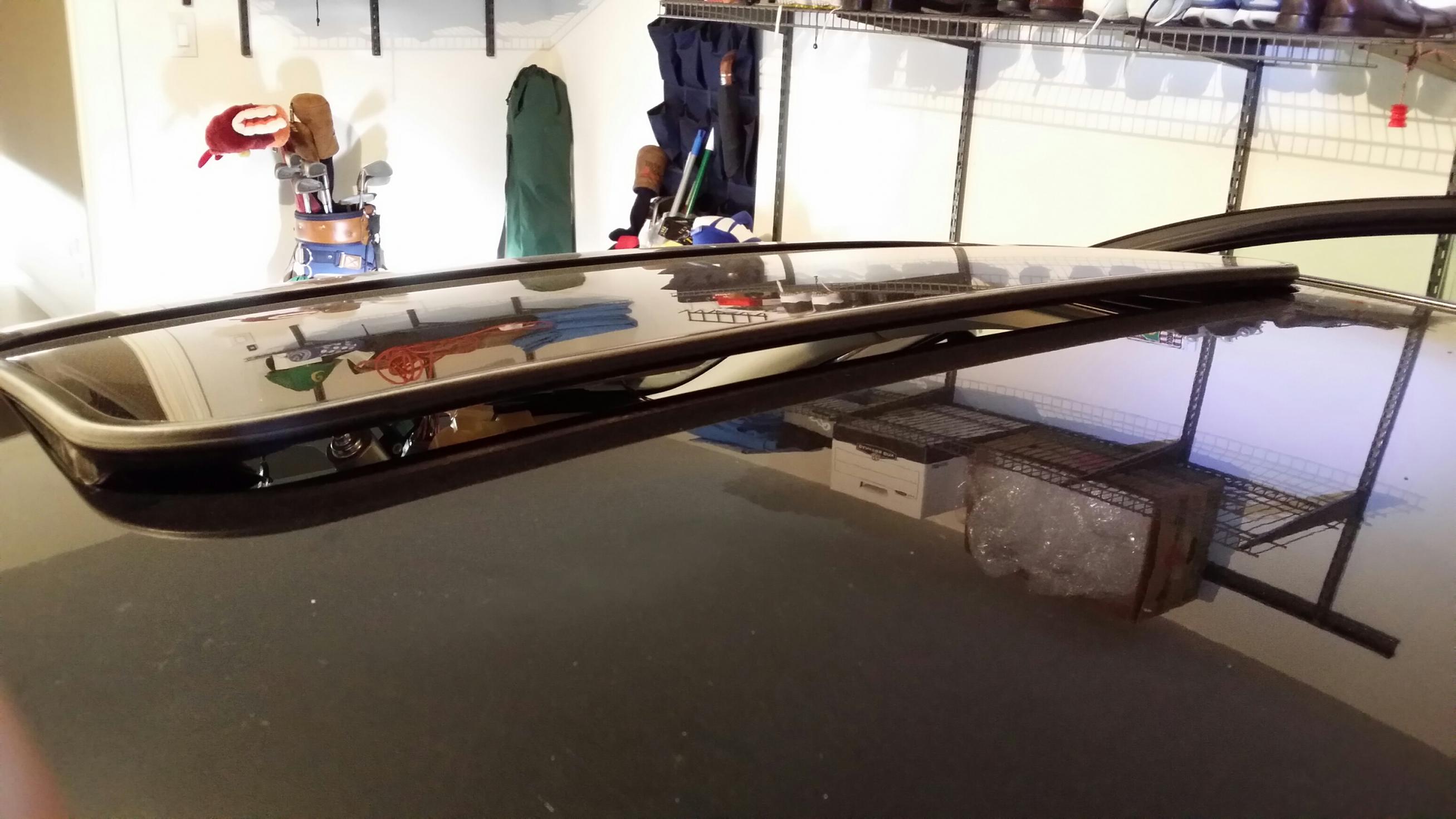

Old Jan 4, 2014 | 10:18 PM
ncitrdude's Avatar
Joined: Jul 2010
Posts: 3
what do I do if one side of the sunroof is crooked after this repair?
After doing this repair, when the sunroof is tilted up, the passenger side is lower than the driver's side (not sure if you can tell from the picture attached). When the sunroof is retracted, the driver's side seals correctly, but the passenger's side is indented about 3/4 of an inch (and obviously doesn't seal correctly).
Is there a way to get this aligned correctly? I removed the motor and I can see the cable that is pushed/pulled by the motor's gear, but it seems impossible to move. Is there an easier way to realign this?

Old Jan 5, 2014 | 01:37 AM
ncitrdude's Avatar
Joined: Jul 2010
Posts: 3
Nevermind, I was able to fix it. Removing all the screws to the motor, you can tilt the motor forwards or backwards so it engages only one of the two cables. Work the motor back and forth using the retract switch until you hit the limit stops for both sides, then do the relearn method as stated in previous posts on this thread.
