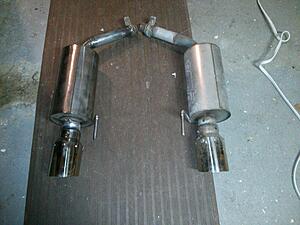

Hey All -
My buddy just sold me his old custom borla exhausts for $100. Figured why not, i'm all stock right now so I'll see how I like these.
Before I mount them, how can I spruce these up a bit? Obviously I can polish the tips with chrome polish, but as for the rest of the muffler, I'm thinking going all black with high temp paint. It's not a pretty exhaust and not a stainless steel "polishable" muffler so figure going all black is fine.
Also the welds are good but looks a bit shoddy. Should I take an angle grinder to them to smooth them out before painting? Worth it?
Any other thoughts?

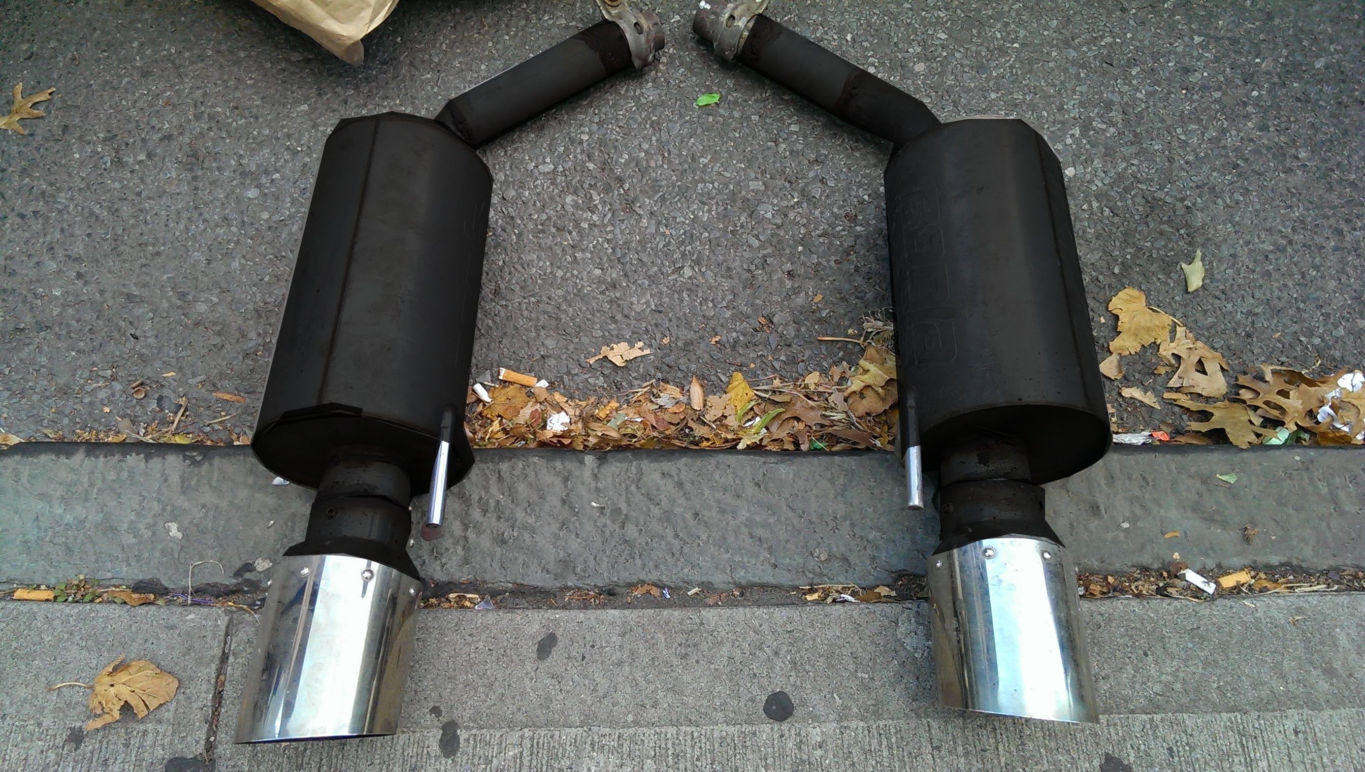

Rough idea of what I hope the final outcome to look like

I think I'd run the paint all the way up until the tips go flat so maybe back another 1.5" or so.
Something like this?
I can dig it

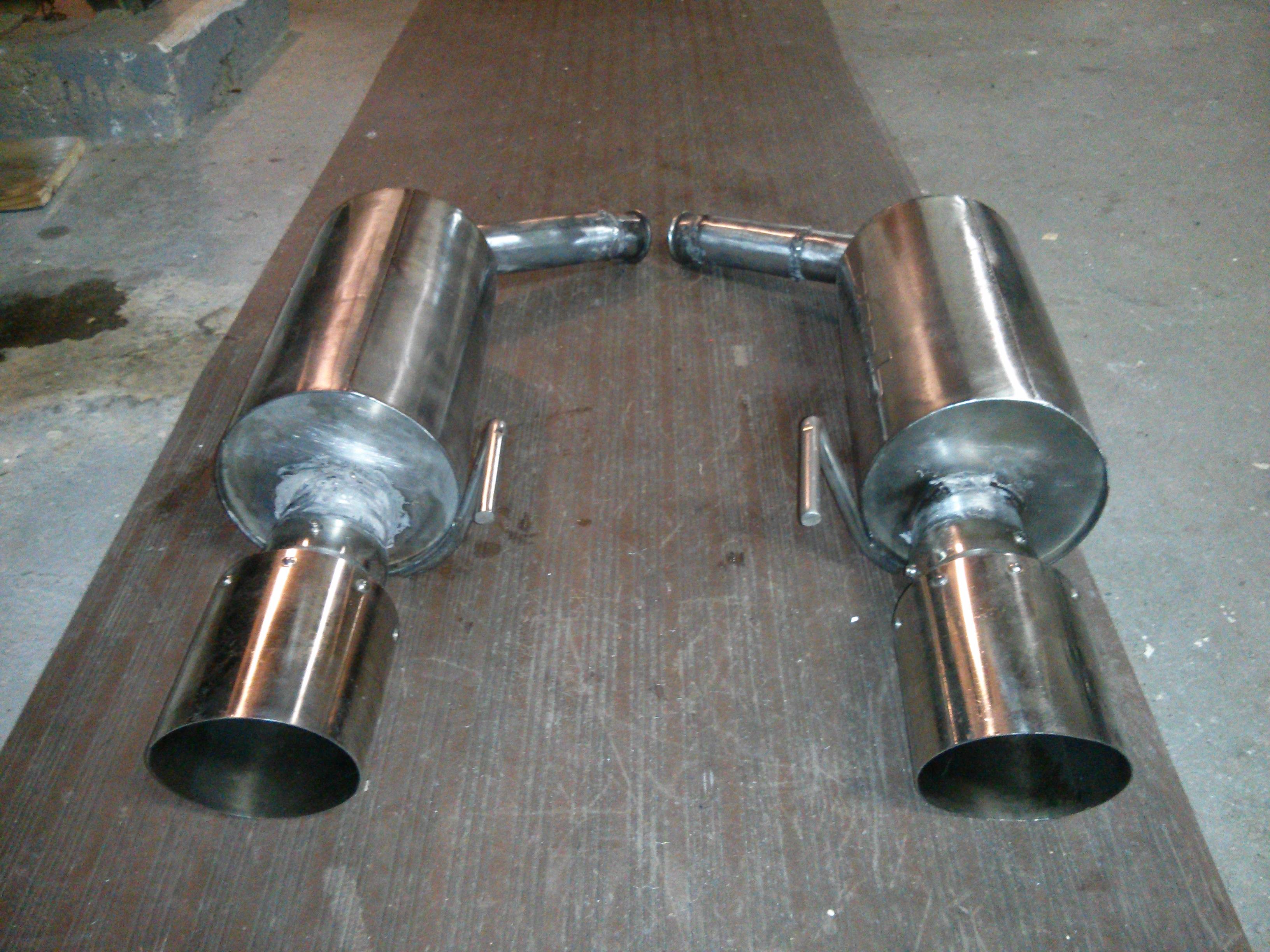

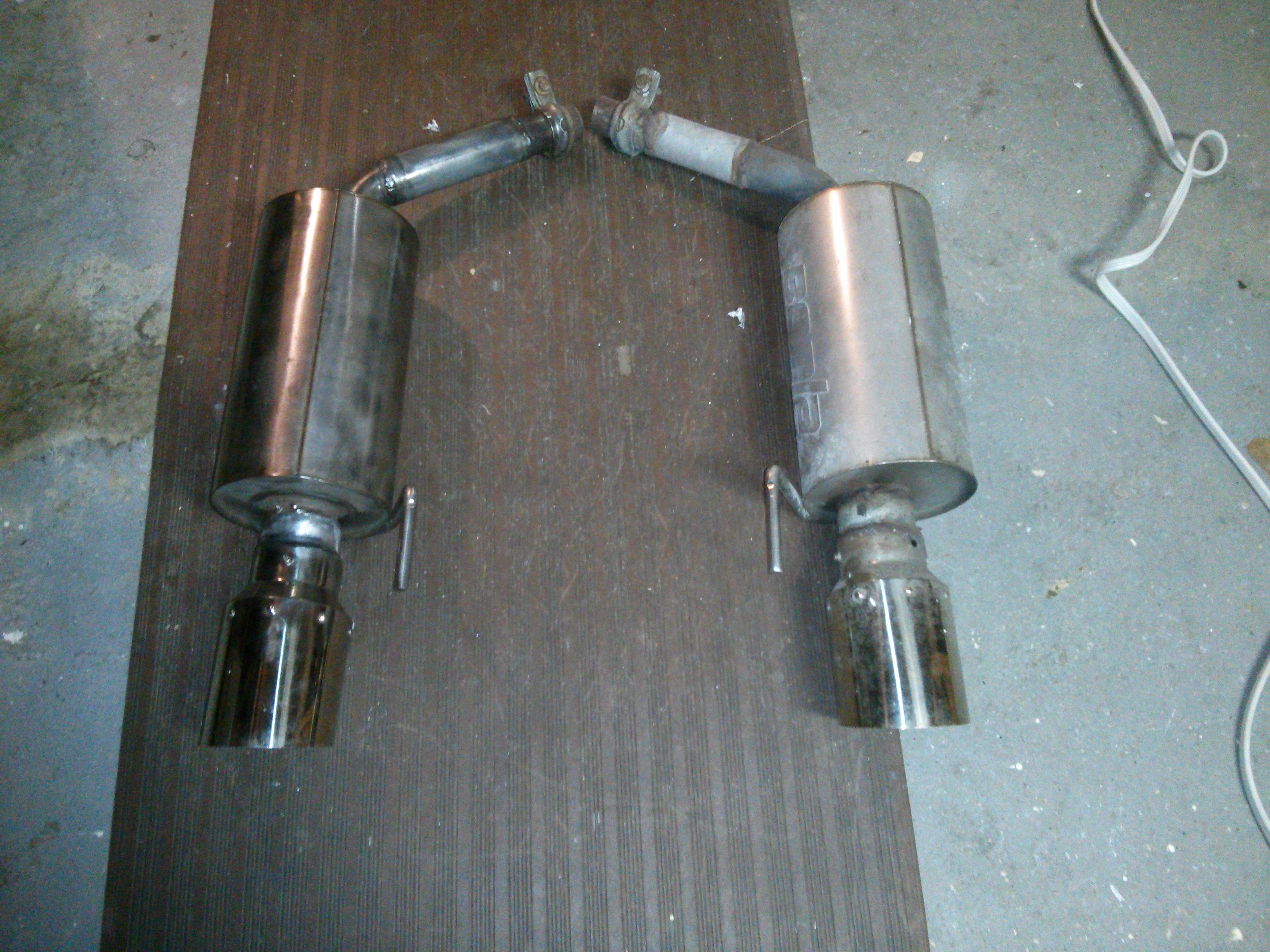

Update:

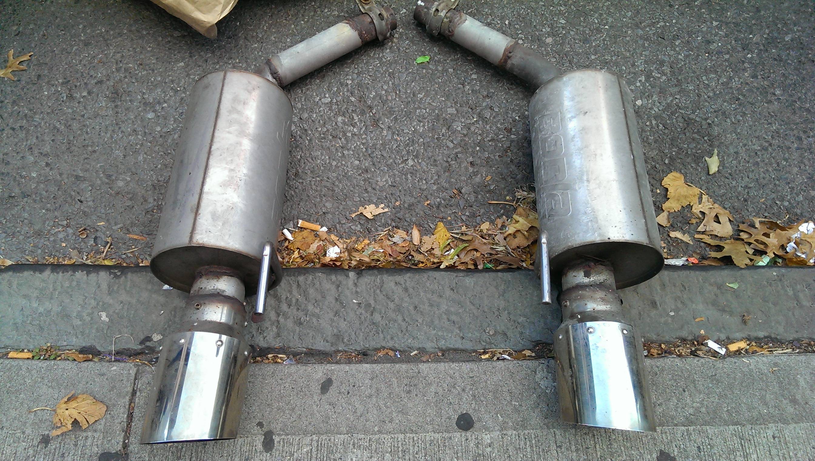

So I had some time today to get them ready for paint. I grabbed a beer and took a wire wheel to them connected to my drill. Amazingly all the rust and weathering came off fairly easily
After = Left
Before = Right

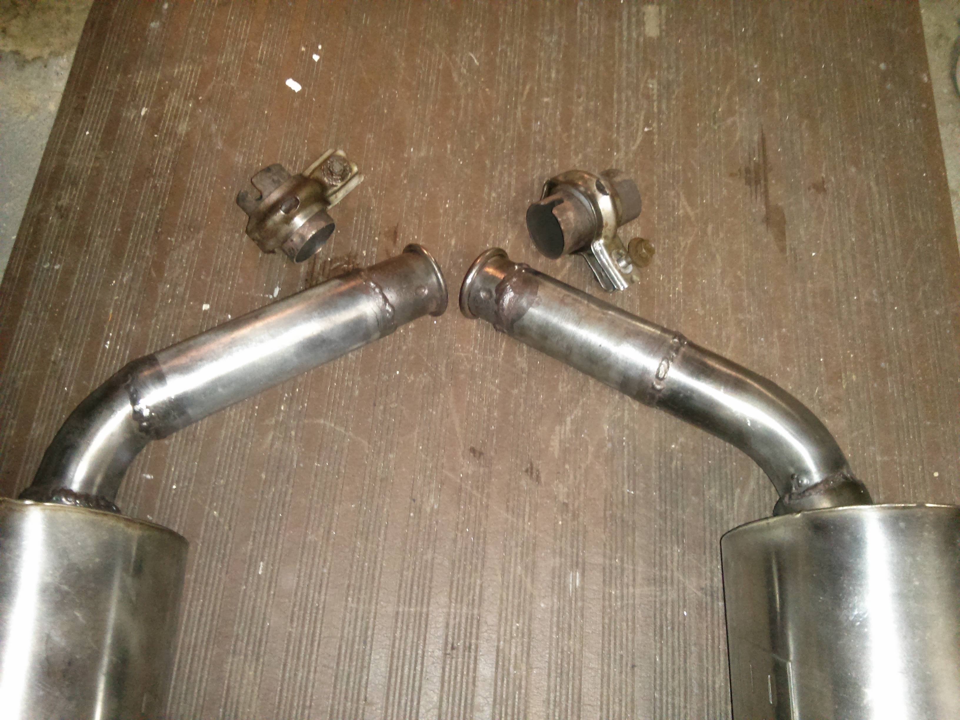

I also removed both OEM clamps after cleaning them up. The previous owners shop cut them in front of the clamps. This will be a nice Bolt on with no welding needed for me

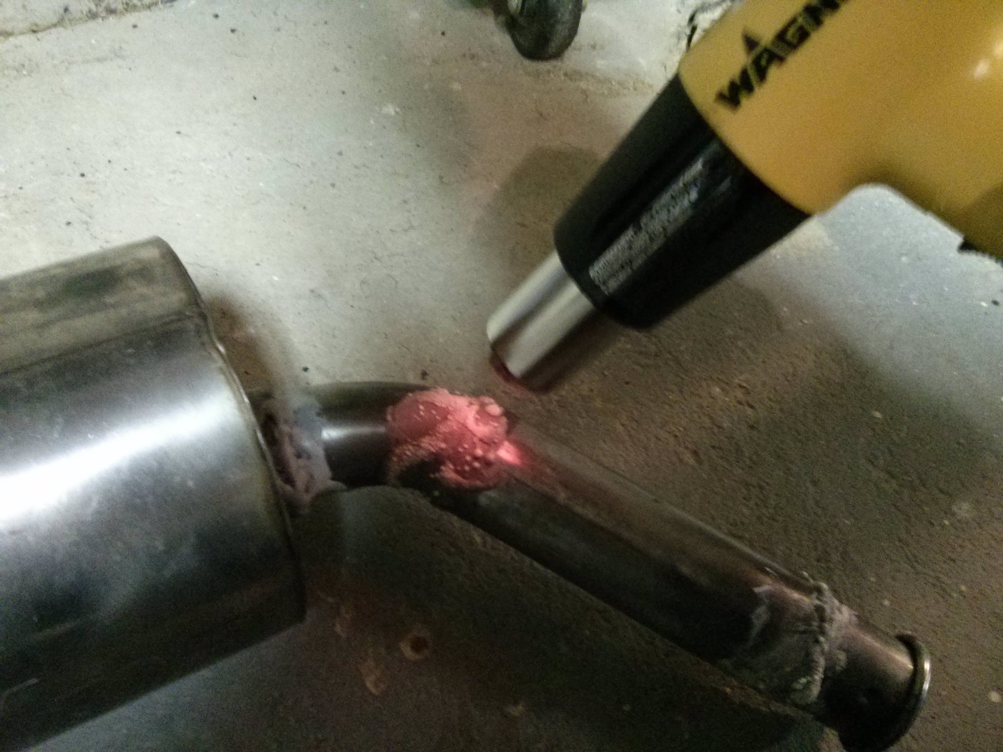

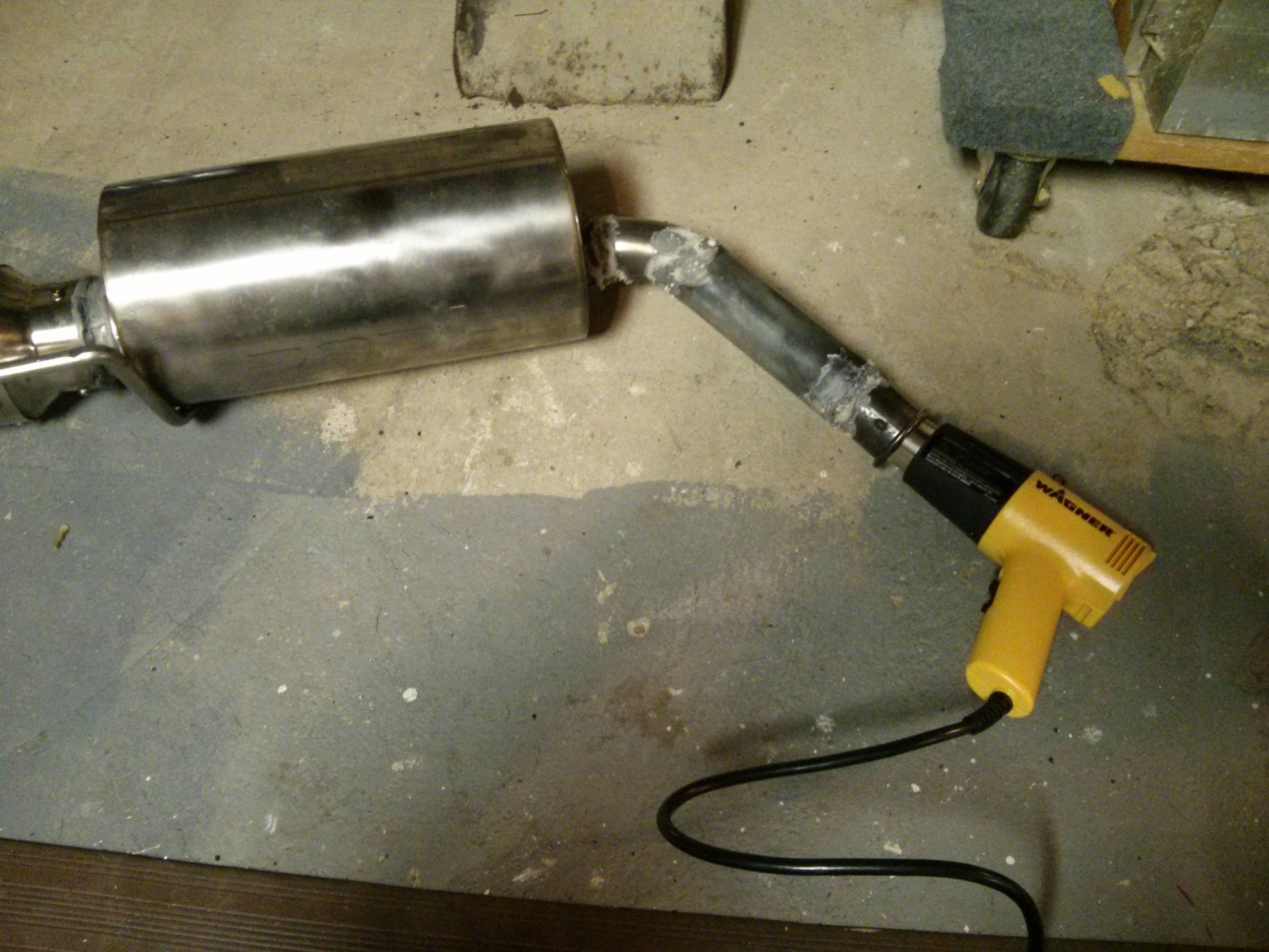

After I cleaned both up, the next step was to use some exhaust sealant on a some of the welds. The welding done by the previous ouwners shop is OK, but there were a few pin sized holes I wanted to seal up so they would be air tight. It was a bit messy but it did the job.
The sealer goes on a bit wet and heat is what cures it. It stated to heat them up while driving, which was hard since they are not mounted, so I improvised and pulled out my trusty heat gun. 700 degrees should do it, and it did! The sealant was as hard as steel after a few minutes of heat on each weld

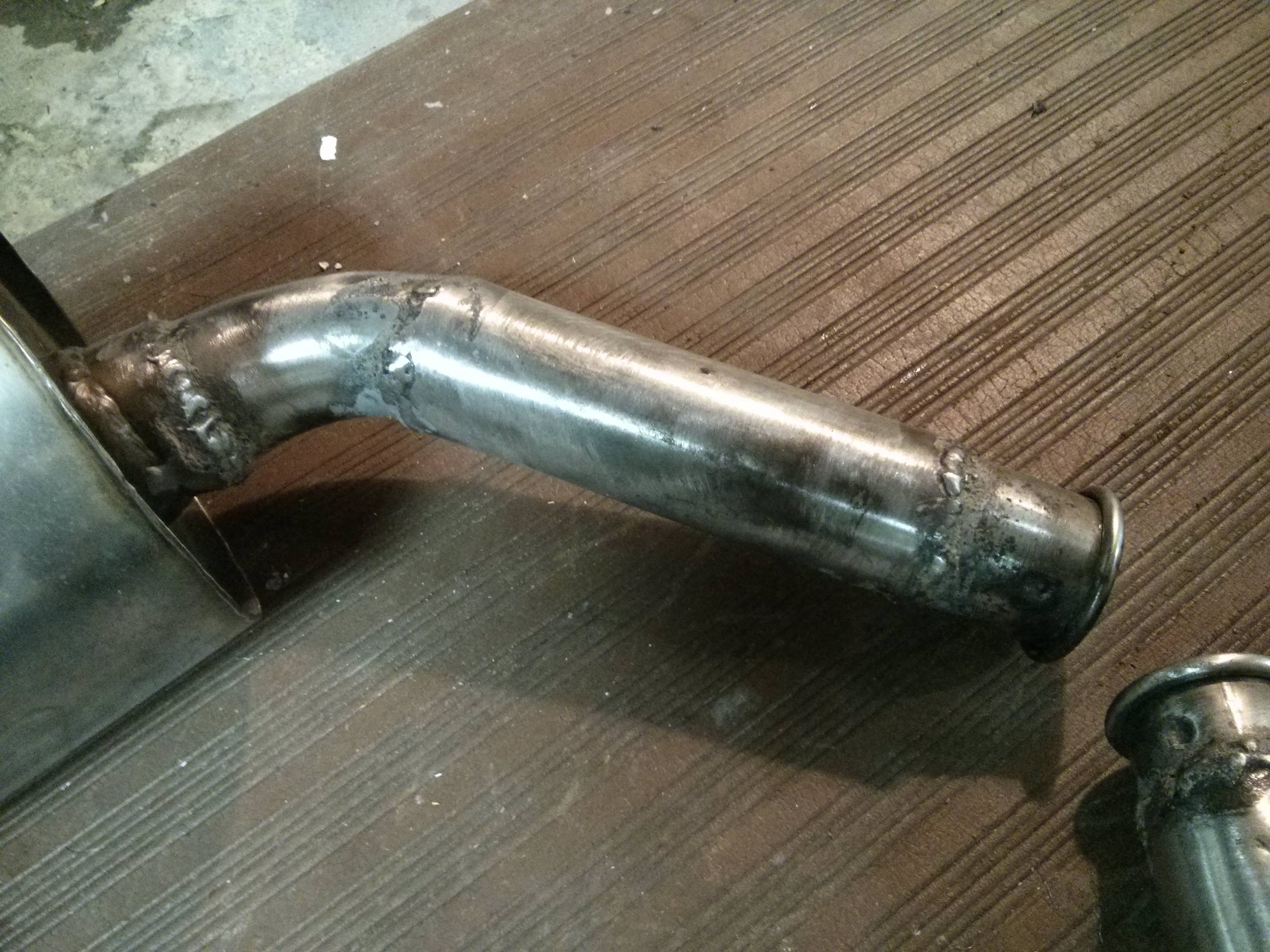

Here they are as they stand now, not bad I think. Ready for paint when I have time, hopefully sometime this weekend.
I'll clean the one on the left up a bit more before painting
