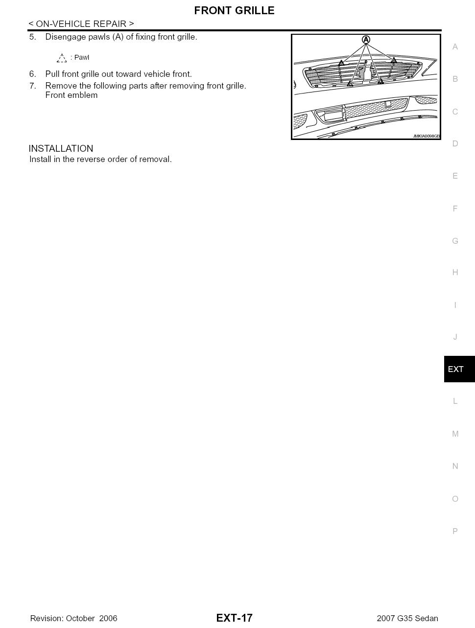

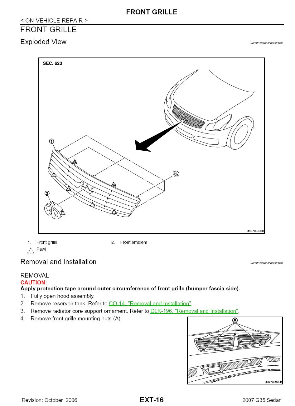

Here you are... If you need any others let me know..
Attached Thumbnails How Do You Remove Front Grille-07g_sedan_front_grill_1.jpg   How Do You Remove Front Grille-07g_sedan_front_grill_2.jpg

Yep, that's right from the Service Manual. I've swapped out the grille and it took no more than 15 minutes. When I do it again in the spring, it will probably take less than that since I know exactly how it's done now.
