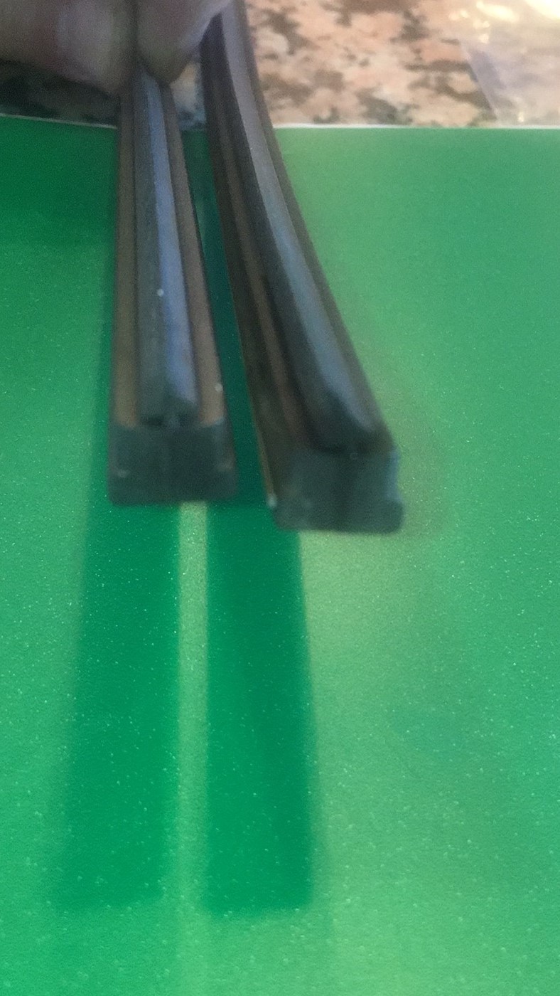

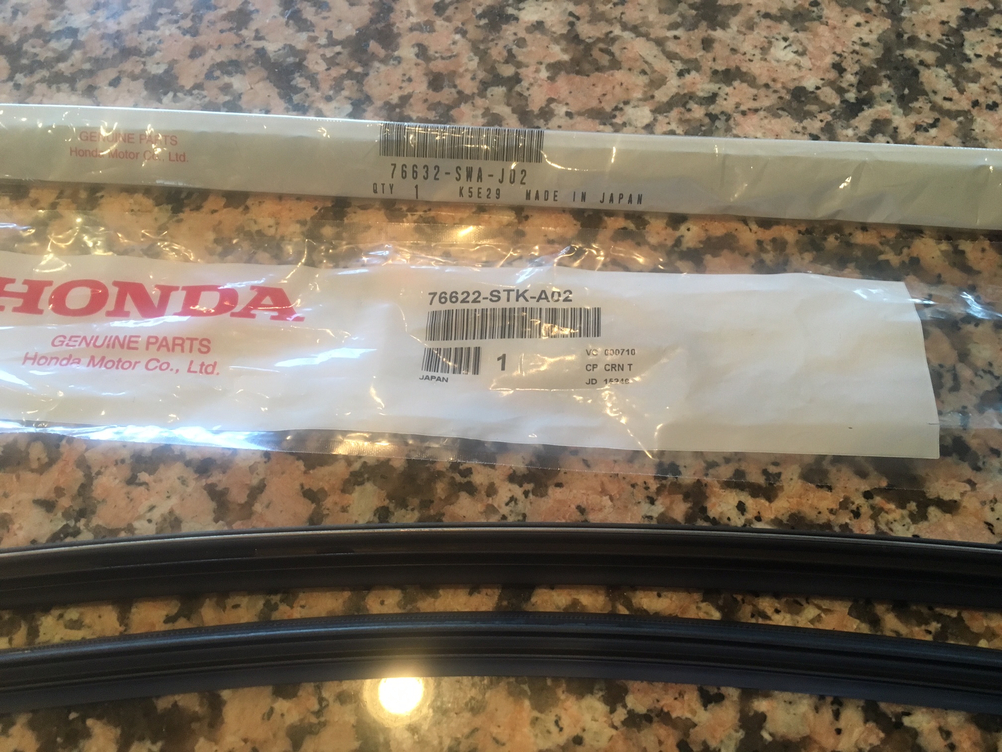

I have a 2011 G37s convertible. My Infiniti dealership said that they don't the stock wiper refills but I found the exact same wipers at the Honda dealership.
Driver side is Honda#76622-STK-A02 (aka Mitsuba MOB2-S2-105 650mm).
Passenger side is Honda#76632-SWA-J02 (aka Mitsuba MOB2-S2-085 425mm).
These OEM wipers seem to last longer than aftermarket ones. Mine have lasted 5 years and probably could go another year or two. Just starting to streak.
Hope someone else benefits from my research.
