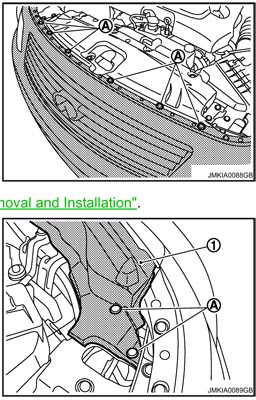

In my quest to change the fog bulbs, I need to remove the front bumper.
I was able to change the driver's side "easily" by removing the wheel liner. On the passenger's side, it's impossible to change the bulb. I read other threads where people were able to change the bulb either by removing the liner or the air filter. Either way, I wasn't able to do so for the passenger's side.
Next, I've tried to remove the bumper. Didn't get far. In the bottom picture where A is pointing to, I managed to break the part of heads of the clips when I used a screwdriver. How do you guys remove these? Do I yank on the plastic seal?
I also managed to crack the radiator core support ornament (top picture). No big deal, but I was still not able to remove it. The service manual says to pull upwards and slide to the rear. There are 2 screws beneath the piece that are blocking me. I yanked hard, cracked the piece slightly and gave up.
Any suggestion about this too?
It's quite cold today (-6 Celsius). Can this be the reason why the plastic pieces are breaking so easily, or I am using too much force?

I changed both of my fog bulbs, then updated the fogs to HIDs and never dropped the bumper. It was all from the top after removing the filters...
I know it doesn't help with your question, but trust me when I tell you it's doable.

I started removing the liner from the wheel well. Got as far as unclipping the cable from the bulb partially. I then ran out of space and wasn't able to unclip the cable completely. Something was blocking it.
I started removing the air filter too. However looking at where the bulb lies, I'd have a hard time making more progress.
I am looking at removing the headlamp assembly to get to the $#@$# bulb.
Anyone with any suggestion with the plastic clips? Maybe I need to use a pair of pliers, remove them forcefully and buy new replacements?
How about the radiator support ornament?
I'll be a shame to give up at this point. I already spent a few hours on this.
