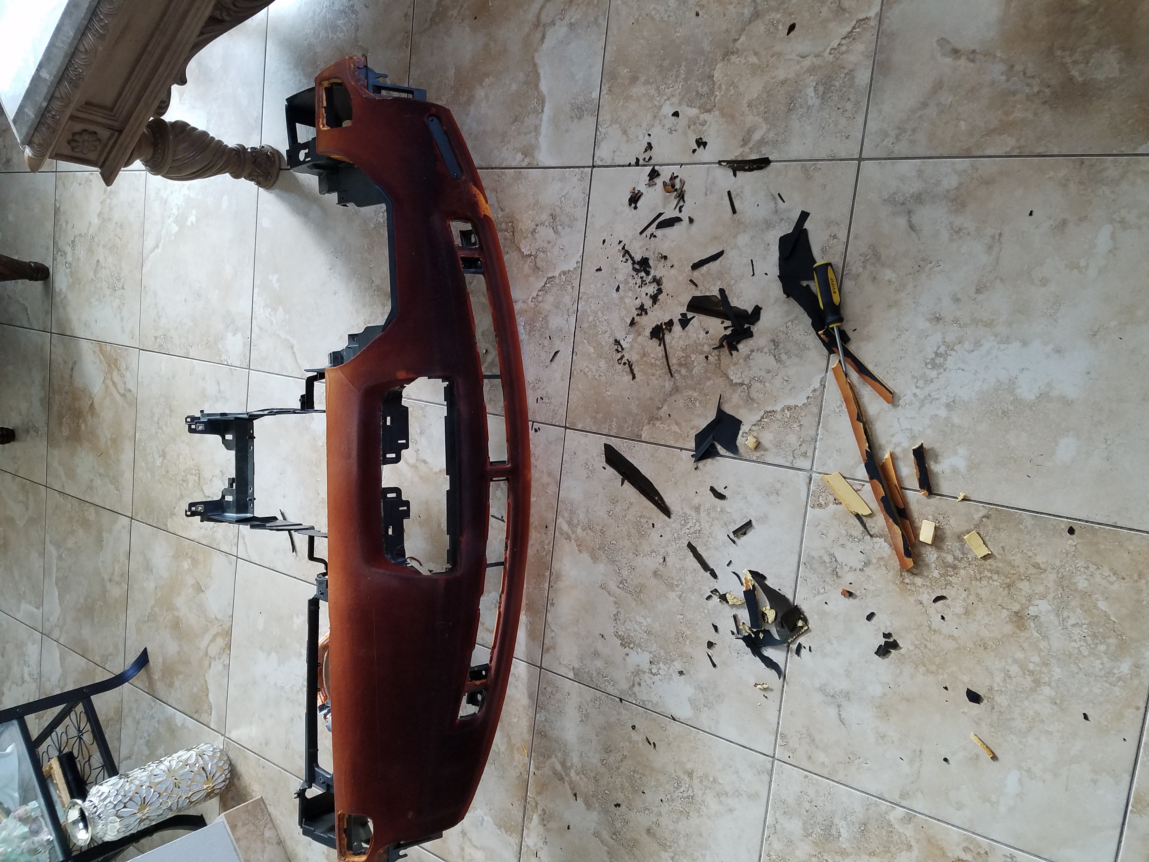

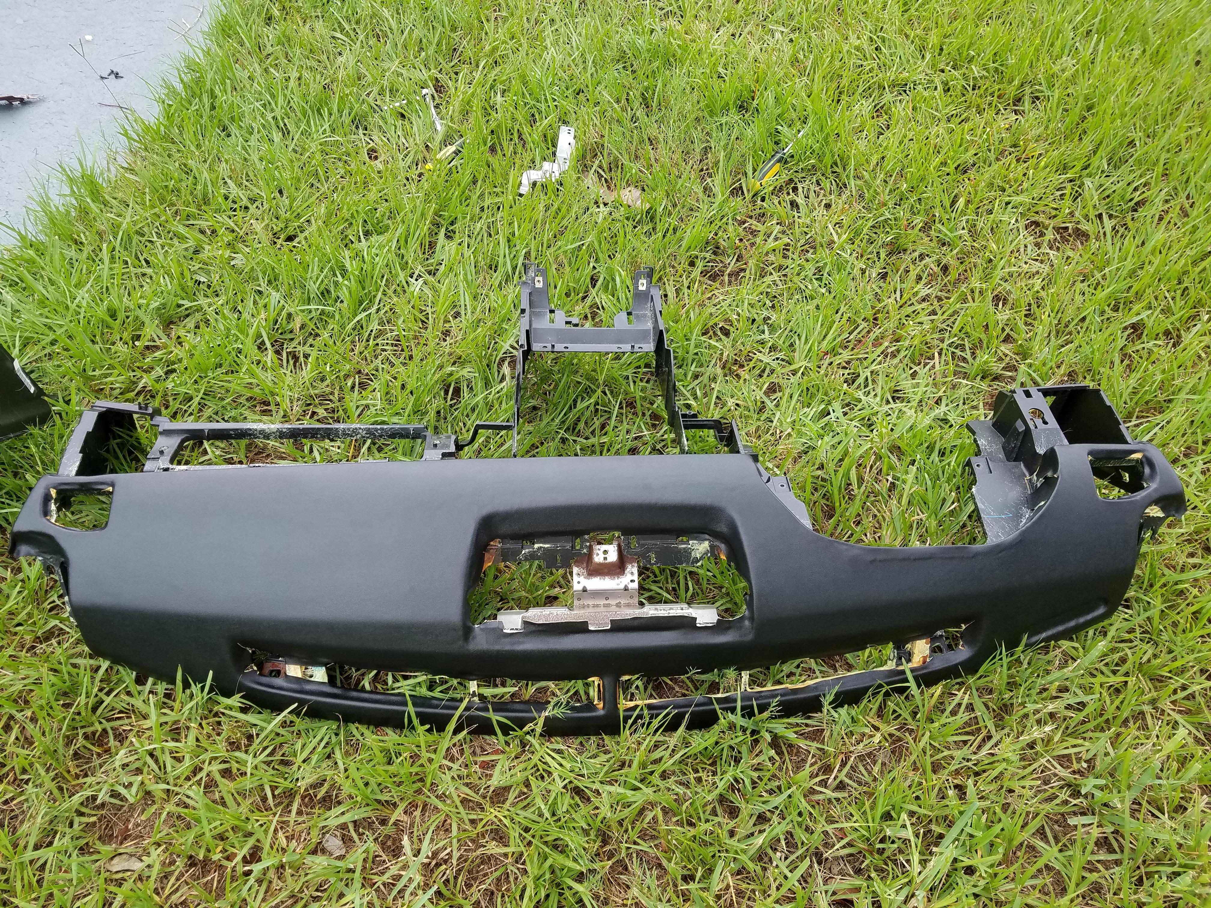

A new dash is close to $1500 after shipping and everything. And that's just for the dash. I'm sure the dealer would charge an arm and a leg to install it also. It's a very long job but follow the FSM and you could knock it out in a day. What I did was pull a damaged dash from a salvage g35 for $100 and removed the vinyl/leather to the foam. Then wrapped the dash in 4 way stretch vinyl using high heat resistant contact cement. Turned out looking like a brand new dash. Took a full day to swap dashes. If you're not familiar with your interior I would say don't attempt it. The most I've was change out all my audio equipment so I was pretty comfortable doing it. Here's a before and after
