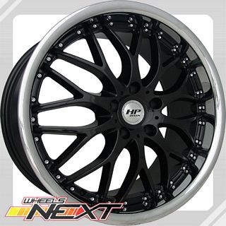

FYI these are the wheels I like, anyone have these on a blk sedan??

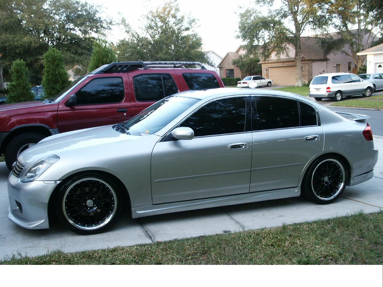

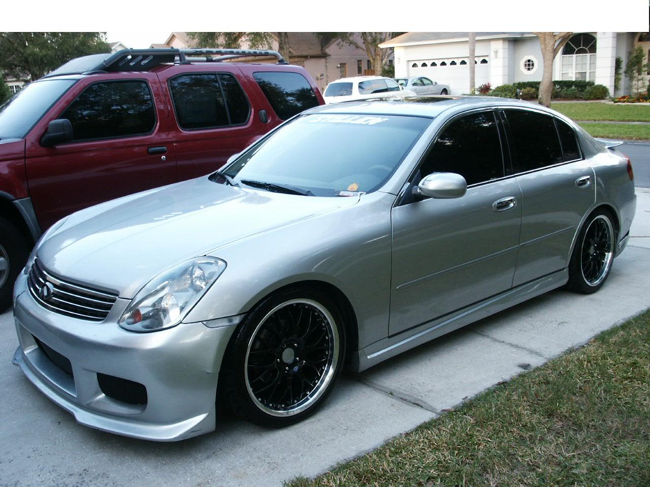

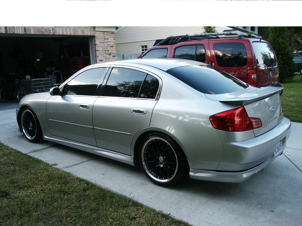

the ones i have are an exact match to the HP EVOs you're looking at. ADRs M Classics. You can check them out at www.bigwheels.net they come in +35 but the 9.5" will not fit in the back properly without rolling fenders. I already asked that question here. Here's a pic of mine. By the way, these have machined polished lips, not chrome. I believe the HP EVOs are the same, polished lip not chrome.
