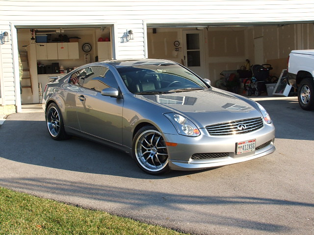

I have the St-1s as well and have the following set up, but not lowered.
245/35/19s front with 20mm offset
275/35/19s rear with 25mm offset
I have no rubbing issues and It moved the outer portion of the rim/tire set up inline with the outermost part of the fender... attached are some pics for your viewing pleasure...19's-thanksgiving-006.jpg

thanks a lot man I really appreiciate your response I would have searched more but I was late for my next class my only question is did that's setup give you that flushed look with the fenders
yes, almost perfect. my only concern is with the tires... I only wish my first choice (high preformance all seasons from michilin) were in stock, cause then I wouldnt have to take them off in the winter (ohio). but the bfgoodrich kdwv2 look excellent, and besides, how often do you get comments about a tread designs on a car like this? its all in the details.
