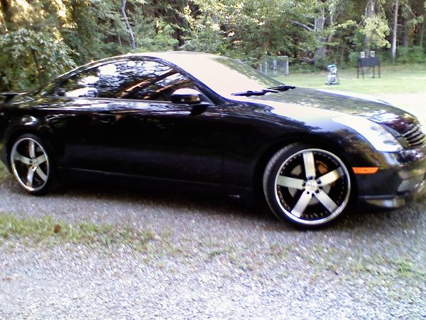

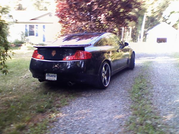

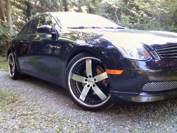

problem with the vdc
I just put on my 20x9.5 w/245/35s, and my 20x11 w275/35s, the slip light comes up on the dash and cuts power to the wheels, ive been just turnin the trac-control off when i start it up, but I was wondering if it is the wheels or not, and if theres any tricks to cure it without switchin my wheel tire combo.
Attached Thumbnails Anyone run 245-35-19 and 285-35-19 with any problems?-gt2.jpg   Anyone run 245-35-19 and 285-35-19 with any problems?-gt5.jpg   Anyone run 245-35-19 and 285-35-19 with any problems?-gt4.jpg
Old Aug 7, 2008 | 06:18 PM
redlude97's Avatar
iTrader: (25)
Joined: Feb 2006
Posts: 1,911
From: Seattle, WA
both your front and rear tires are way too tall which is probably the problem. You should be running 245/30/20 and 275/30/20.
Old Aug 7, 2008 | 06:35 PM
Don@TireOption's Avatar
iTrader: (62)
Posts: 2,014
From: Houston,TX for Best Pricing
You can also run 245/35/20 up front and 275/30/20 without a problem. Although 245/30/20 up front will be closer in spec.
Old Aug 7, 2008 | 06:40 PM
redlude97's Avatar
iTrader: (25)
Joined: Feb 2006
Posts: 1,911
From: Seattle, WA
this is always a bad idea IMO, it shifts the weight balance of the car around and actually makes the front tire a hair taller than the rear. In terms of handling balance this can have negative effects. I still never understand anyone's justification for this, when no one ever recommends running 245/40/19 in the front of a coupe.
