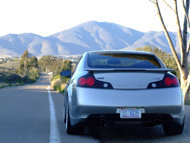

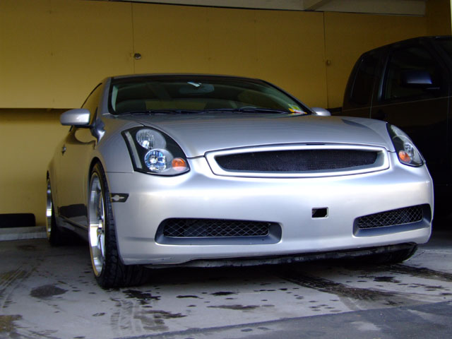

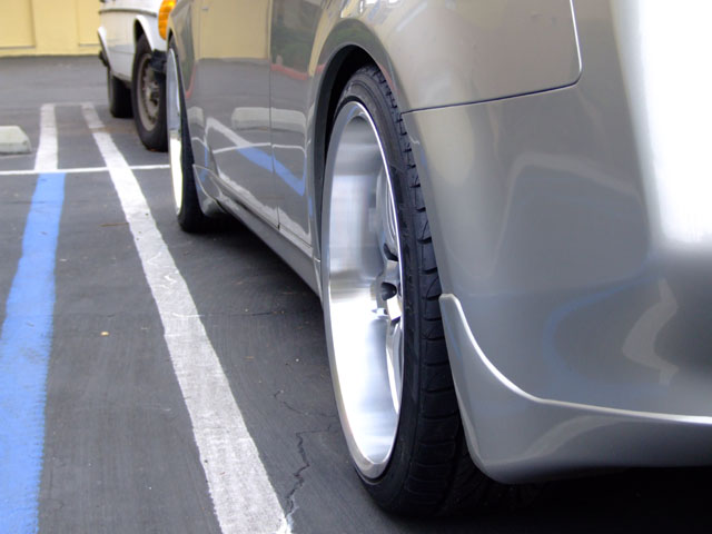

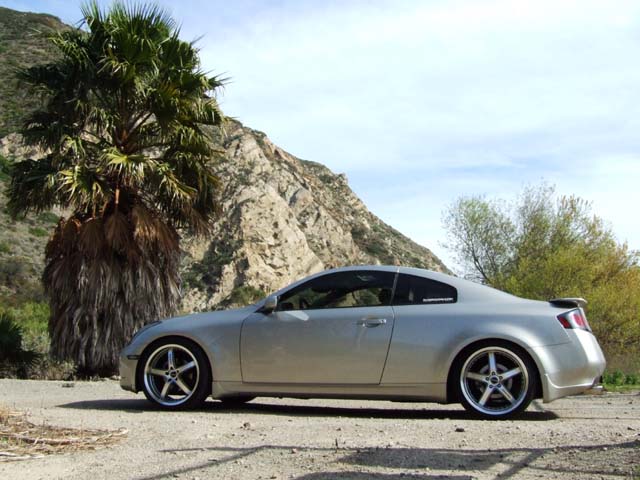

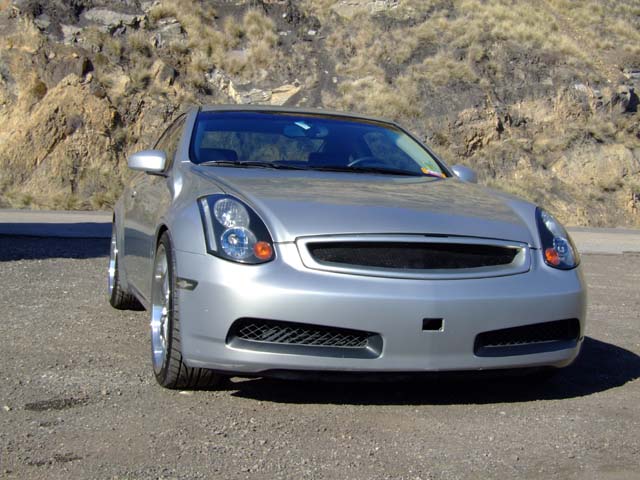

Works great for me - the +15 offset is great man. Best decision I made with this car so far.
The front doesn't stick out at all - pretty much sits flush with the fender. Will try to take better pics but these are what I have for now. Hope this helps.

that looks to be a good offset

Is that a 15mm offset for the rear too?

Offset is based on wheel width.
The typical Volk 9.5" front is +22 or +17
The Shine 9" +15 front is 1mm more than the 9.5" +22 and 4mm less 9.5" +17.

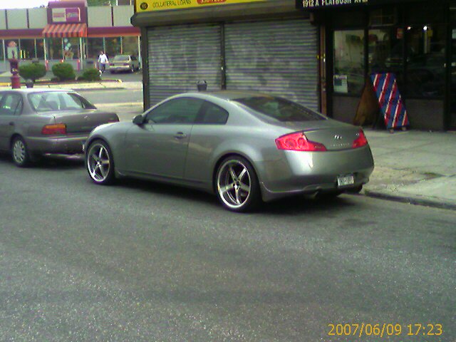

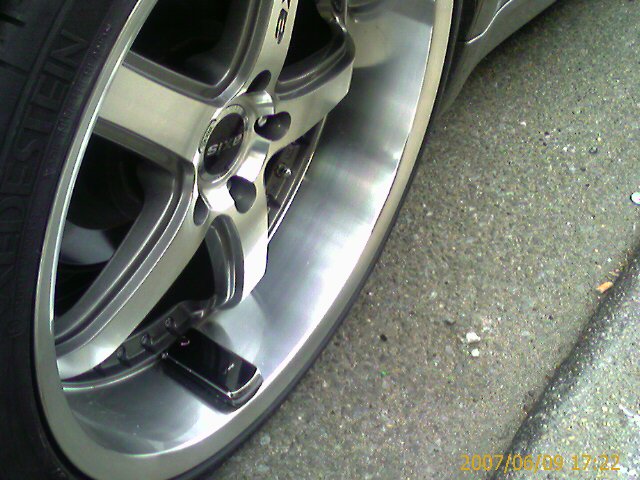

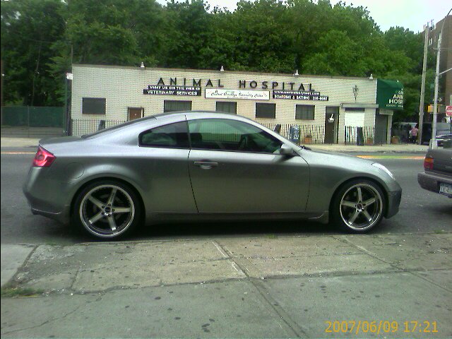

Here are some pics of my shines. My front wheels look a little sticking out because I need to get a alignment they don't rub at all.
I had to raise my car a little due to being too low with my old springs so my alignment is a little out of whack.
Don't worry you won't have any problems.

Heres a question I've had for some time. What do you call the rectangular piece that goes in the front bumper and where can I get one?

You can get it from the dealer, but it's not painted it is just black plastic . I lost mine when I had to get my car towed into a trailer.
I have a new one I just have to get it painted a paint shop won't paint something so small unless you are getting other stuff done to use up the extra paint.
I forgot it's called a tow hook cover.
