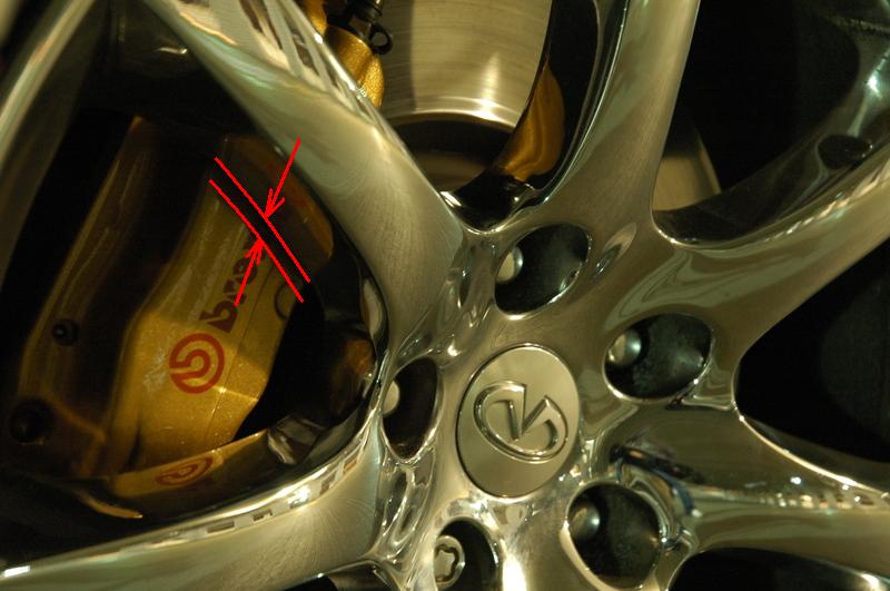

Old Jan 14, 2008 | 05:06 PM
Deezflip's Avatar
Joined: Jan 2007
Posts: 2,001
Likes: 20
From: Baltimore, MD
Originally Posted by Deezflip
+++ super duper 1000,
I'm still trying to find out the exact spacing difference between brembo's and non brembos.
spacing-> distance between the face of the hub from the spokes which is not accounted for when you see offset figures.
For those with the coupe with oem NON-brembo calipers AND with the 7-spoke oem 18s,... i need a really huge favor.
You may need to roll the car a little so that one of the spokes is right in front of the caliper. I need a measurement from the face of the non-brembo caliper to the one of the spokes on the oem, preferable in millimeters.
Any help would be greatly appreciated.
