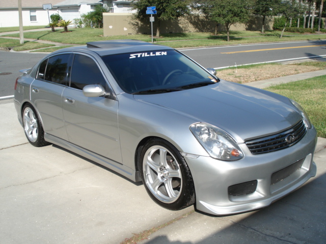

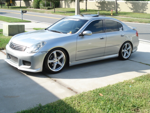

the picture below, that was myold set of wheels, staggered, the fronts are 19x8.5 +44. didn't look too bad, with a 245/40/19.
Attached Thumbnails Proper offset for 19x8.5 with 235/35/19?-dsc00275.jpg   Proper offset for 19x8.5 with 235/35/19?-dsc00277.jpg
