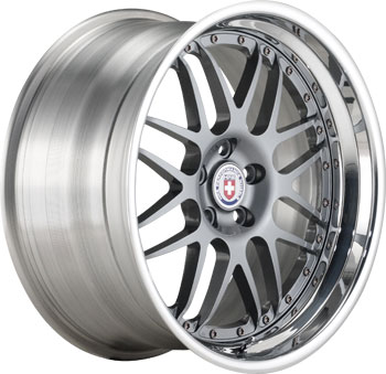

I'm thinking of getting these 19" HRE rims (possibly black finish) on a 06 Red G35 Coupe w/ a Tein Flex Type Kit coilovers, but I don't have any idea for the width size, offset, and tire size that would look good. I just know I want it to be staggered about 2 inches in front, and 2.5 to 3 in rear, and close to fendor. Please help me out.
Attached Thumbnails HRE Wheels, need help on offset size.-hre_c20_anthracite.jpg

Sizes they would probably run is 19x8.5 Front & 19x10 or 10.5 rear, with tire sizes 245/35/19 & 275/35/19 or 285/35/19. HRE probably has the best offsets already for the vehicle.

since its a custom 3pc wheel, im sure you can get any size
i would go for 19x9.5 +10 and 19x 19x11 +10 for tires 245/35 and 275/35
this set up is a tad aggressive but nothing crazy
