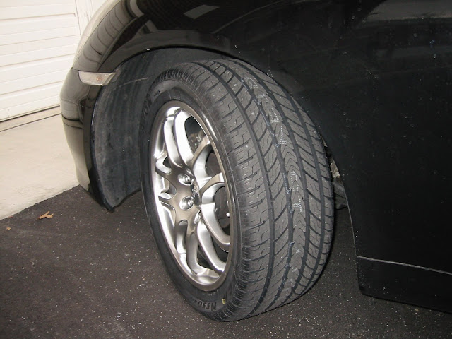

My tires are starting to wear out, and I was planning on buying wider tires. Does anyone have pics of OEM sedan 18" rims with 245/45/R18? I want to see how they look. A closeup and a shot of the car would be nice. Thanks.

These are Enkei wheels that look similar to stock 18's. They are 18 as well. Tires are General ExclaimUHP 245/45/18. No drop and they fill the wheel wells nicely in my opinion.

I just got a new set in this size for my 05 6MT Sedan. There are a lot more tire options in this size than the stock size. Switching to 245/45/18s means your car will be traveling a little faster than the speedometer reads (just a little over 1% as compared to using the stock 235/45/18 tires, or about 1 mph at 60 mph.) As the tires wear, they will get closer to stock size and the amount of error will drop. The 245/45/18s also give you about a quarter inch more tread touching the road.

Here is my sedan w/ Yokohama .
