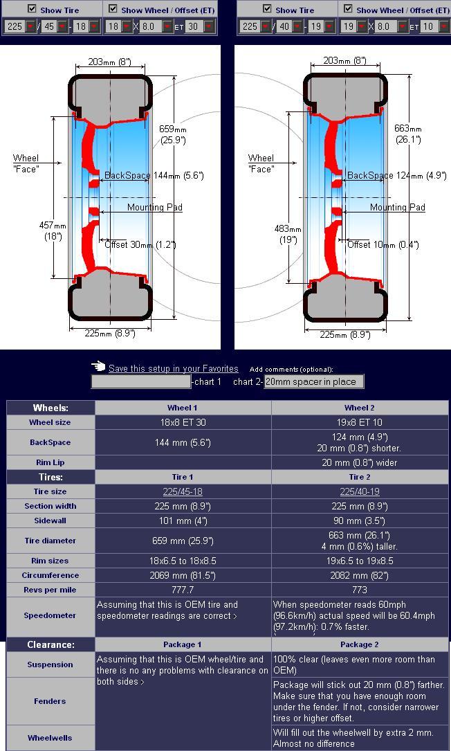

Play with this wheel calculator a bit, if you input all the measurements it should answer most of your questions. People have their different opinions on spacers both good and bad. Here is the link and info.
http://www.wheelsmaster.com/rt_specs.jsp
based on the specs of the 18" OEM rims:
18" wheels
Front & Rear: 18x8 +30mm offset
VS:
19" wheels
Front: 19x8 +30mm offset
Rear: 19x8.5" +33mm offset
I used a setup of 20mm front & 25mm rear spacers with OEM 19" to get a flush look. If you want to get the same look with 18" OEMs you would need:
20mm front and 32mm rear.
Someone please check my math, correct me if I'm wrong.
The first attachement is 18" OEM vs front 19" OEM W/20mm spacer
The second attachment is 18" OEM vs rear 19" OEM w/25mm spacer
