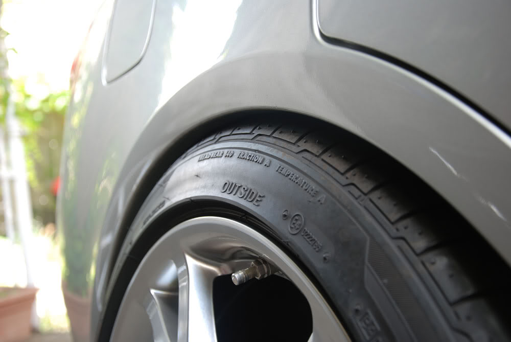

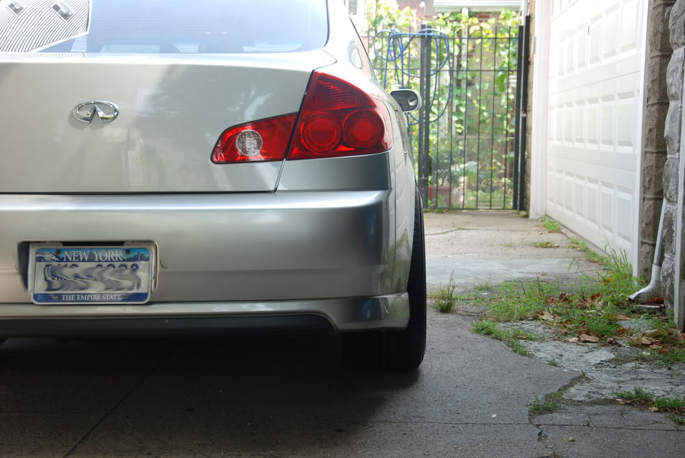

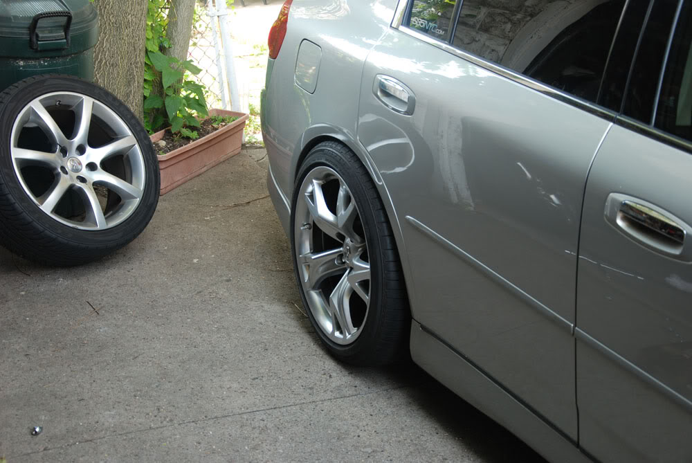

here you go, these were a test fit on my car because i was curious if they will fit.

^ damn looks so sick and aggresive, so do they fit as in you can drive with no problems?
Old Nov 26, 2009 | 11:02 PM
04G35NYC's Avatar
iTrader: (17)
Posts: 4,842
Likes: 78
From: Brooklyn,NY
^ no way, you need some crazy negative camber, roll the fenders and pull fenders maybe then it might work haha
Old Nov 26, 2009 | 11:04 PM
KevcoG35's Avatar
Joined: Jun 2008
Posts: 350
From: Calgary, Alberta
Oh my... That almost looks undriveable. If it is all I can say is daaaaaaaamn!!!
Old Nov 26, 2009 | 11:09 PM
NjMatteSedan's Avatar
Posts: 7,985
Likes: 98
From: Elmwood Park. NJ
^ read previous post, it isn't without modifications. Is crazy that coupes need spacers with this wheels cuz they tuck too much and we're the opposite we need shaving and pulling to make em fit lol.
