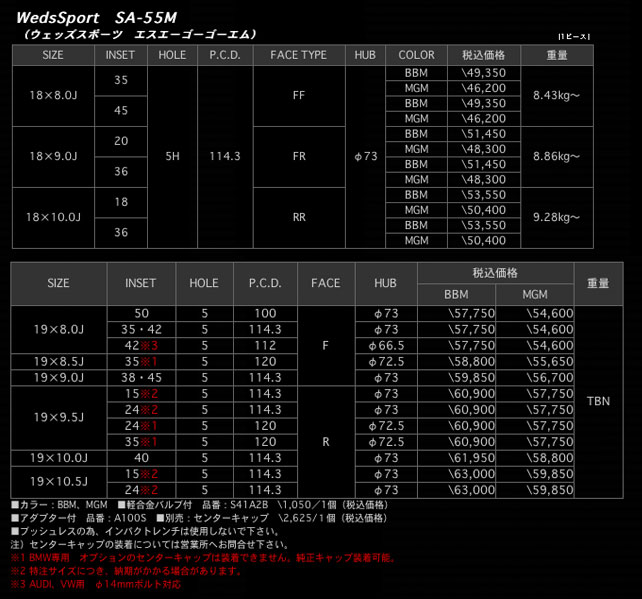

Looking for some help on my next set of shoes. As the title says, i am trying to fit a 19x10.5 +24 as my rear wheel. I do have the camber kits and currently i am not running a lot of camber, very close to factory settings. I currently have a TE-37 19x9.5 +34 with a 285 tire. it does rub and i already have rolled fenders but again running close to factory on camber. The spec sheet is below.
These are a set of Weds Sport SA-55Ms, i know the fronts will fit, 19x9 +38 and clear my BBK, just not sure about the rears' fitment and clearance. The two choices in the rear 19x10 +40 and 10.5 +24. TIA.

Ok, first off, AS series wheels have retarded brake clearance, I don't think you'll have an issue with either set up. I had SA67R and I could fit like 4 fingers between my stock brakes and the closest spokes. I doubt your BBK will get in the way.
Judging by your previous set up, you definitely like meaty tires, therefore the 19x10.5 is out of the question. You won't be able to fit it with out a little camber and some stretched tires. If that's ok then I'll help you some more with getting them to fit.
19x10 +40 will be a flush set up as long as you're not hammered to the ground and running negative camber.
I would actually recommend a spacer up front, probably 10mm to get it a little more flush.

If you're into some poke and some aggressiveness then I would recommend the 9.5 +24 front (or even the +15)
225/35 front 245/35 rear, roll the rears a flat and run like -2.5 or -2. If you want to cut the camber out, pull the fenders a little and you can keep your camber in spec.
If you want to run the 255 run a 235 up front (235/35F and 255/35R) Then pull a little negative camber and do the rest via fender work.

Measure from the hub to the furthest edge of the caliper.
With these wheels though the rear will fit no problem, worst case (front) buy the 9+24 and add a 10mm spacer.
