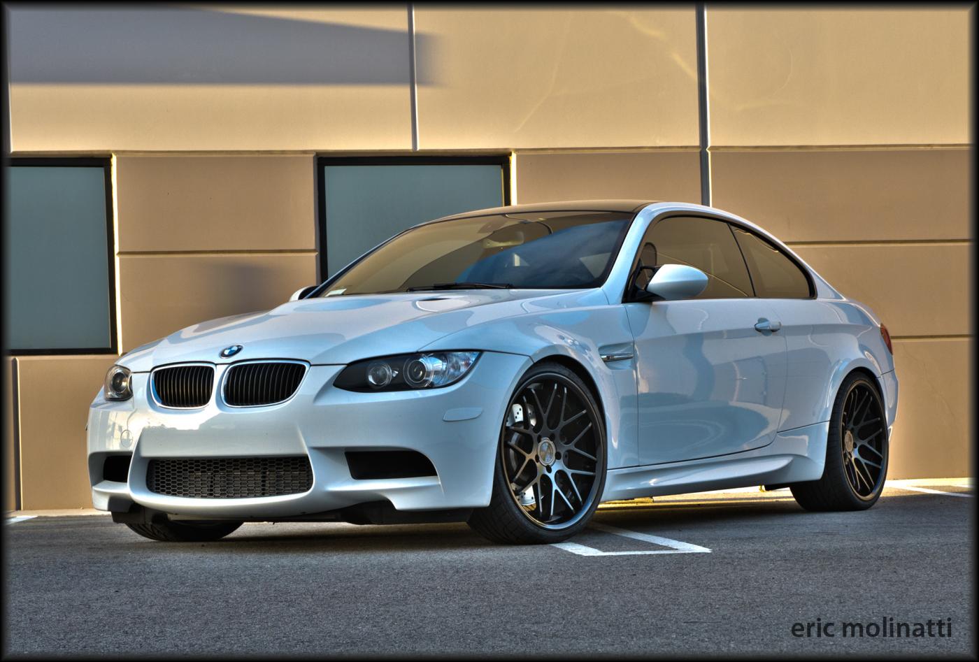

well i havent bought the wheels yet but before i order i would like if i could . they come in 15,20,25,30
Vertini magic
Attached Thumbnails Can you put 20x9.5 or 10 on the front wheels?-zr6x63204703.jpg   Can you put 20x9.5 or 10 on the front wheels?-e92m3_vertini_magic.jpg

So question how is it that some of these guys have really aggressive fitments with no problems?
Is it more so the offset? Or the actual Rim?
the reason why i say is cause i say a guy on one of the other forums with xxr 20x10.5 all around and with 23mm spacers and he rolled his finders to have no rub
but i get what your saying about the thrust rod
I just want that concave look up front just like the back
